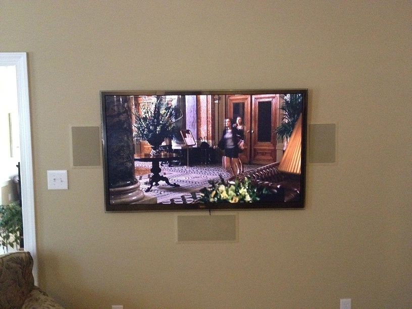

Due to this dire situation, I took a few minutes to google for you. :slight_smile:
Seems like these guys do antenna installs on top of AV stuff. They’re in Wake Forest but they may be willing to come your way…
A lot of times custom A/V installers are adding antenna mounting to their list of services so it’s worth googling for that too.
