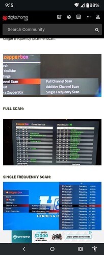

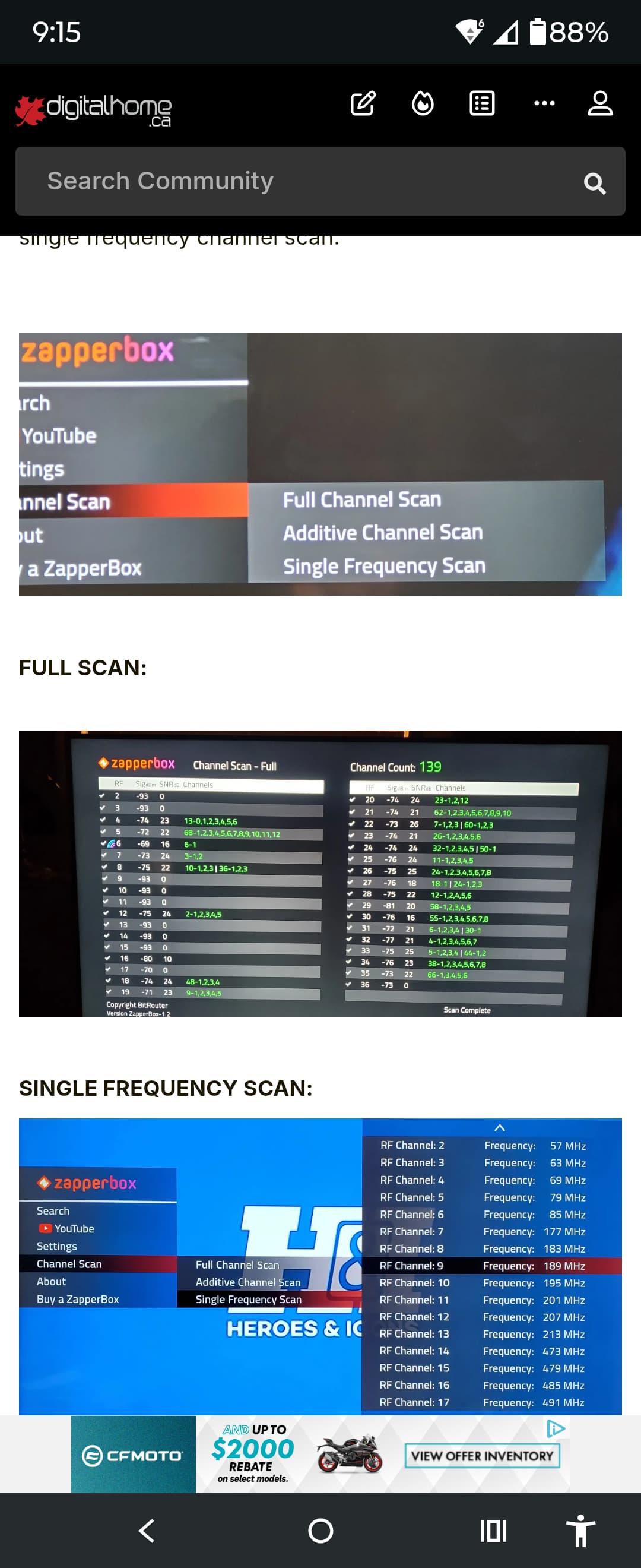

My old Channel Master DVR+ and Stream+ both permit a manual add/scan of a single channel. So do other vendors.
Please detail those other vendors please.
No. People need to do their own research.
Indeed. Yes, yes, they do.
Zapperbox
Well, looks like you have plenty of options for your DVR needs. (?)
Really?

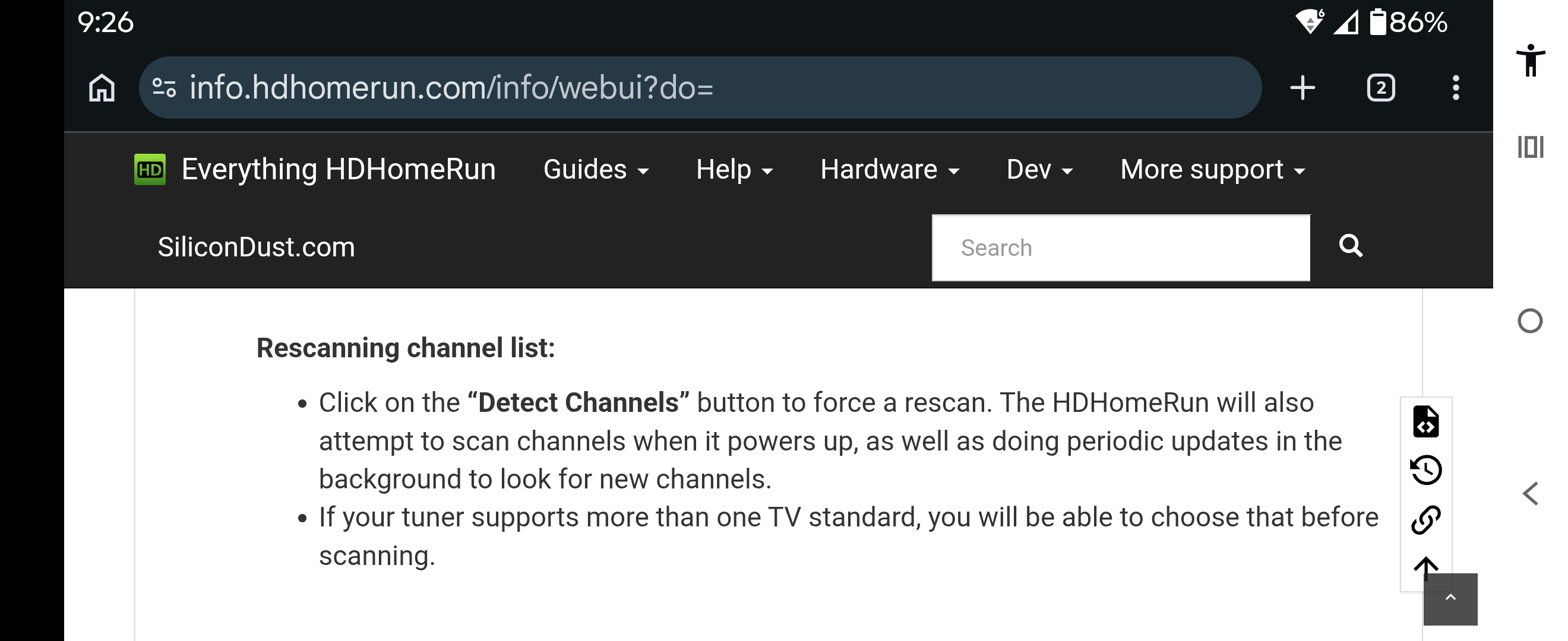

HDHomeRun
