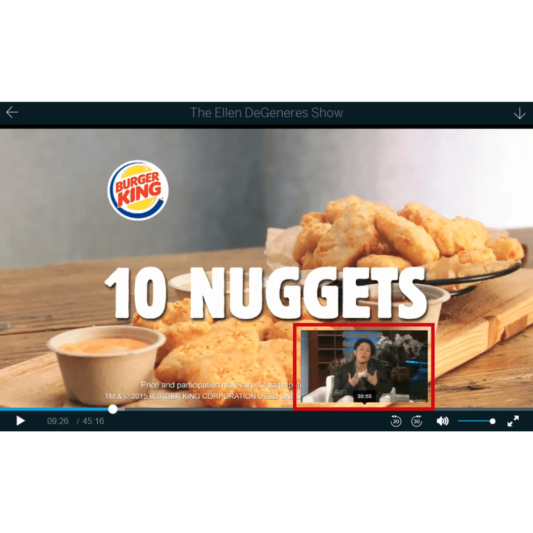

djk44883, thank you for posting these articles. As a new Tablo Quad streaming DVR owner of 2 weeks now, I was wondering exactly how the thumbnail process works.
If I want to see thumbnails on a recording, I need to wait at least 2 minutes for a half hour show or 4 minutes for an hour show assuming a tuner is available, which should be the case for me most of the time. I have learned to use the left and right arrows to move around in live tv and move forward or backward in specific time increments.
One trick I use if I started watching a show and there are no thumbnails is that I keep watching it to the commercial break. Then I stop playing it and resume it. Usually the thumbnails will have been processed by then. They won’t show up however without stopping the program and resuming it.
