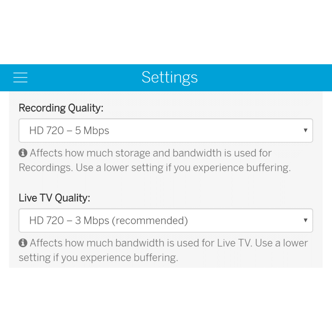

The one think I noticed having both tablo and recast is recast pic quality was noticeable lower quality
https://www.amazon.com/gp/help/customer/display.html?nodeId=G2HBR6YWBHRD799N#GUID-F2D7CD1E-69A4-4667-BA05-9CE5FB91C699__GUID-D70A3C35-1785-4CBF-A21E-129A1A587987
What output resolution does Fire TV Recast support?
Fire TV Recast is capable of receiving all ATSC broadcast resolutions, including 1080i and 720p. When streaming to other devices, Fire TV Recast transcodes 1080i streams to a resolution up to 1440x720p using H.264. This is to ensure that all Fire TV streaming media players work with Fire TV Recast, and to deliver more reliable video streams over Wi-Fi.
While tablo is basically limited to the broadcast’s quality (I doubt it “up-scales”)

Edit: So the recast only does 720p? Having a 4k LG OLED 720p is insulting. The Tablo at least has 1080p on channels that have it. Then again ATSC 3.0 is going to change everything once it ever comes out.
