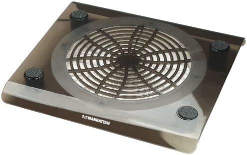

lol, well, mine has been pretty good. Only big issue I had is heat even though they say it should be fine I have to have mine on its side or else
My last one croaked and I remember noticing how hot it was. Not sure though if it was the cause or a result but it was hotter than I had ever noticed. The new one operates at about the same “normal warmness” as the first but I’ve noticed right below the LED the heat is too much to even hold my finger to it…so I don’t lol.
It’s a few buck more now, but people concerned over heat buildup in the tablo should just order one of these. Might be cheaper elsewhere, but mine has work fine ever since I’ve owned my tablo.
