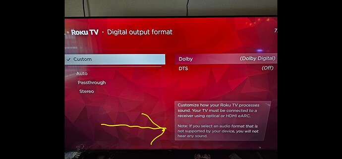

Try this…In the settings for the Roku device, go to Audio → Digital Output Format → Custom, then make sure Dolby Digital is selected for the Dolby section. Can leave DTS off. Then go back to the Tablo app and try again.

Customize how your Roku TV processes
sound. Your TV must be connected to a
receiver using optical or HDMI eARC.
Note: If you select an audio format that is not supported by your device, you will not hear any sound.

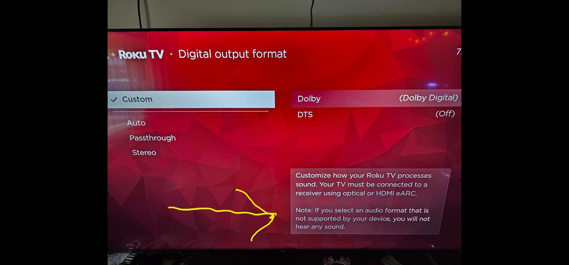

for the record, I got ack live and library recordings with audio after setting ROKU audio to CUSTOM, formerly STEREO. I think.
Equipment Samsung basic 2024 tv (UN60DU7200F), audio out via eARC HDMI 3 to cheap VISIO soundbar (SB 3651)
