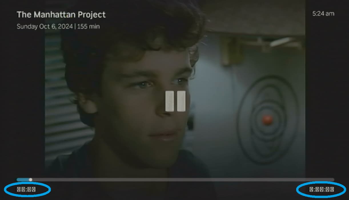

Yeah, mine is also a Roku Express 4K+. Note: Here’s what someone posted in my 1,439-member TabloTV 4th Gen Facebook group: “In the settings for the Roku device, go to Audio → Digital Output Format → Custom, then make sure Dolby Digital is selected for the Dolby section. Can leave DTS off. Then go back to the Tablo app and try again.”
I tried that, and it did successfully get playback to work, but now the sound is gone. Notice also that the timecodes (lower left and right) have all digits X’d out. (see pic)
Fortunately, even with missing sound from the Tablo app on Roku Express 4K+ with these settings, that same Roku has no trouble playing back sound on my AirTV Anywhere using the Sling app.
