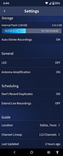

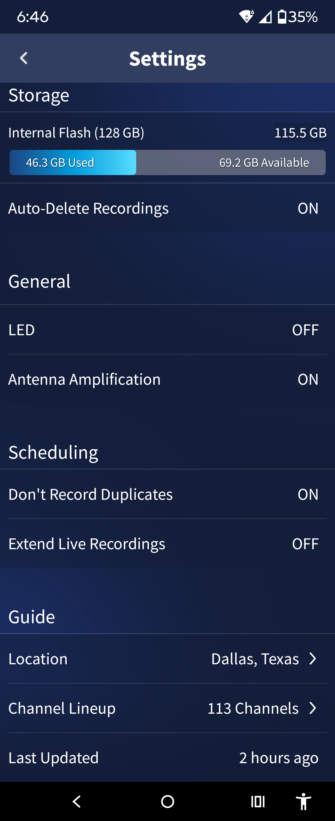

I live in the Portland Oregon area. On my legacy Tablo, I have 15 channels selected and a guide update took 46 seconds. My 4gen Tablo has 29 channels selected and a guide update took 1 minute 4 seconds. Channel scan on Legacy picked up 79 channels in 1 min 12 secs and on 4gen it was 207 channels in 1 min 23 secs
Both is my guess. I removed all but 1 channel and did a rescan. Took over an hour.
I then put back the 113 channels in the Channel Lineup and did a rescan. The first stage update finished in a couple of minutes. I’m waiting for it to do the secondary thing.
So who knows? It’s nothing we have control over.
It would appear that they are working on the servers because they are running faster and the errors are clearing.

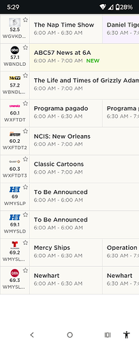

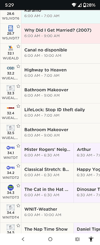

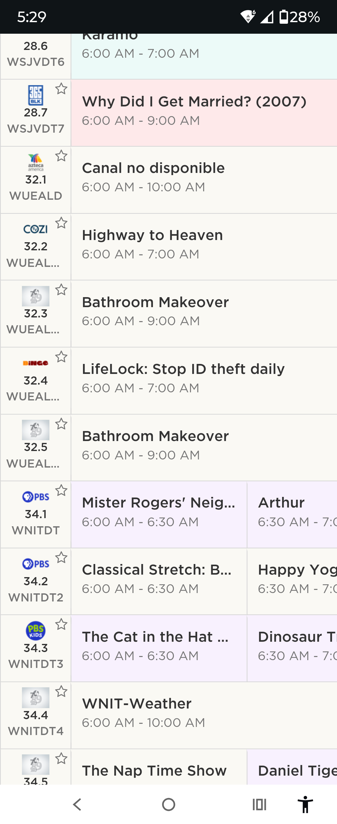

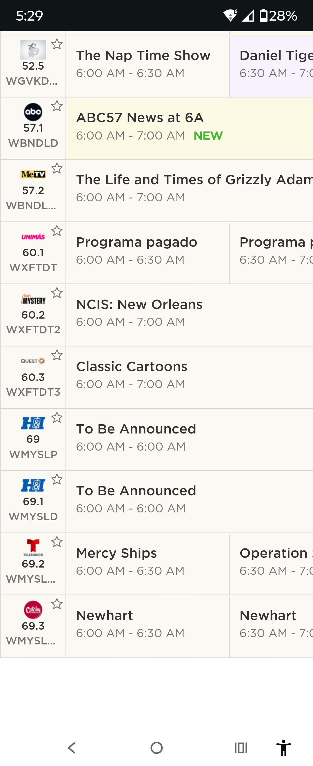

How about guide corrections? Is there still no way to correct wrong or no guide info?
@lowman what is your zip code? What is the channel that is in error?
46614
28.7 THE NEST- Guide has info for some other channel
57.3 MOVIES - Guide has info for some other channel
69.1 HEROES & ICONS - Guide shows “To Be Announced”

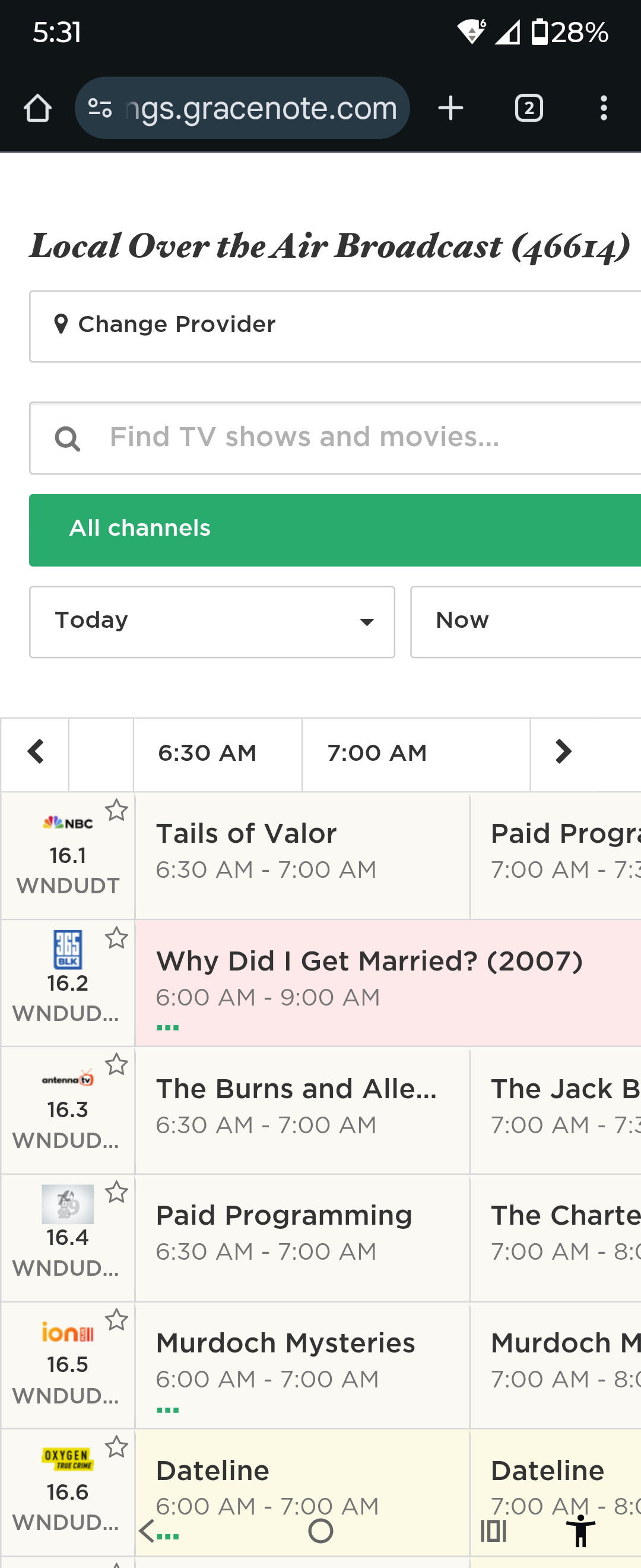

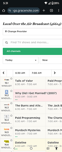

I see those are wrong/missing. I pulled up the Gracenote listing.
The information in Gracenote is provided by the station owner/operator. It’s their responsibility to insure the data is correct and to regularly maintain the changes. Not all stations subscribe to the service.
When there’s an error typically contacting the station is the solution. I’m guessing that Tablo was gathering the updates to forward to Gracenote or the station as a courtesy.
Tablo cannot force the changes to be made.
https://tvlistings.gracenote.com/grid-affiliates.html?aid=cha
This was a response from one of the stations after I reported it to them. I also have a TIVO and the guide is corrected shortly after reporting inaccuracies to them. They probably use Titan TV guide data. A DVR is only as good as the guide info and it’s looking like Tablo doesn’t have a system to promptly correct guide issues.
“We told Gracenote weeks ago and several reminders since. Since Gracenote outsourced all of their services overseas, they’ve gone from bad to worse.”
