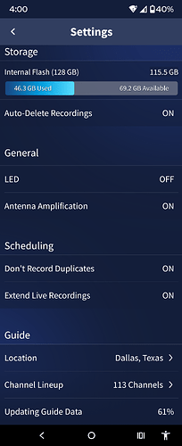

ETA 3pm… 4pm… 5pm… 6pm
52% at 3:20pm
61% at 4:00pm

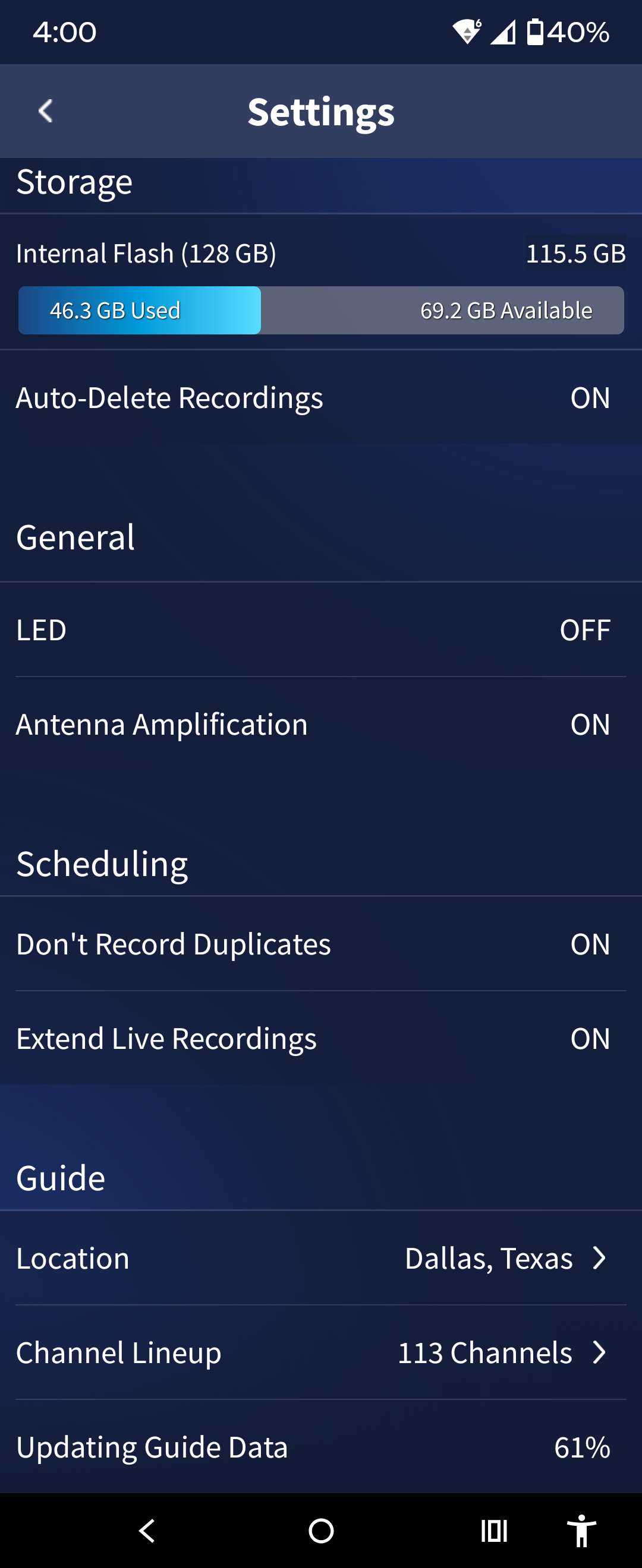

66% at 4:30pm

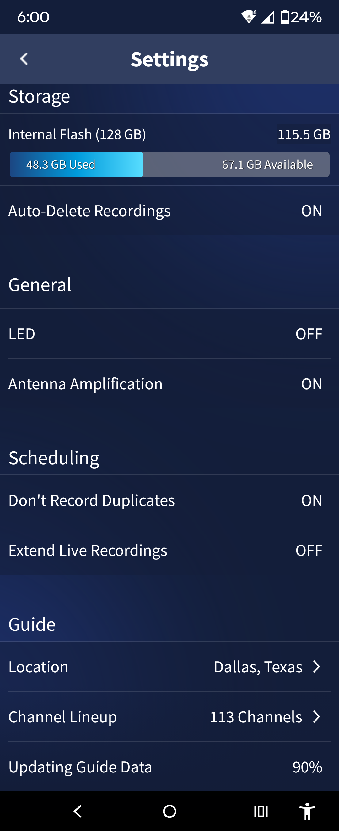

72% at 5:00pm
79% at 5:30pm
90% at 6:00pm
Woohoo! Completed at 6:09pm

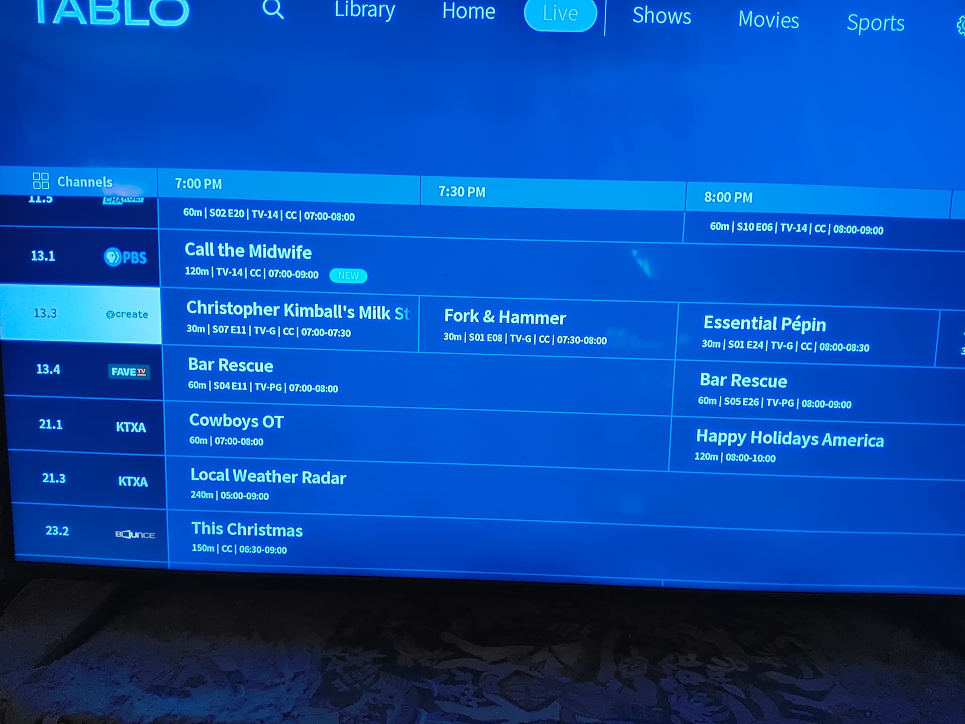

The most annoying thing about any of this is that the rescan introduced an error in the Channel Lineup. I have to correct that and do another rescan.
I think that was part of the last upgrade to speed up by not doing it if it’s current/no I think that was part of the last upgrade to speed up by not doing it if it’s current/no changes
Obviously for me there were both FAST channel changes and guide updates. neither completed.

We’ve been watching the Cowboys play like they’ve got no chance of advancing, which is when they seem to win. Maybe if they went through their season thinking they CAN’T win. Hmmm…

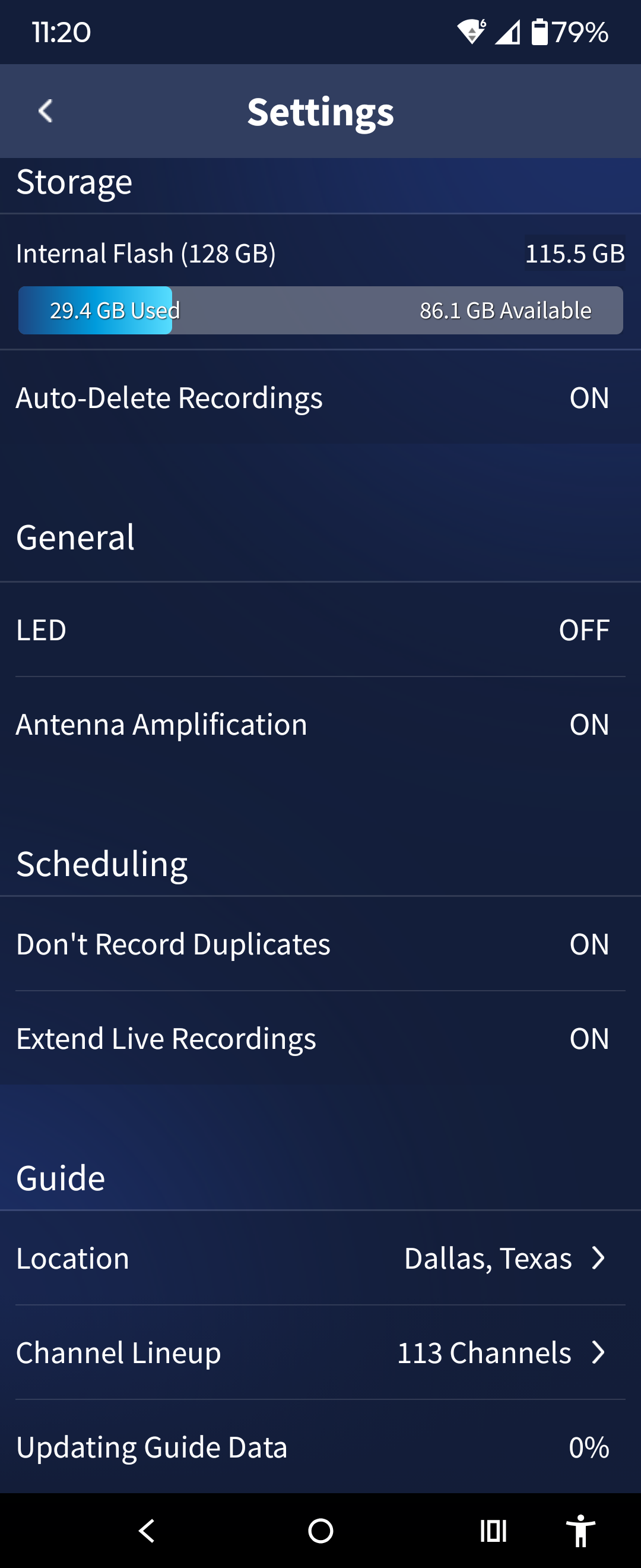

I’m into the 8th hour of a guide update. After the overnight finished (7.5 hours), I initiated a rescan.
All rescans have a two part guide update. The first finished at 11:20am (1 hour).

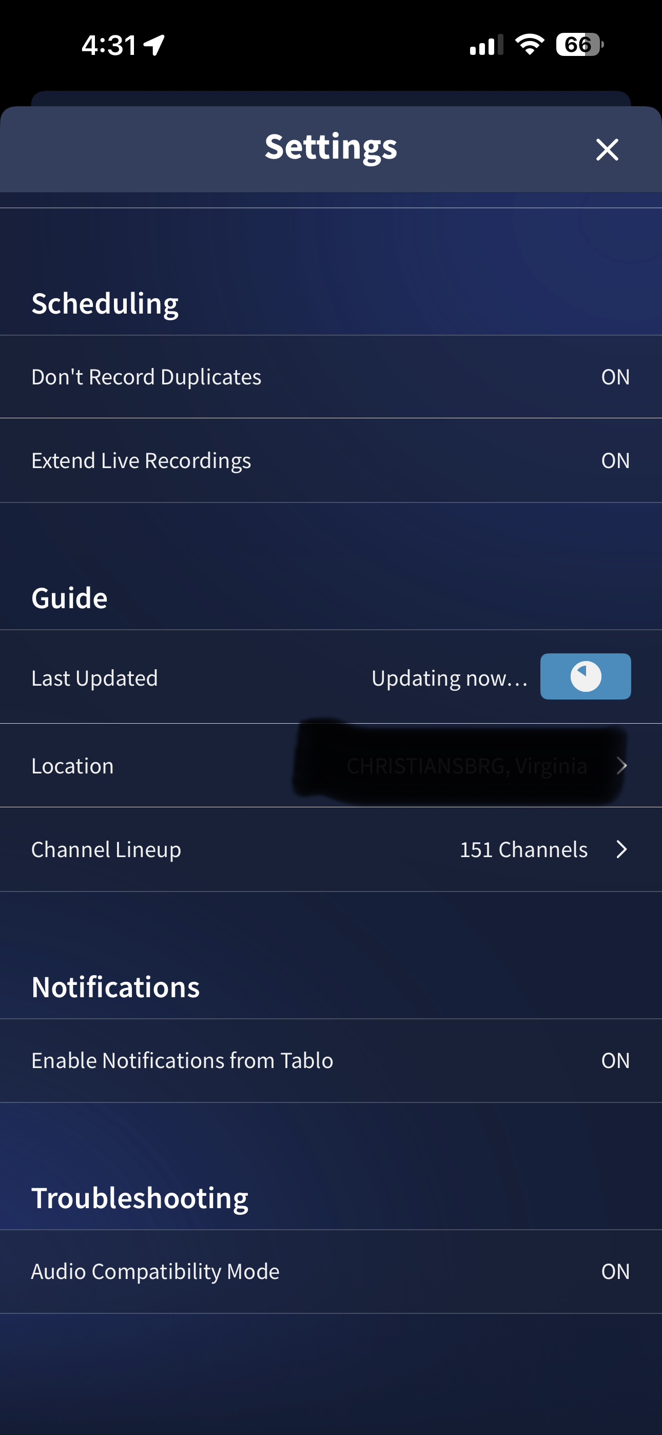

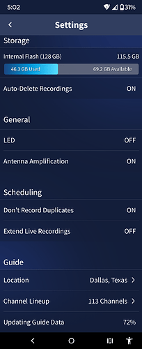

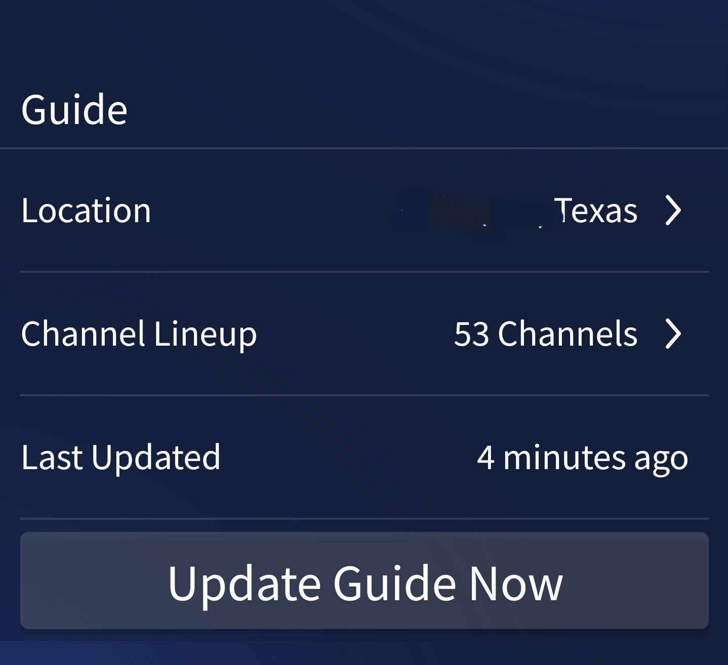

I just opened up the settings and this is what it showed. I didnt touch anything.
I did do a rescan and i did hit the update button in my post from this morning.
Hitting update is superfluous. It’s going to schedule an update anyway.
The status you saw was already there prior to pressing update. Remember it popping?
The scheduled update hadn’t started at that time.

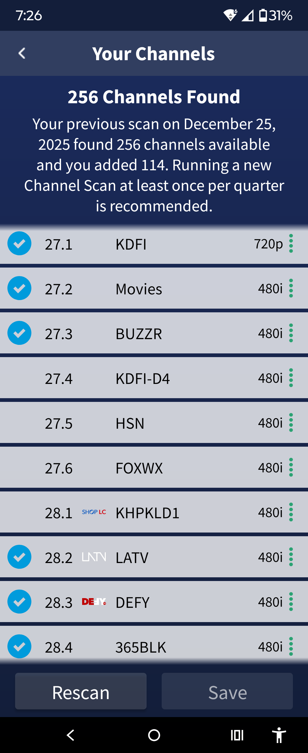

So today a Channel Rescan took only 8 hours to complete.
Best of luck in the New Year!

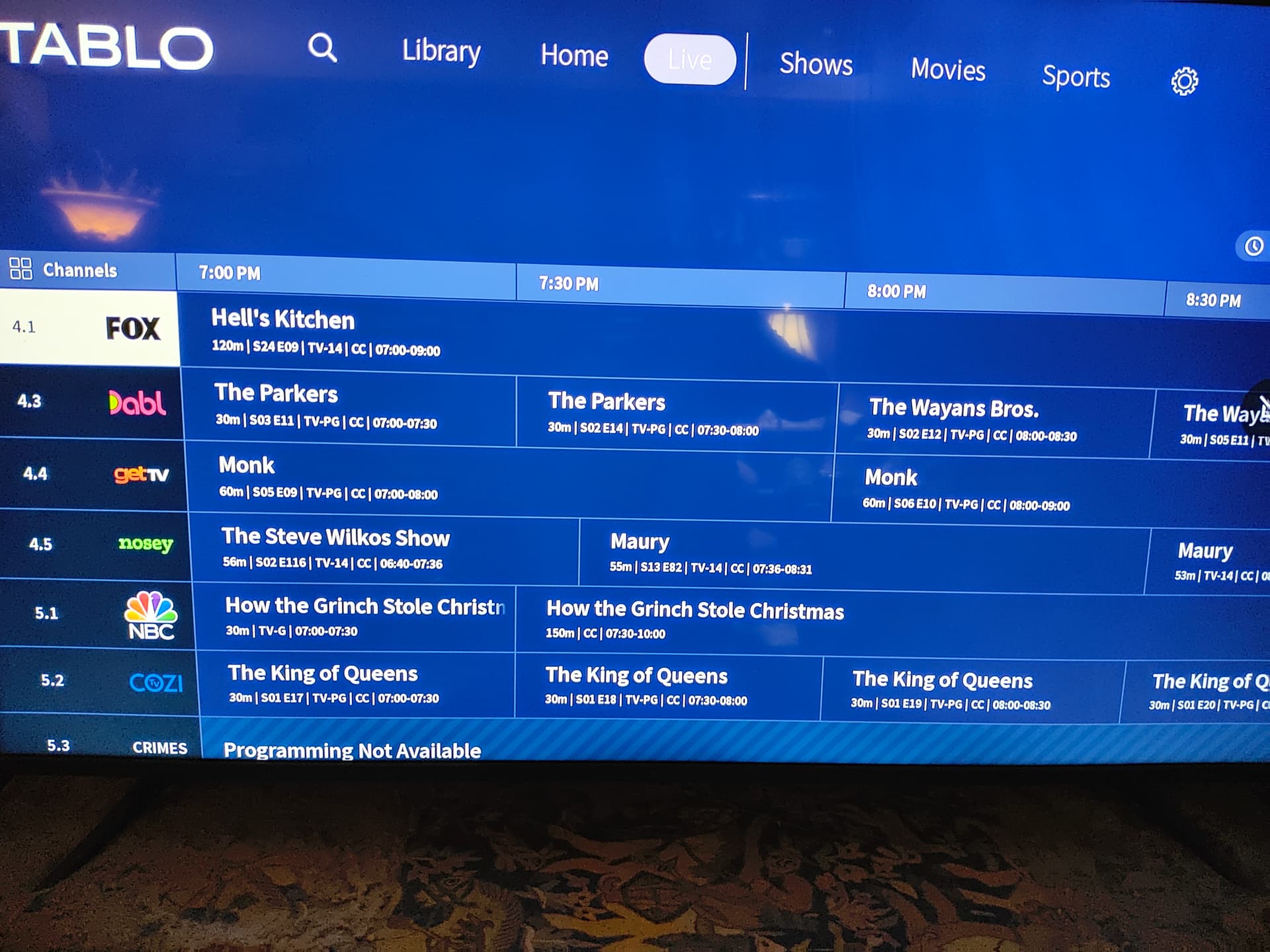

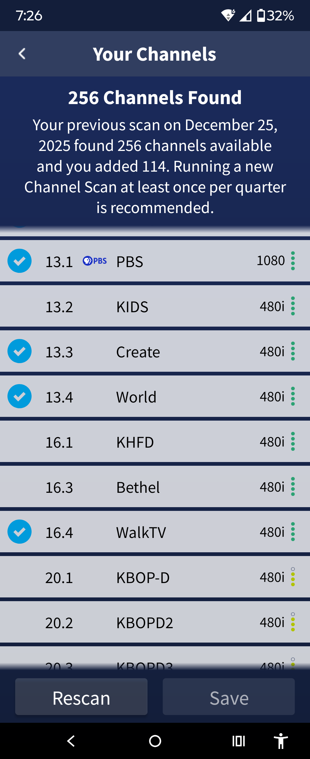

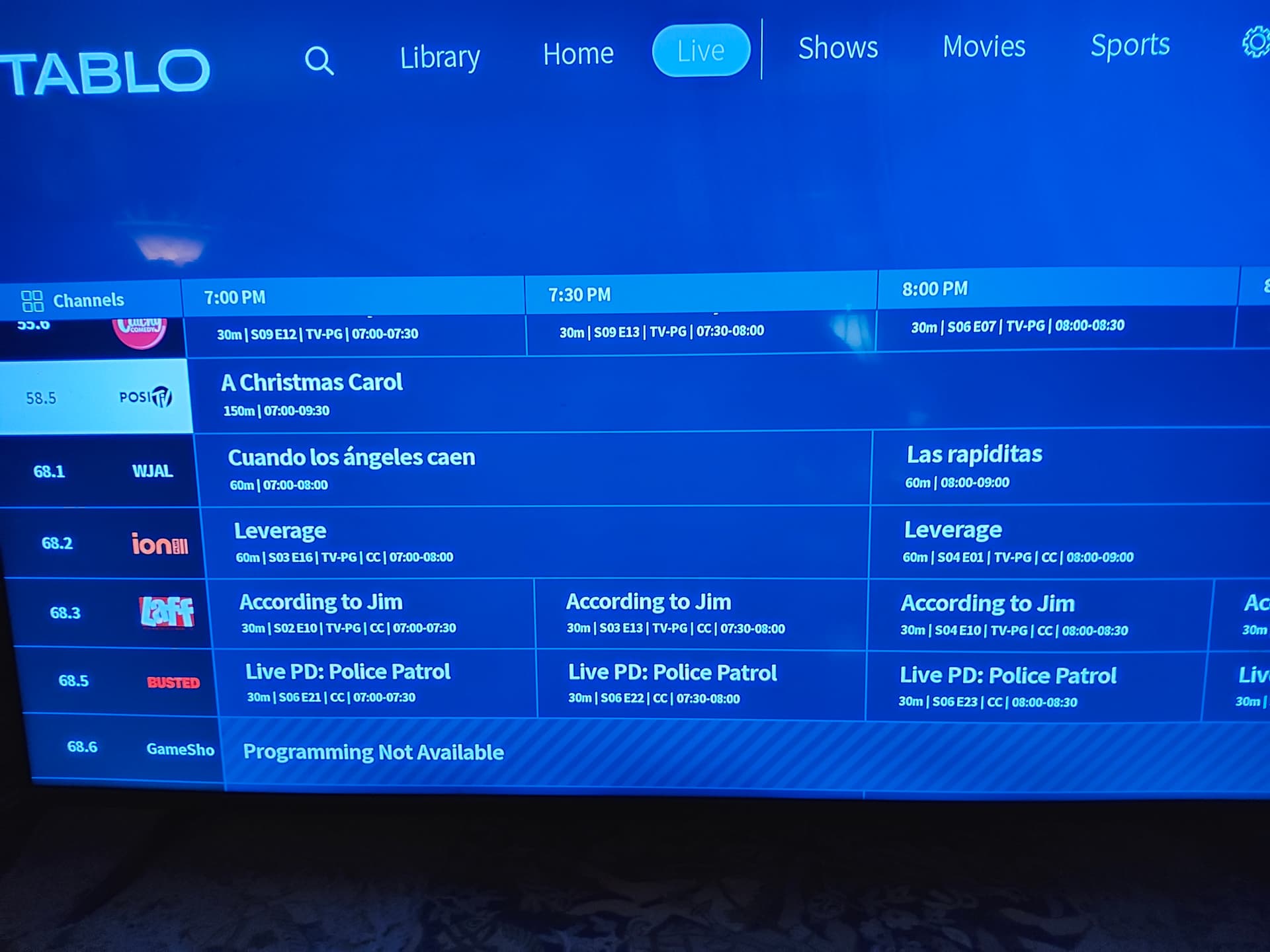

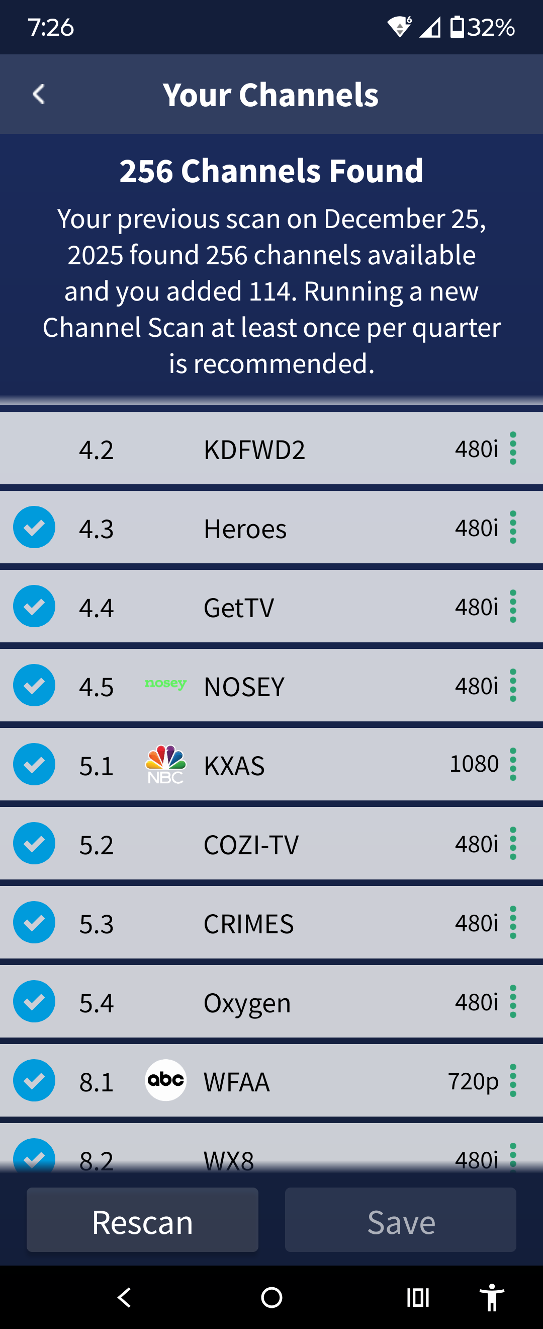

More bad news…

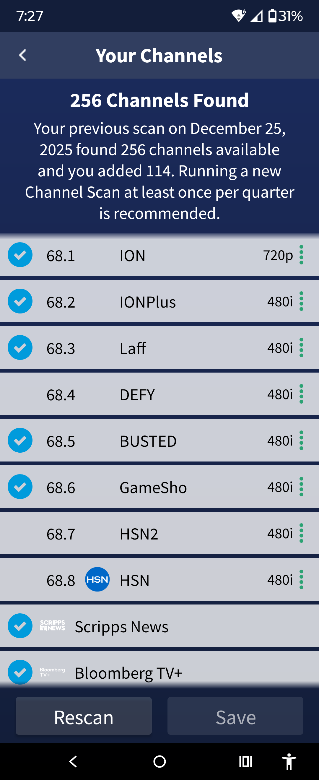

4.3 is H&I
13.4 is PBS World
27.3 is Buzzr

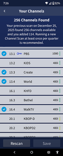

68.1 is ION (WJAL is in Los Angeles)
The Channel Lineup is correct.

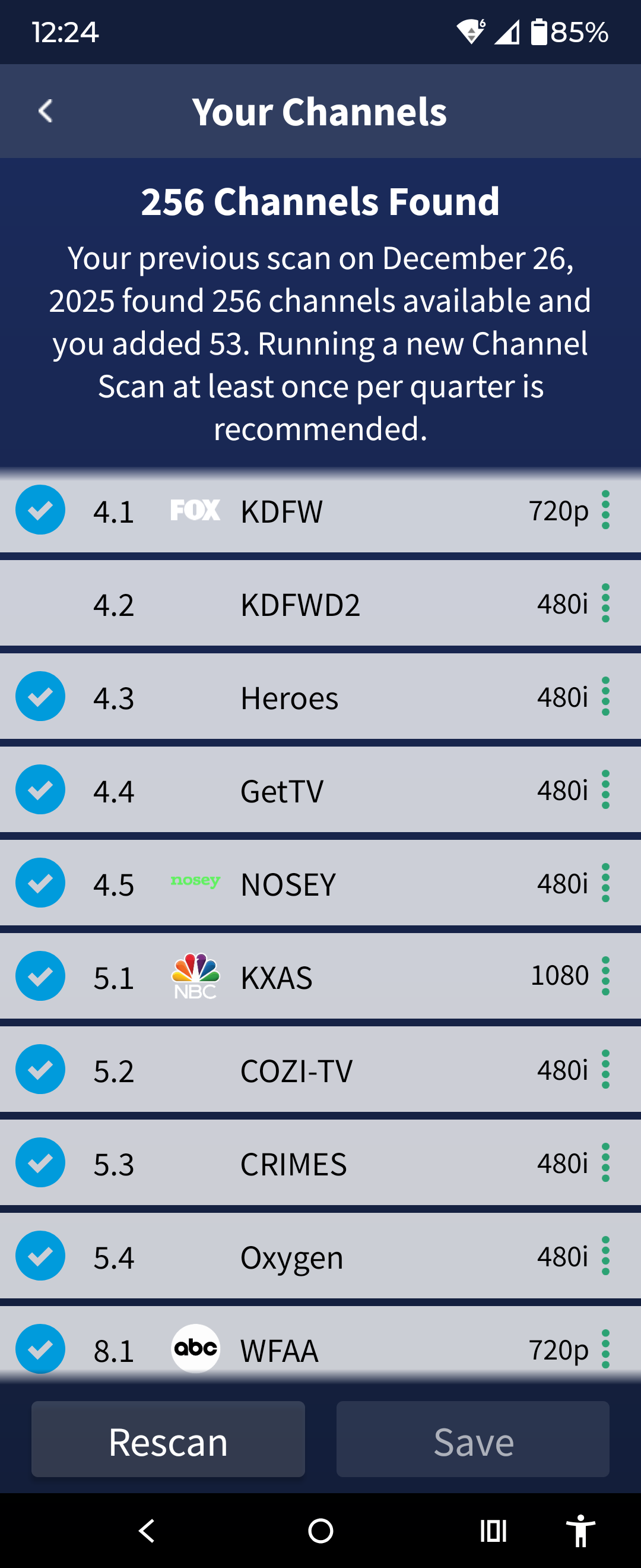

At 4:30am December 26, 2025 the Overnight Guide Update was 18% complete.
It finally finished at 8:40am.
The guide is still corrupted with incorrect information.

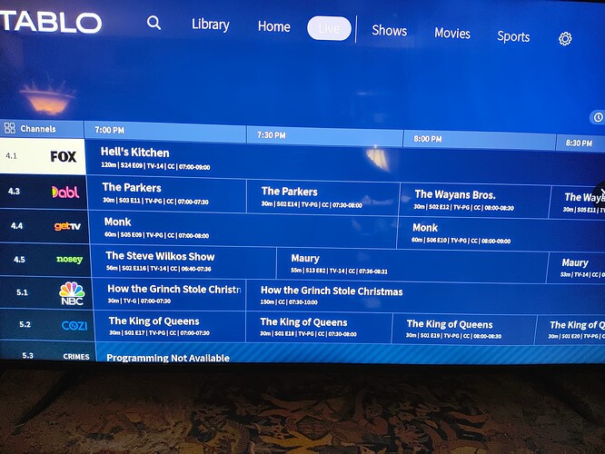

I’m having the same issue. CBS was acting wonky so I tried moving my antenna. No change so I attempted to perform a reset but it completely wiped my Tablo unit and had to set it up as if brand new. Lost all of my scheduled recordings. I tried to search for the shows to schedule but none found. Went to the live guide and when I found one, tried to schedule the recording but it displayed an error. Went to download the guide but no change. Now scanning channels on my Fire TV app and it is stuck near the end of a channel scan.

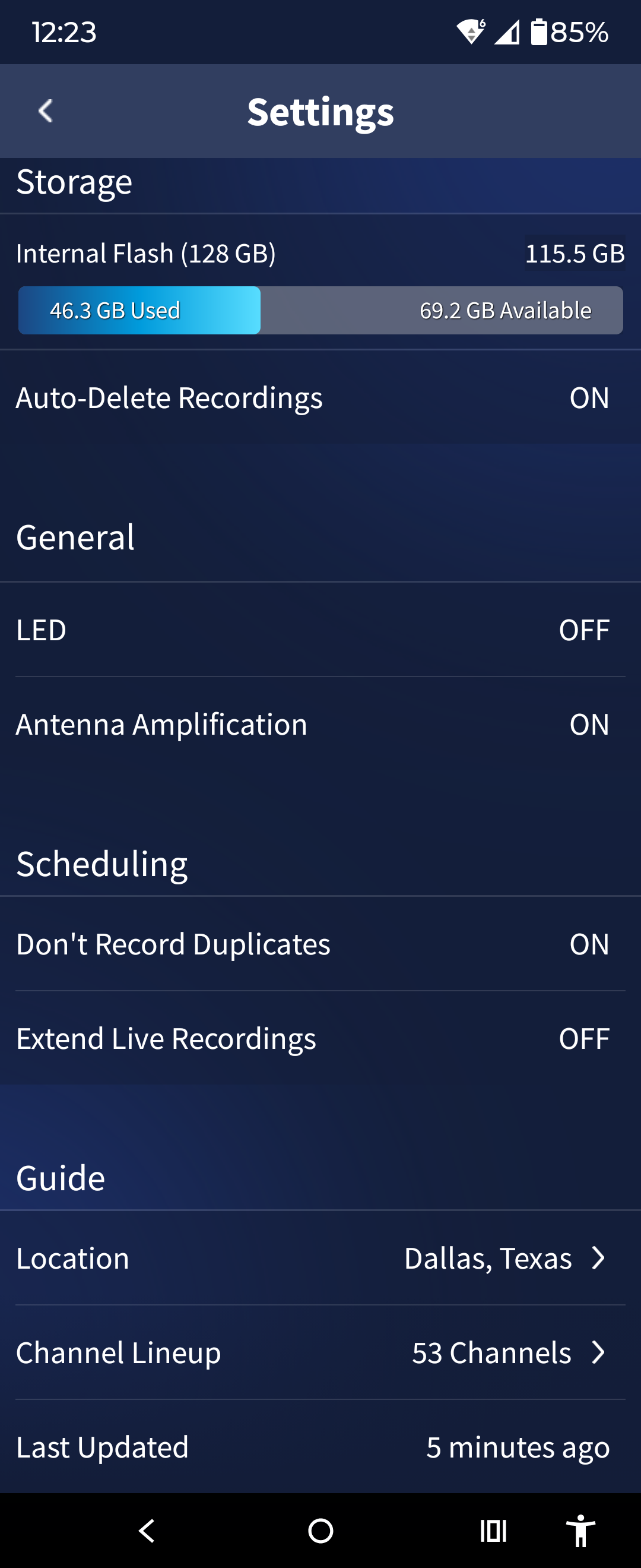

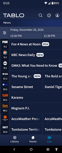

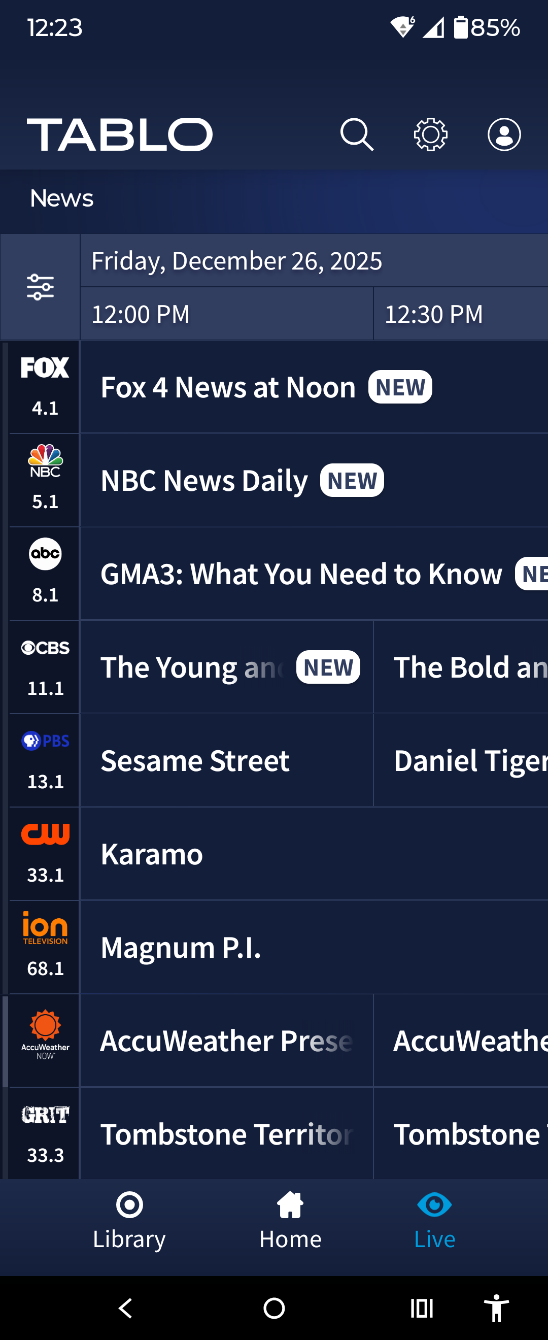

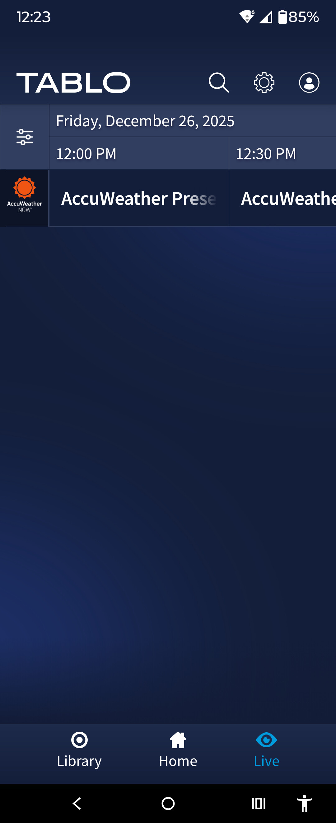

The servers are way out of sync. Android mobile (1 channel) vs LGTV (53 channels).
Android is displaying Channels Guide view.
So for Category Guide view it shows almost no stations and they’re all ‘News’.
In Channels view it displays only one channel.
Channel Lineup displays 53 channels.
Added channels back and rescanned. LGTV has correct channel labels and guide content. Error when attempting to play/view any channel. Android mobile and Fire Stick 4k G2 still are corrupted.
Delete and reinstall the LGTV app and it’s working again.
Delete and reinstall the Android mobile app and it’s working again.
