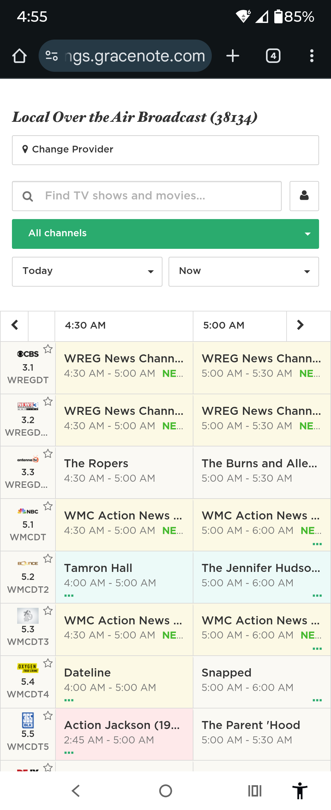

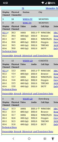

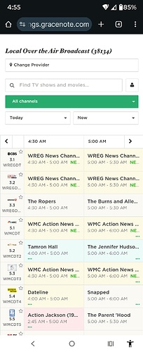

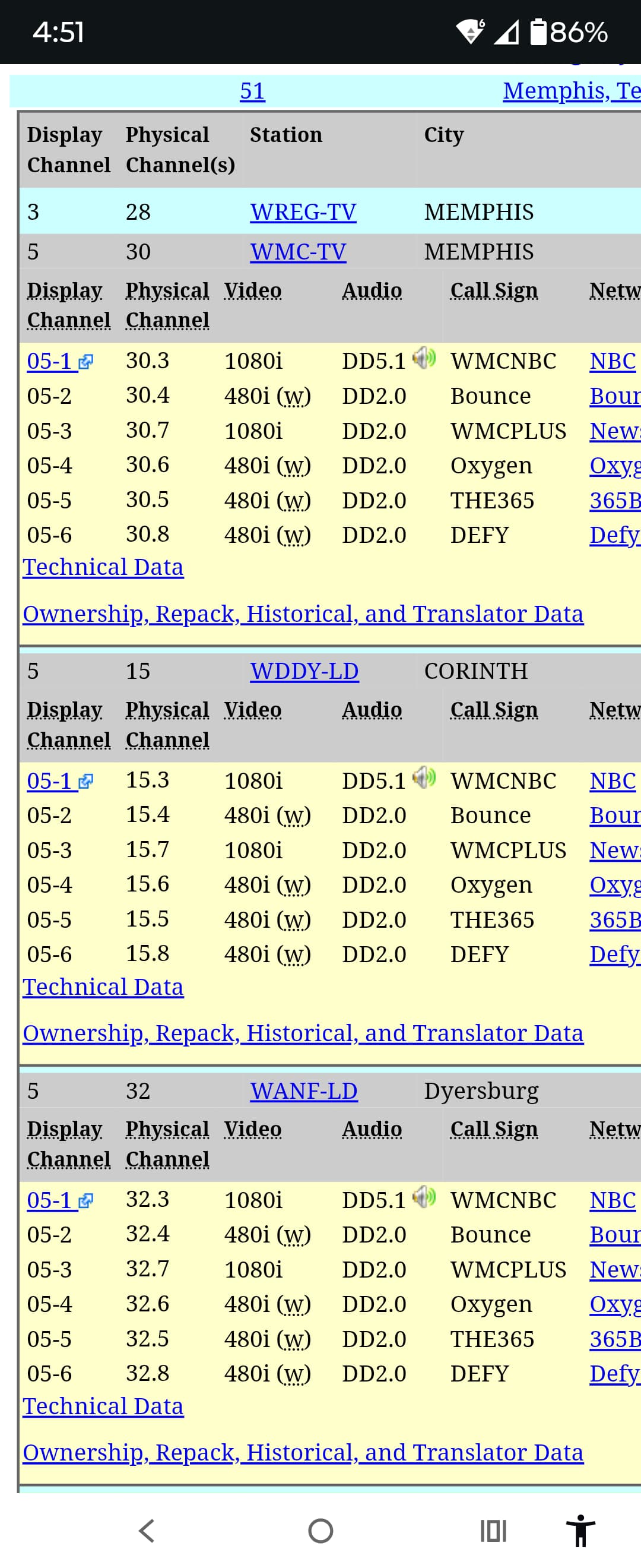

Honestly I don’t know how it works with 3 NBC stations broadcasting on 3 different RFs with the same display channel (5.1). Perhaps the station was doing maintenance?
It looks like RF30 is their full power primary signal and the other two are low power repeaters. These would have to be kept “in-phase” - I don’t recall the correct term.
