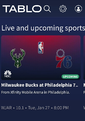

Folks in Memphis, scroll down the Tablo home page to the Live and Upcoming Sports section. Find an upcoming event on NBC and click on it. Then click on Watch WMC live now. That will confirm that your antenna is receiving 5.1 just fine.
For what it’s worth, I tried news/shows/sports and never did 5.1/NBC show up.
I’m very new to all of this, but @Ron1 mentioned going to the “Home Screen” and looking for “Live and Upcoming Sports”, which may be different from what you see for the categories on the left. But, I do not have any problem watching any stations, so I’m just guessing it might be different.
