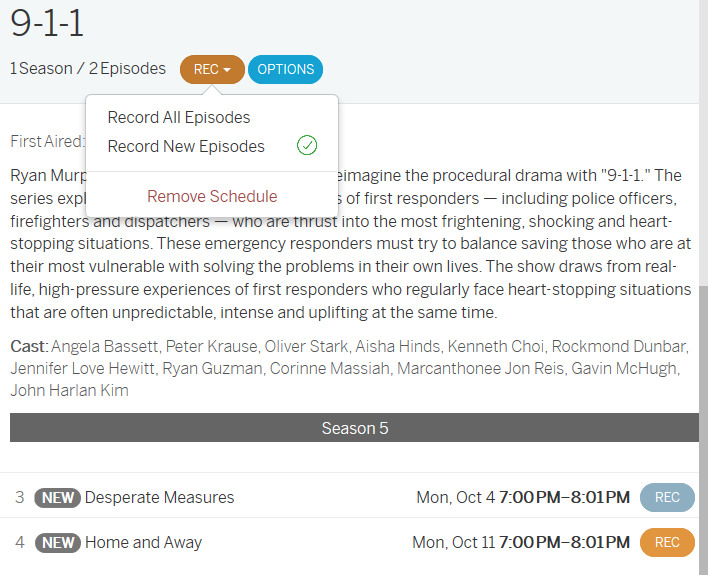

Hello,
So far the Tablo has NOT recorded 2 shows that should of been recorded.
Example, was 9-1-1 on Monday, it showed it was New and didn’t record it.
Last time this happened was for AGT and didn’t record that as well.
Why does this happen and how can I fix it going forward?
Now that you mention it, it doesn’t look like 9-1-1 recorded for me yesterday either. In fact, even though I have it set to Record New Episodes, it doesn’t show next week scheduled to record even though it’s a new episode but it does show the week after that as scheduled…
Could this be a guide error @TabloTV? I ask because 9-1-1 recorded as scheduled last week so something has changed since last week.

It looks as though both are marked as new so that is quite odd.
Worth touching base with support directly so they can take a closer look:
