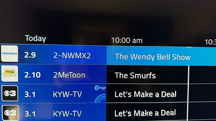

Its on channel 2.10 in the Phila area and its working.

METV Toons showed up on my guide a few days ago, IOW about a month after the OTA rollout was announced by MeTV toons to begin. And abt 10-14 days after the channel started broadcasting OTA in my area.
