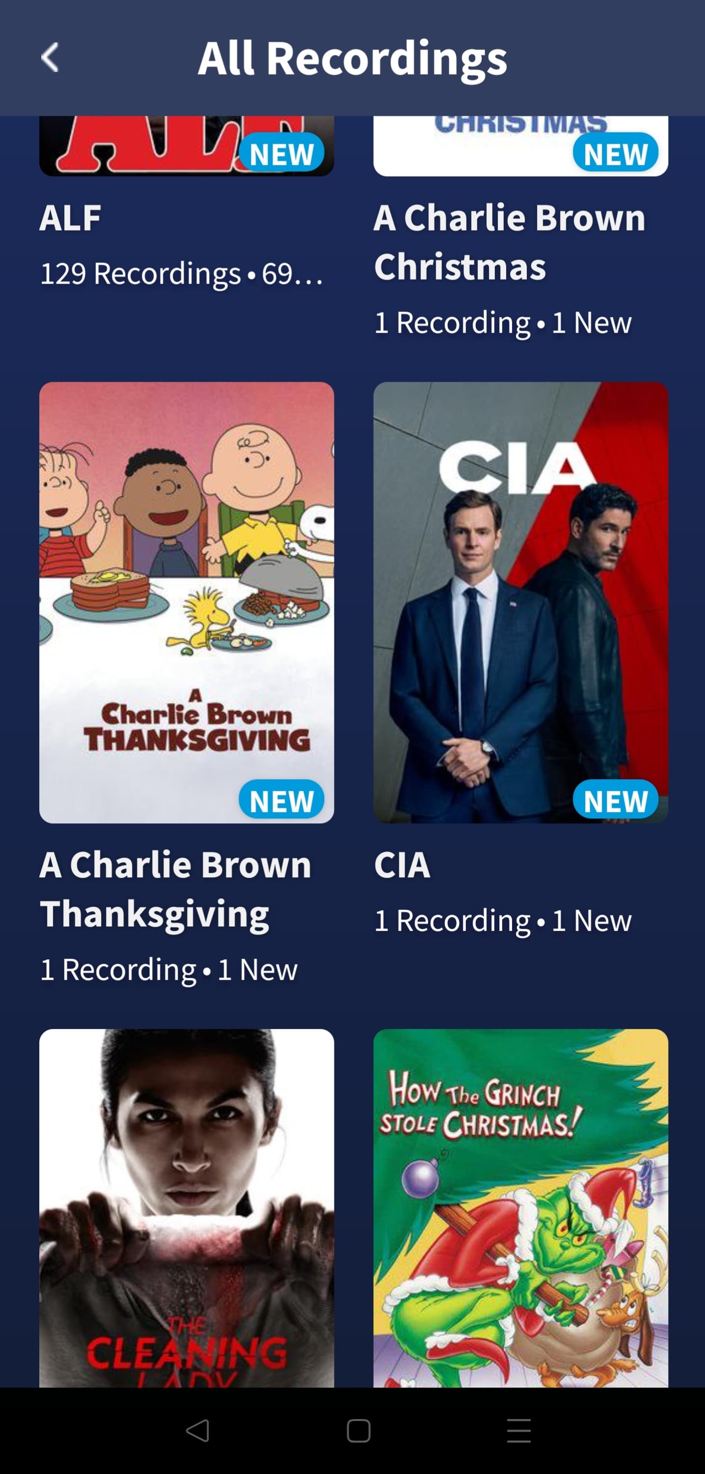

Android phone app displays properly.

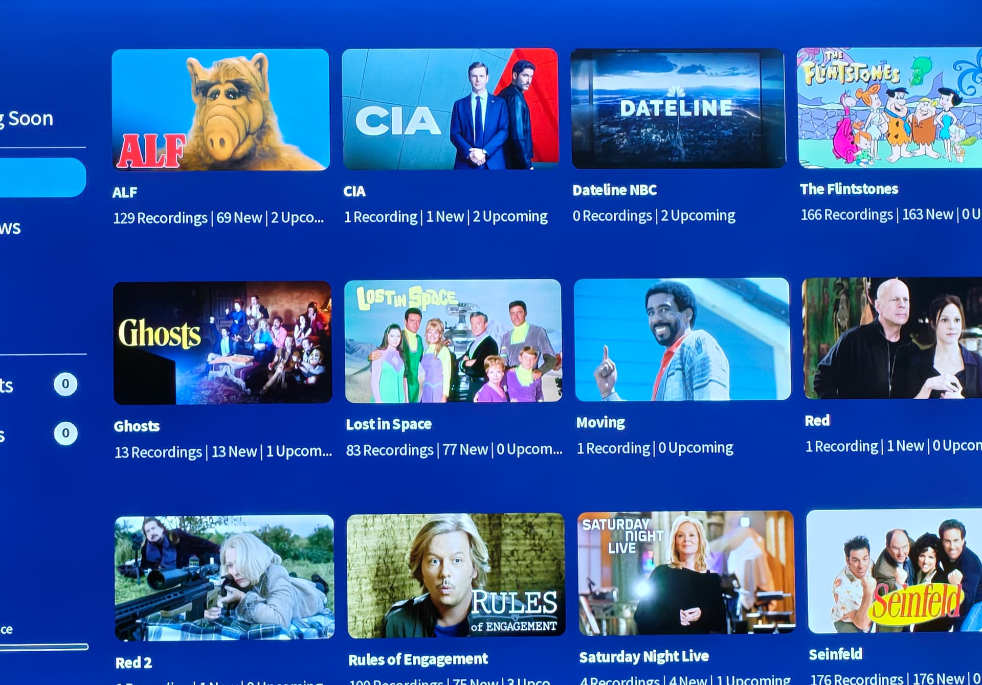

Roku TV and Roku 4K - no.

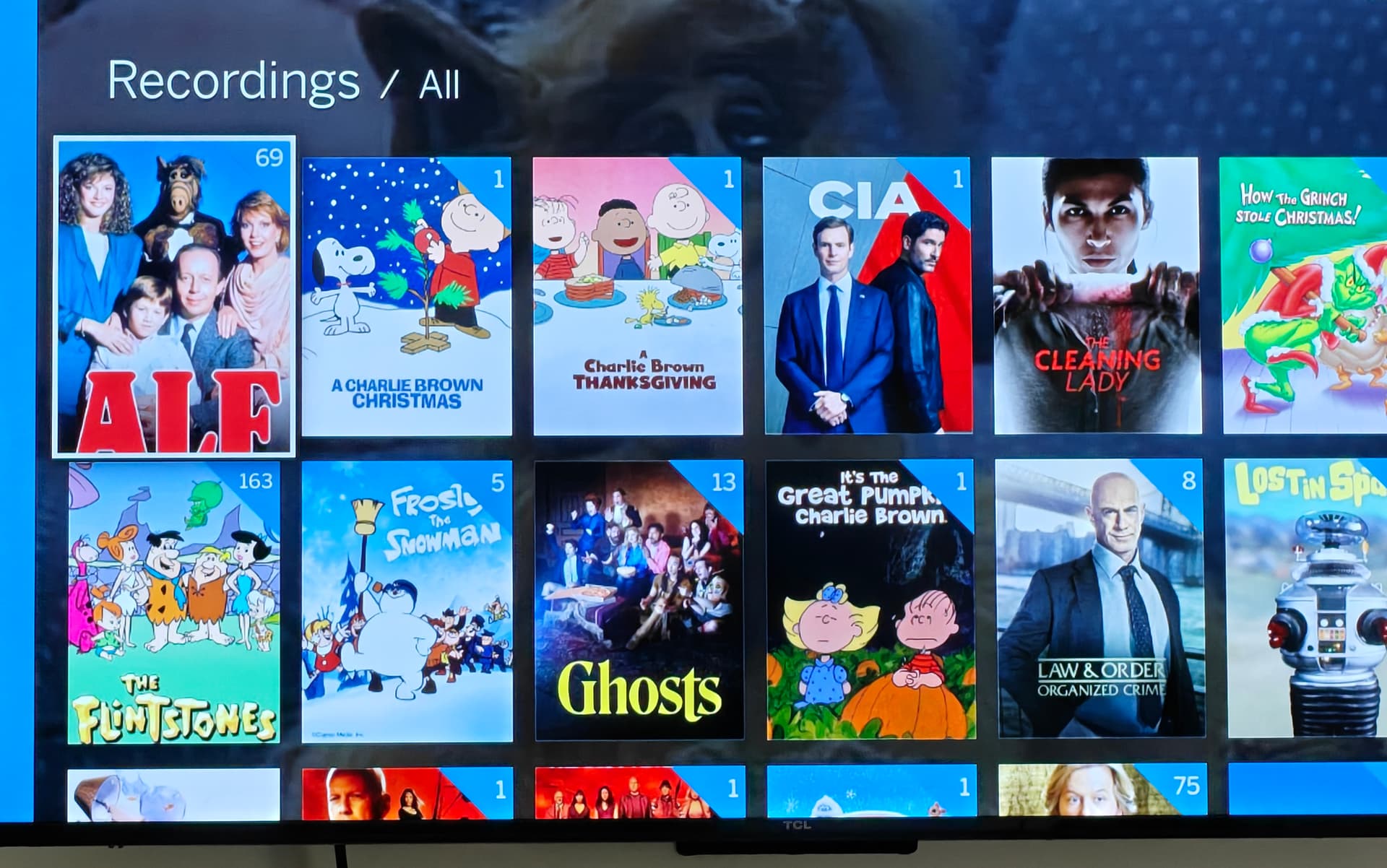

Missing recordings not found anywhere under Library.
Located only on Home/Recent.
Not under Library:
A Charlie Brown Christmas
A Charlie Brown Thanksgiving
The Cleaning lady
How the Grinch stole Christmas
Frosty the snowman
It’s the great pumpkin Charlie Brown
Law & order organized crime
Rudolph the Red-Nosed reindeer
Santa Claus is coming to town
Son-in-law
WKRP in Cincinnati
Also the following have zero recordings, but show up on the Rokus.
*Not in the Android app as they shouldn’t.
20/20
48 Hours
Dateline NBC
Hmmm - so you’re seeing the Christmas and Thanksgiving recordings in RECENT?
Or just the other series like WKRP?
And are you saying that these are not on your legacy app because they don’t exist as current recordings but are present on the 4th Gen app for Roku?
Correct.
They also don’t appear on the Android phone.
I have deleted these series and re-added with same ending result.
