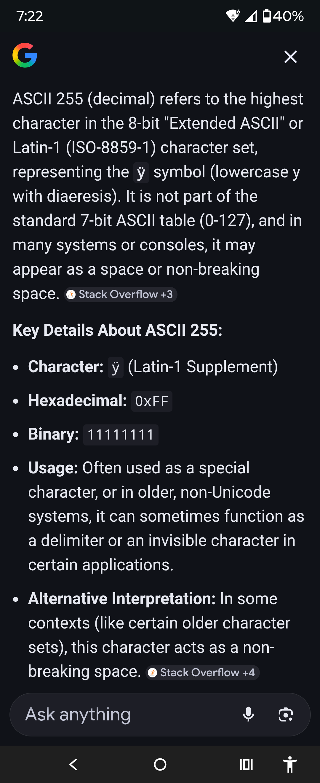

(1 byte is 8 bits so using old coding techniques to save storage the maximum would be 255.)
