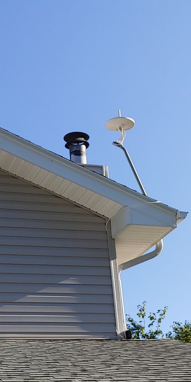

Since everyone else is showing-off their antenna installations, I figured I’d do the same.
Here’s my ANTOP AT-415B UFO HDTV antenna mounted on my roof using a Winegard DS-3000 39" J Pipe Mount.
It’s all connected to my 4-tuner Tablo DVR in my family room, which went from getting 19 area channels ‘ok’ to getting 26 area channels GREAT at 100% signal strength. The chimney isn’t in the way of any towers since there are none in that direction, so I didn’t have to mount the antenna any higher than the chimney.
I decided to go with an omnidirectional antenna because I have broadcast towers in three directions from my house and would have to get three separate antennas otherwise. The table-top antenna I had, previously, was aimed halfway between the ABC/NBC/CBS towers and the CW/FOX towers which caused all of them to come in at about 75% to 85% - even with the antenna on the top floor of my house - and I couldn’t even get anything from the PBS tower which was in a third direction. So the final decision on a new rooftop antenna was to get an omnidirectional antenna so I can receive all the signals from all the Omaha, Nebraska area towers for a change.
I just wish I could put some flashing LEDs around it to give it that real “UFO” look! :smiley:
Here’s a pic of the final install . . .
I know the J hook pipe looks kinda ‘funky’ but it works! :wink:
I had to use the pipe that way because of the angle of the roof along with the way the antenna had to mount to it to stay level.

Nice install and great use of the pipe mount. I’m using one of those on a guest house, the results are sterling. I also like the way it looks.
