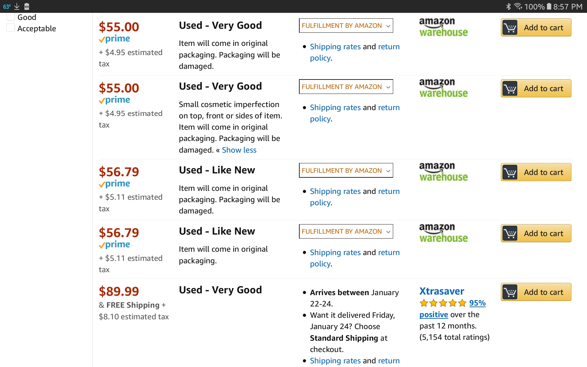

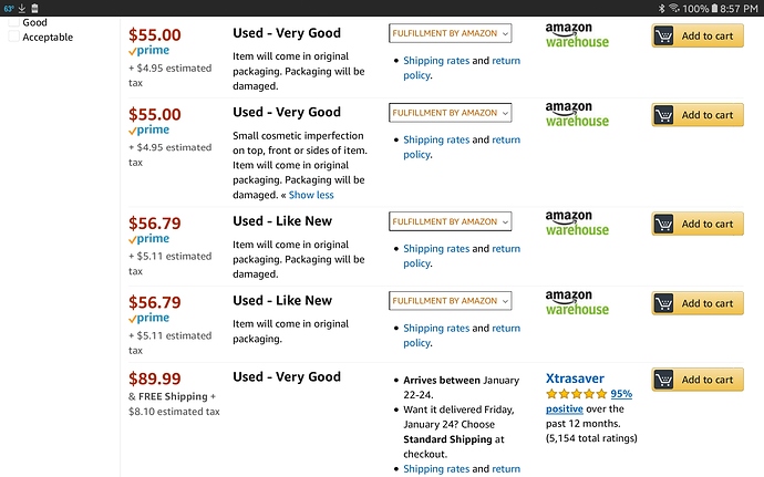

Before when I looked at Amazon.com the AT-400B was at least $80 even used “Good” condition, but right now I see several “Very good” or “Like New” for around $55-$57. It seems there are 3 or 4 listings for that model, try here: https://www.amazon.com/ANTOP-Multi-Directional-Tools-Free-Installation-Performance/dp/B01LSPKWUS
