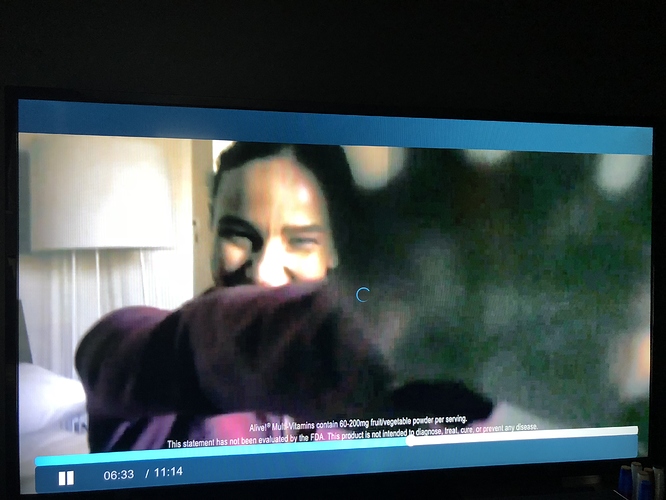

It seems to be random. I just did another test and it took 6 minutes. Heres the weird part: when it freezes I see the progress bar at the bottom of the screen and it shows the time it froze and then it seems to show the time it currently is. I am going to post a photo shortly.
