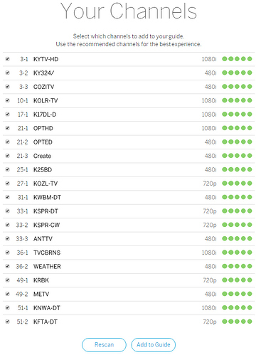

Attached is a screenshot of my channel guide. With full scale reception of 49.1 and 49.2, 49.3 should also come in. I don’t see how messing with the antenna heading will matter.
It’s possible 49.3 is just off the air at this time or was off the air when I last scanned. I really don’t care about 49.3 anyway.
