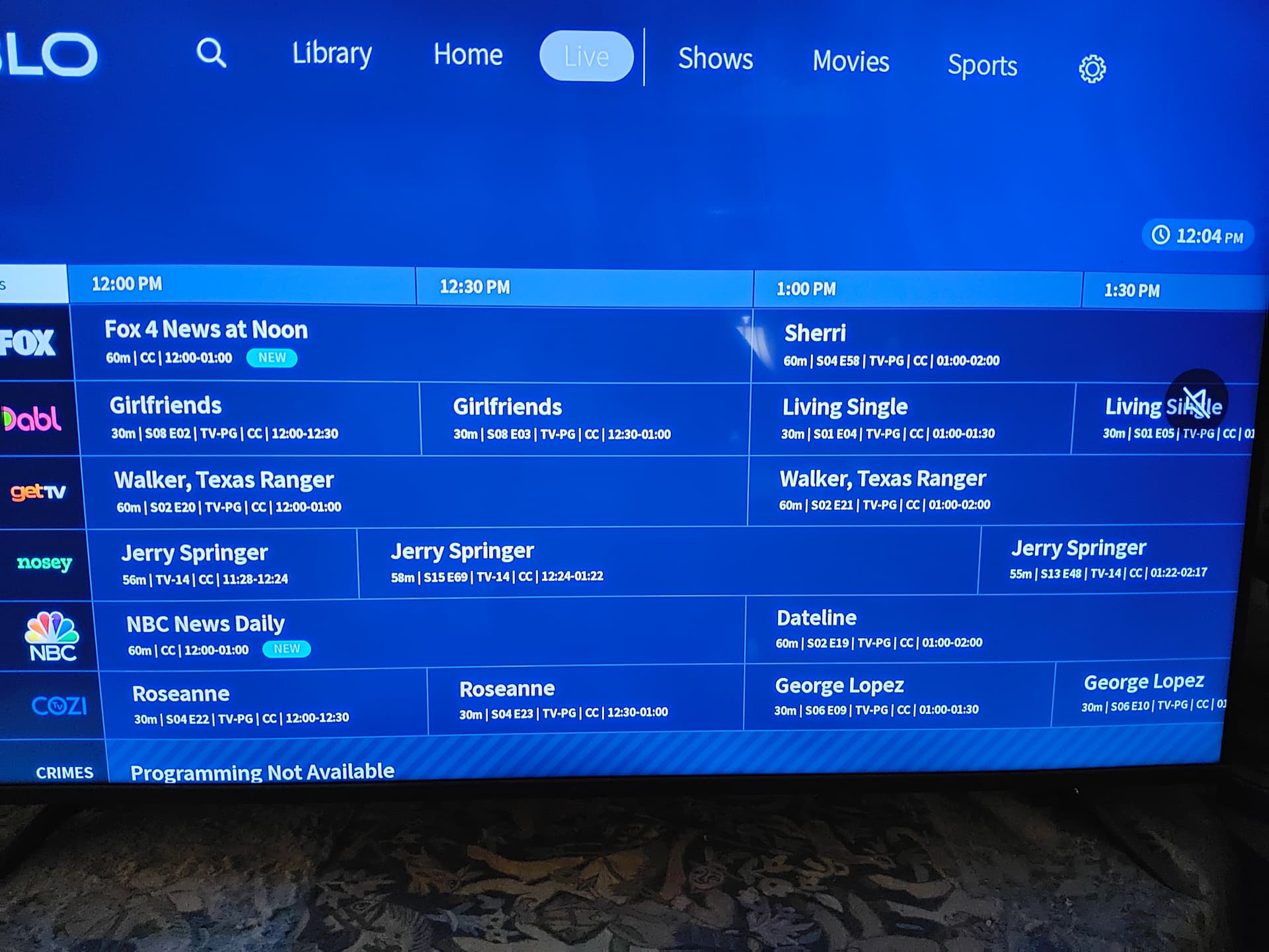

There are two separate things people use interchangeably that are distinct and different.
Channel Lineup
Channel Guide
When you do a scan it is in:
Settings>Channel Lineup>Your Channels
It’s using the antenna and tuner to get all available OTA signals it can. It then does whatever to include the FAST channels.
Click save and it is stored into a local database on your Tablo Gen4.
Then the Guide Update starts. It is a two phase process. The first runs very quickly to flag Your Channels (think check/uncheck) in the local database.
The second phase runs much longer as it is updating the information at the Mothership servers for the Guide Service. The servers have “points-of-presence” geographically dispersed nationally. Also 14 days of Guide data is stored locally in your device.
It is possible for channels to appear in Channel Lineup but not in the Channel Guide. The Channel Guide is zip code dependant. They use Gracenote metadata for that information. It also appears to be segregated by device app.

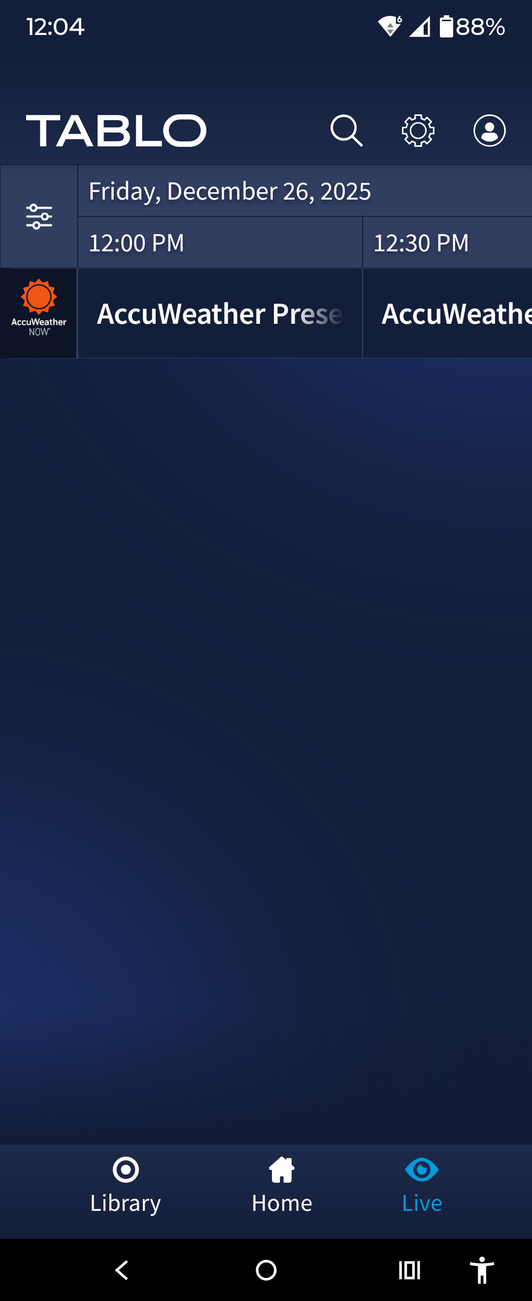

During one episode of downtime my Android mobile showed only 1 channel in the Guide while the LGTV app showed 53.
That is a recent “feature” introduced with the new Category Guide versus the Channel Guide views. All categories are at the channel level not at the show/program level.

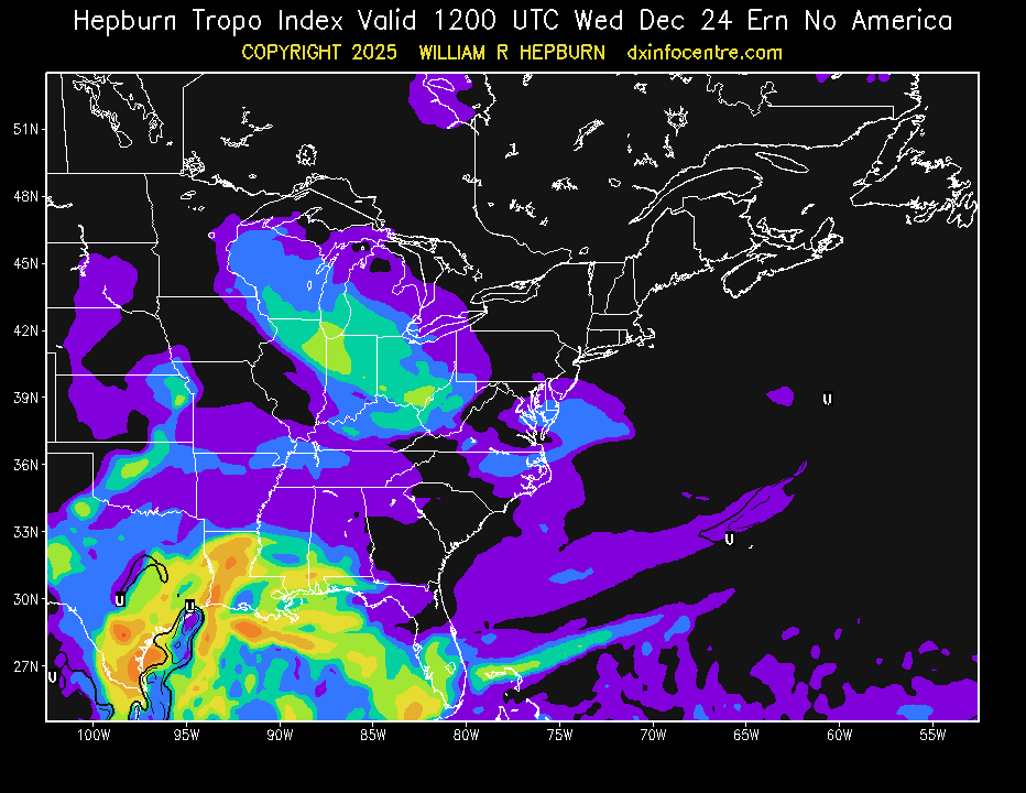

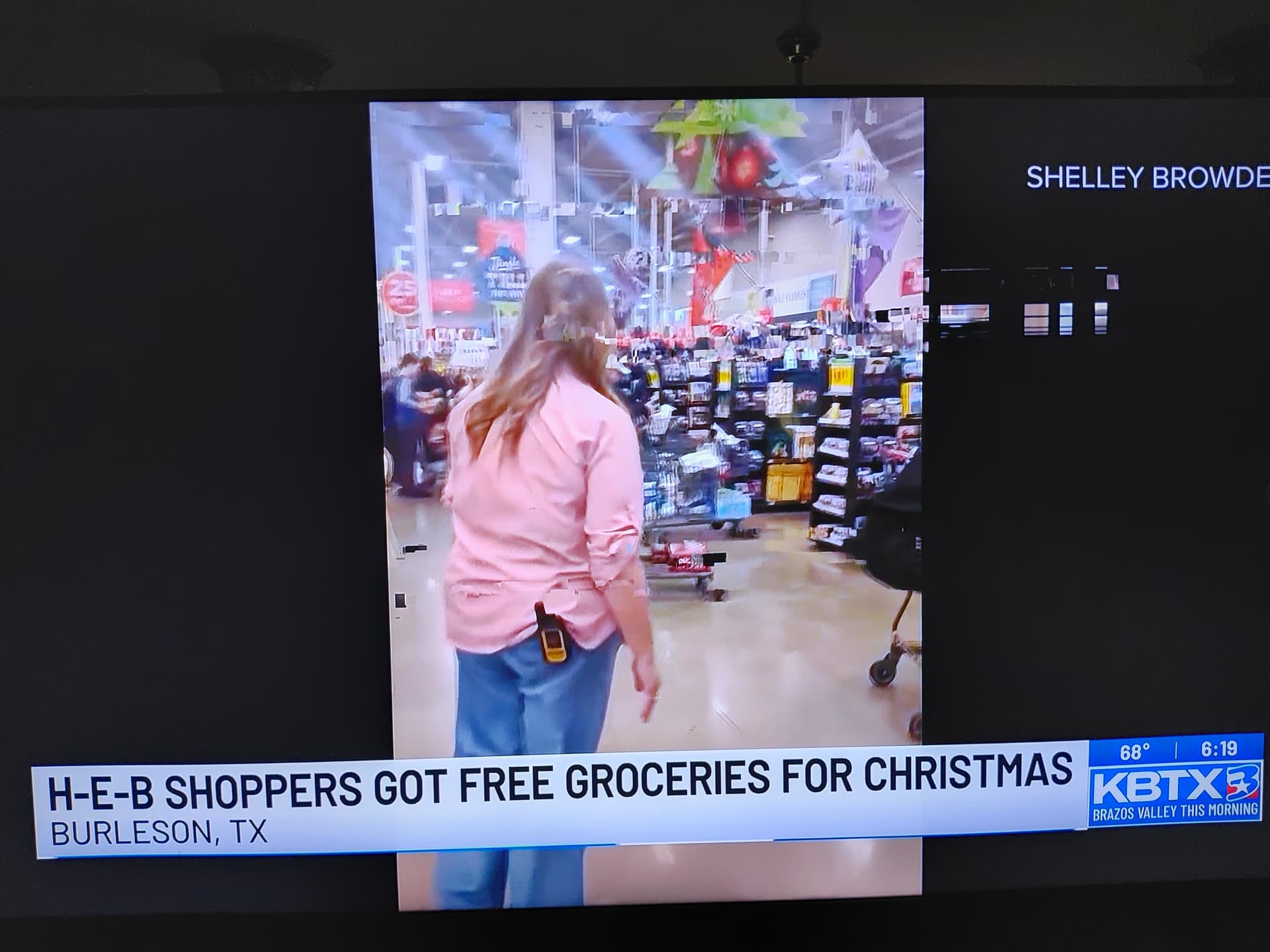

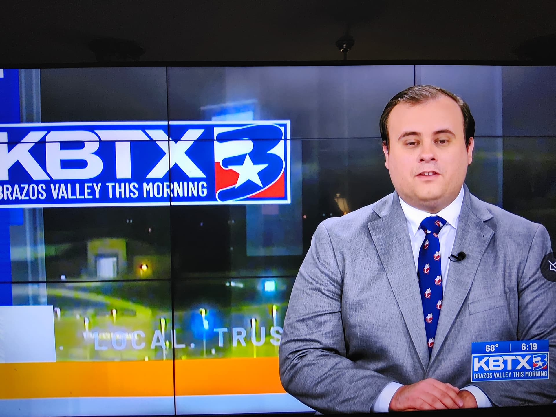

I often have channels during Tropo/weather events which I can receive from hundreds of miles away. I have rescanned my Tablo Gen4 and those channels appeared both in the Channel Lineup and the Channel Guide. I never changed my zip code.
Since we’ve been having so much downtime lately I can’t do a rescan during a Tropo event. So I couldn’t prove that the new Category Guide is doing what I suspect that it is.
Perhaps one of you guys could. Check to see if there are channels in the Channel Lineup but not in the Channel Guide.

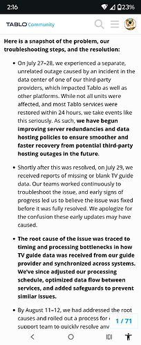

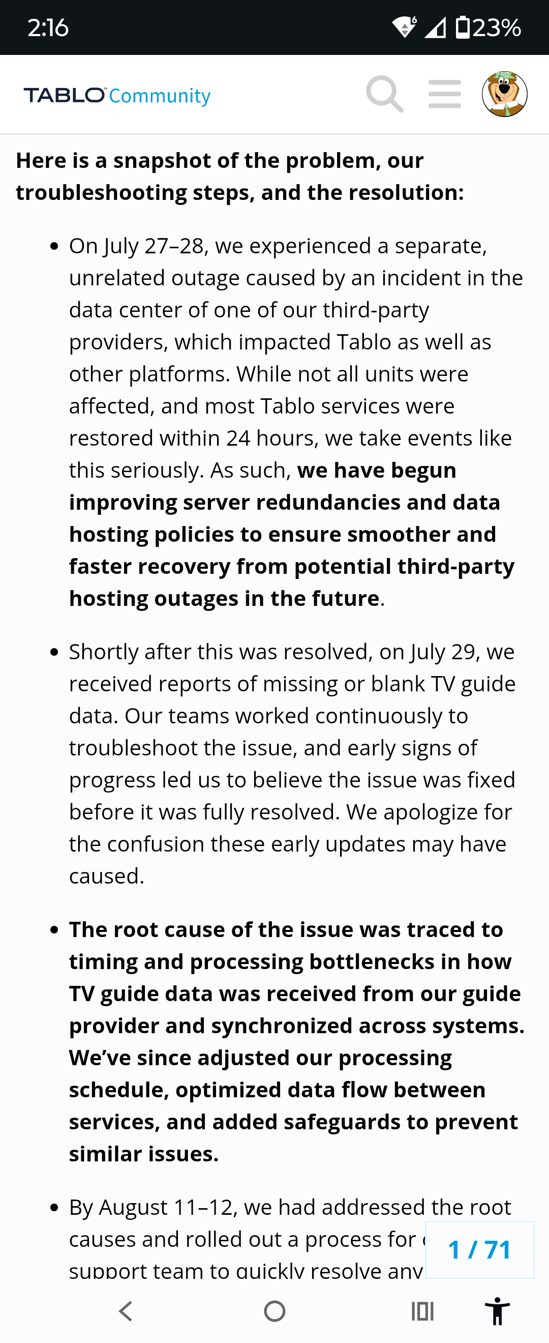

Thank you for the tips… i didn’t install the splitter until i realized there was an issue with the channels i was receiving. My antenna does have a signal booster at the antenna, as well as a rotor (it’s a pretty good/powerful antenna (new), since i live in a very rural area, but with great reception). All good tips i should have mentioned, so readers could better understand… Thanks. I do understand why Tablo would leave out some channels that can’t be aggregated into the guide that they can’t get listing data for, otherwise the Tablo guide would be a mess—wrong Chanel ID, missing episode info, etc… The “BIG ISSUE” I’m having is, my Tablo is one of the few that has not recovered since “The incident” back in August… My unit is unusable as a DVR, with constant rebooting (every 5-10 min.) and losing all data. It’s jittery, hangs up, looses network, reinstalls/reconnects to network, and constantly reboots and goes in and out of “Offline Mode”, etc… It’s basically useless, until they resolve the issue. Tablo keeps blaming issues on everything, but the Tablo itself… So, I’ve replaced the antenna, all the cables, not one, but two new modems and two new routers. I’ve reinstalled the apps and even a full factory reset. I’ve spent hundreds of dollars on new equipment, just to get this $150 Tablo (4 tuner, 4th Gen.) to work… Frustrating, to say the least, and Tablo tech support has been useless. Keep asking me to do the same things, like they’re reading from a script, only to tell me they are going to send the ticket up to the next level, but i never hear back from them. Any suggestions from the community would be welcomed…
Please forgive me if you mentioned this already, but what are you using as your streaming device? And are you using wireless or ethernet to connect Tablo? I understand your frustration about upgrading your infrastructure devices. I just upgraded to fiber internet and all my devices are not utilizing the speed the fiber is offering and the wife does not want me to upgrade to all Eero wifi.
