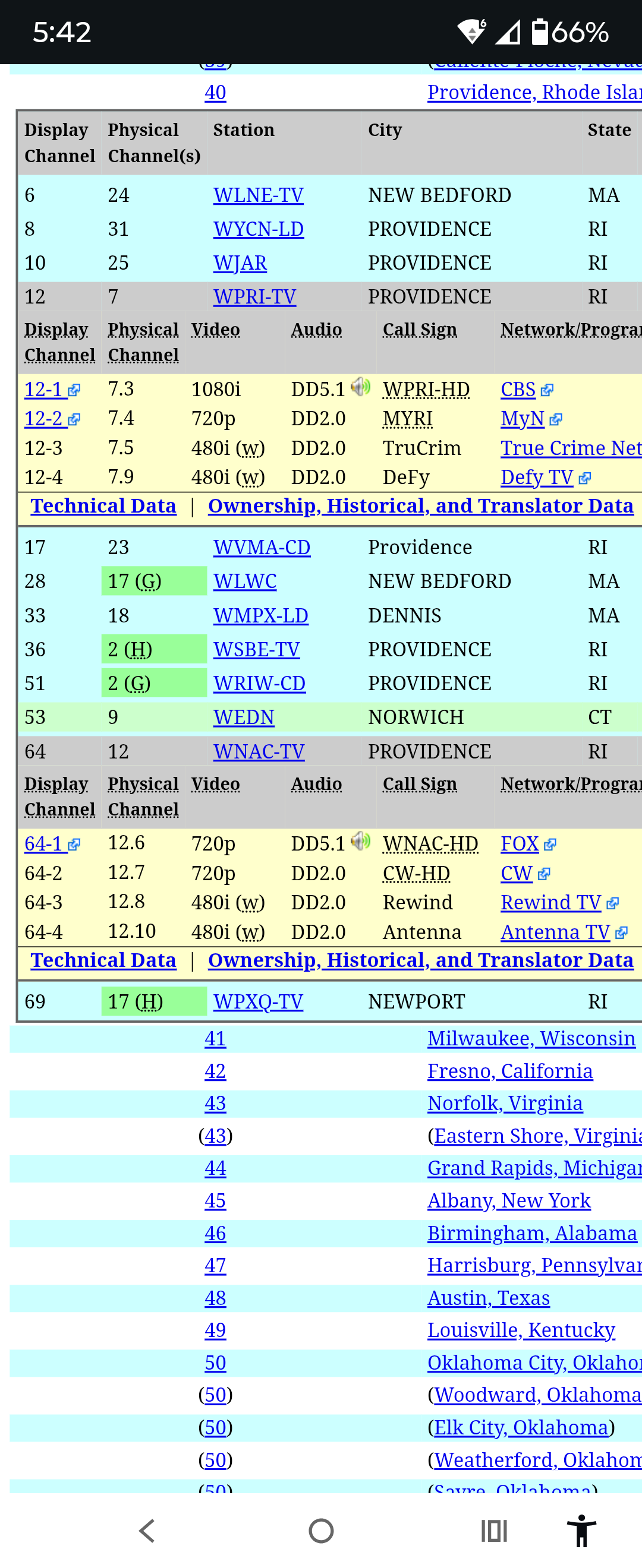

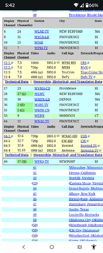

Unlocked new channels by changing location
You also mentioned antenna with rotor…Tablo cannot handle rotor as it relies on a fixed location antenna.
Was it cloudy and rainy? Snow?

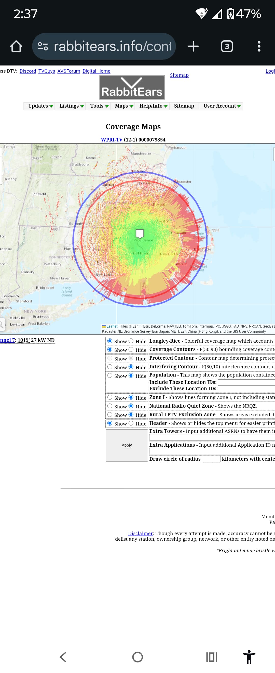

Getting RI stations in MA isn’t impossible or particularly difficult… With a good antenna.
With a so-so antenna or one that might not be positioned in that direction it’s a crap shoot.

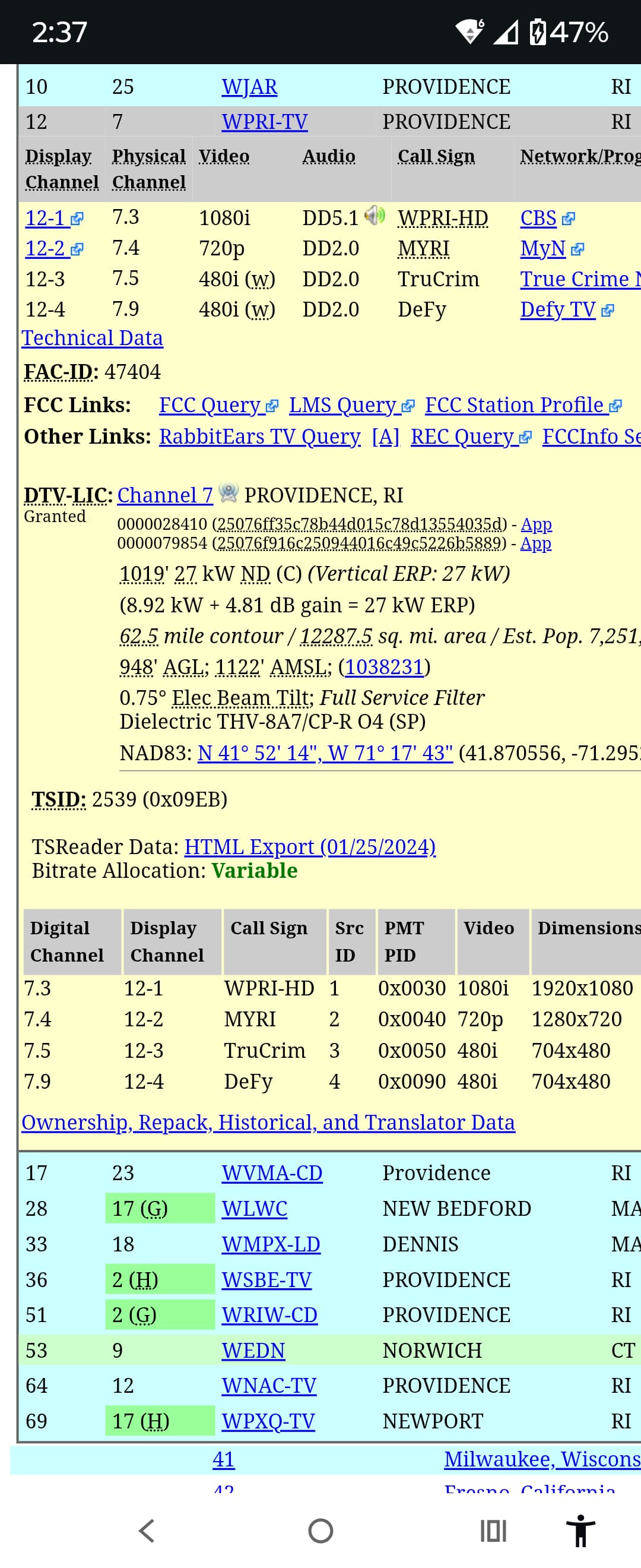

After you got channel 12 did it stay around or vanish? How is the pixelated video?

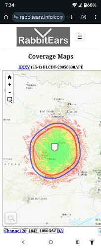

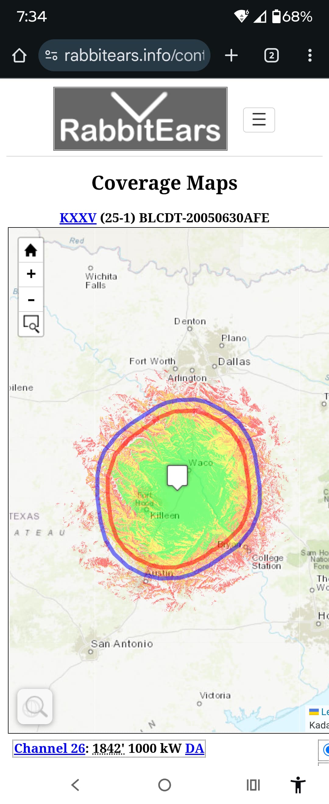

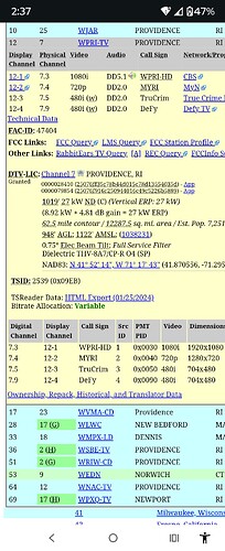

Their transmitter has a 63 mile contour but if it’s cloudy that might double.
I lost 12 and gained 64. And now 64 is gone.
The other thing is that unless you have one of those big antennas, both of those channels are VHF-HI and the mudflap type that comes with the Tablo are UHF only.
If you got 12 or 64 it was from the wires connected to the antenna and not the antenna itself.
I have a Philips Hover which is long and lays flat
And a good choice for fair to strong signals of around 20-30 miles… So saith the Antenna Man Tyler.
It is VHF (HI) and UHF capable. VHF-LO would be about 4 to 6 feet long.

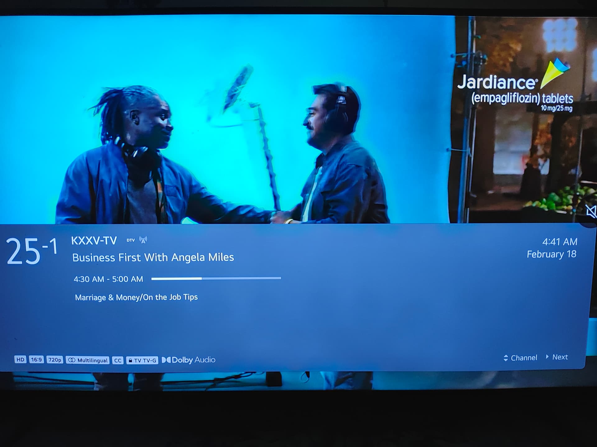

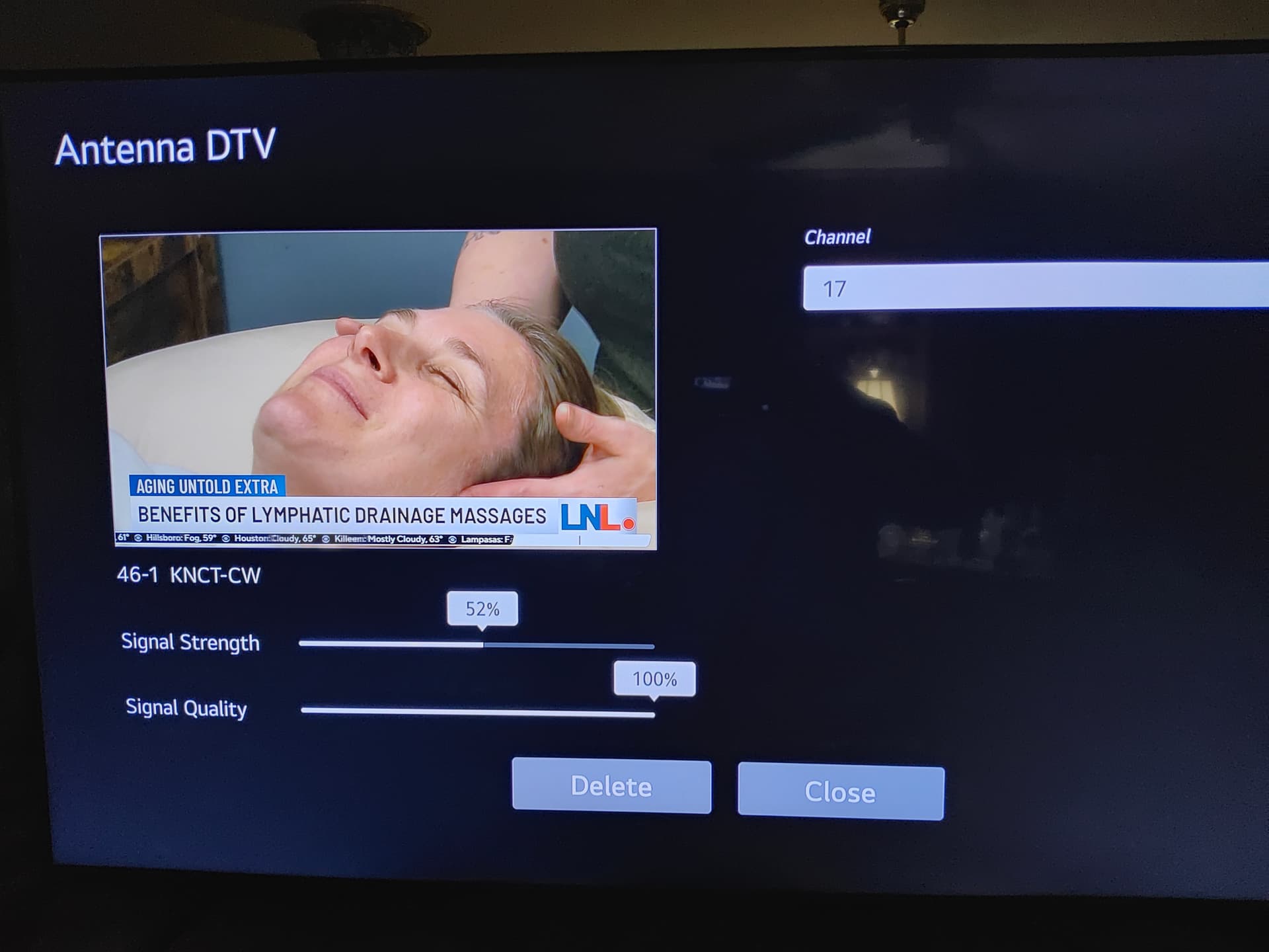

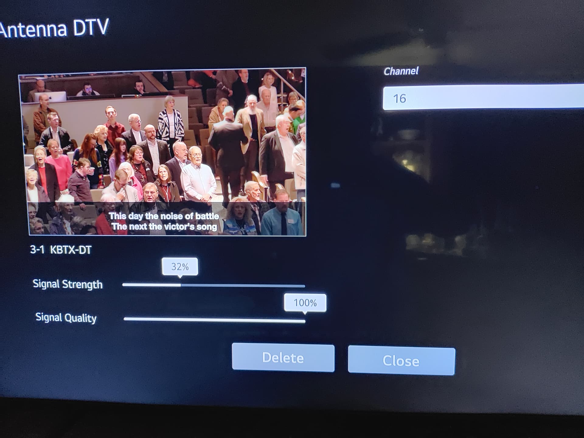

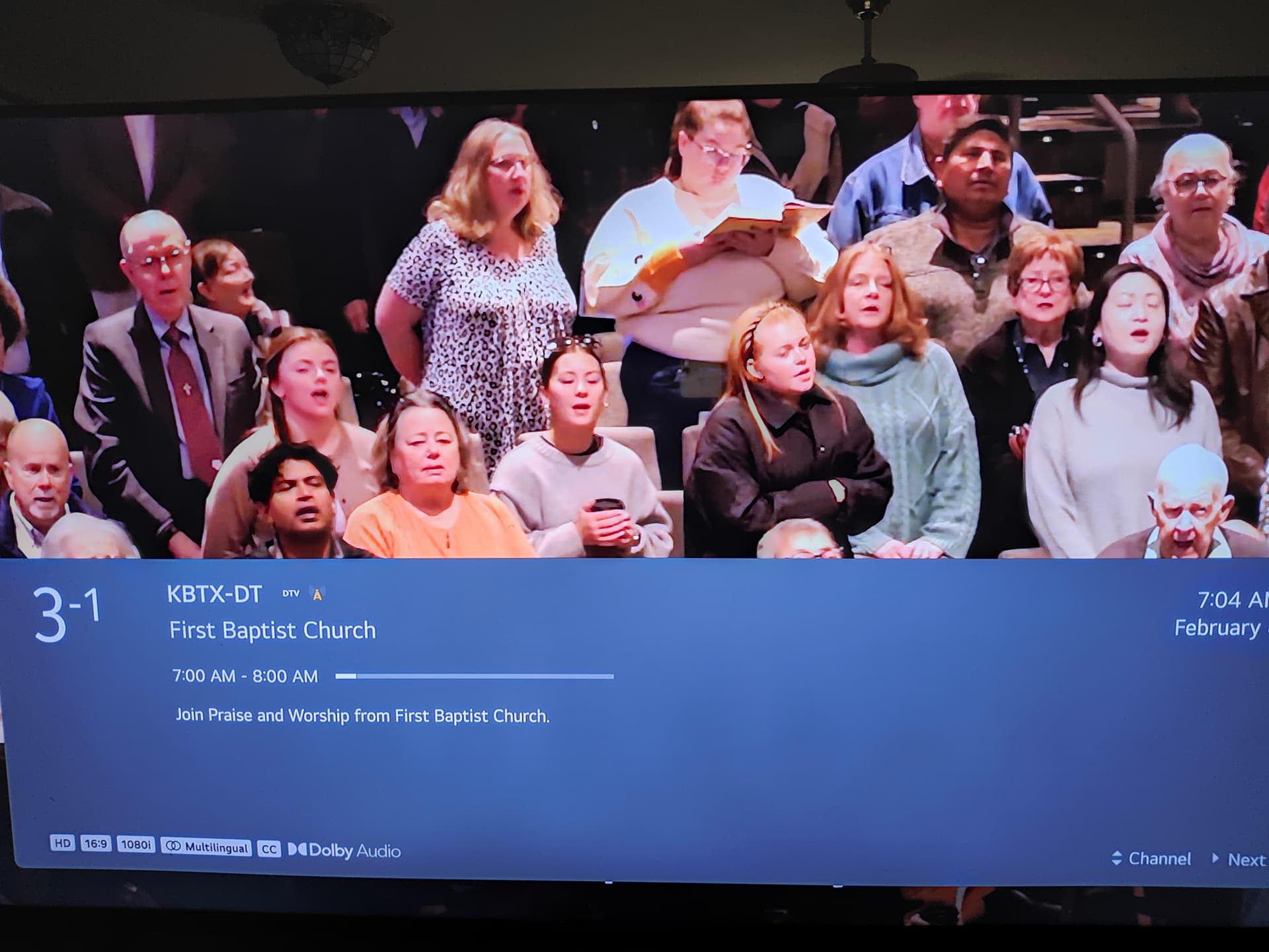

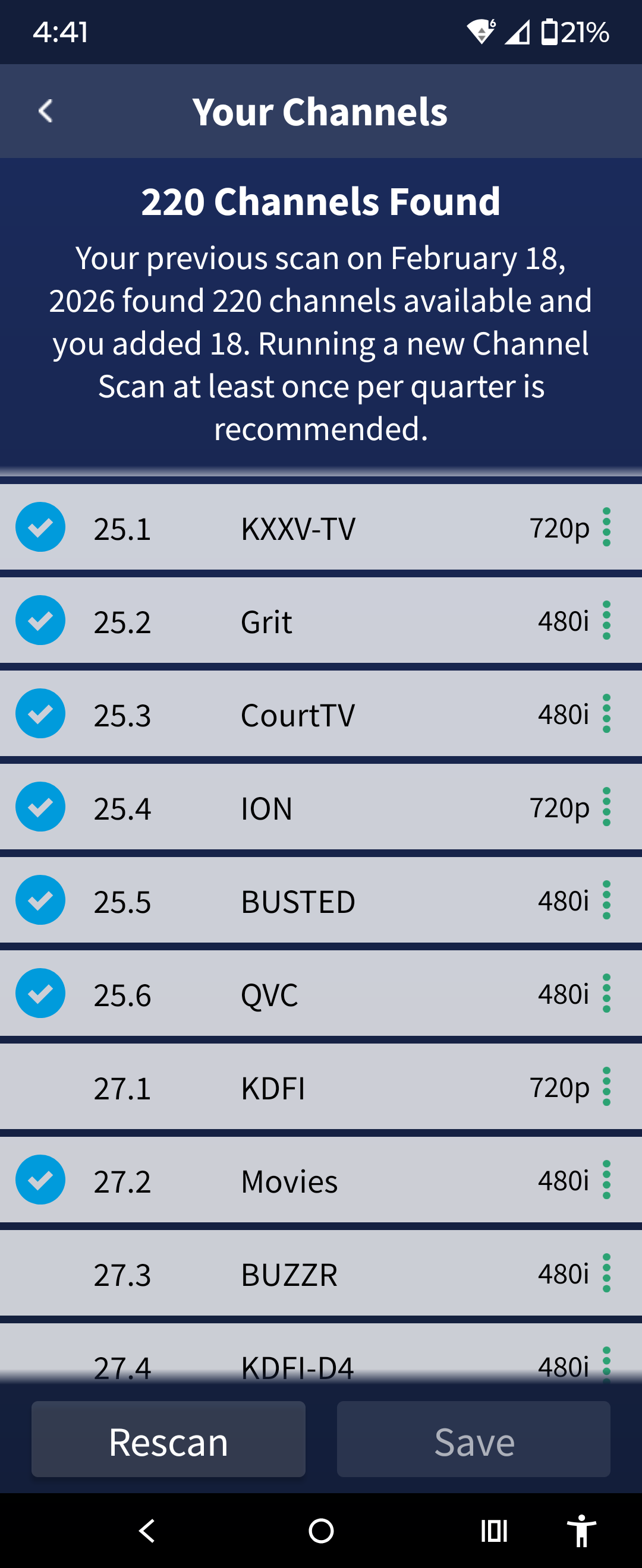

Appearantly the out of market scan no longer works on the Tablo Gen4 for DXing.

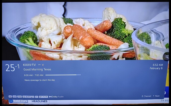

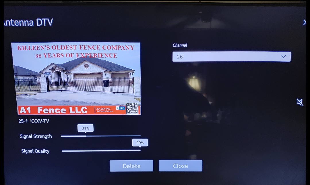

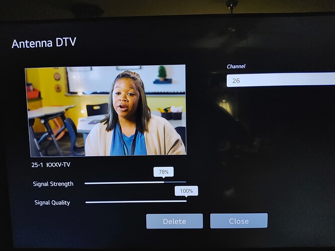

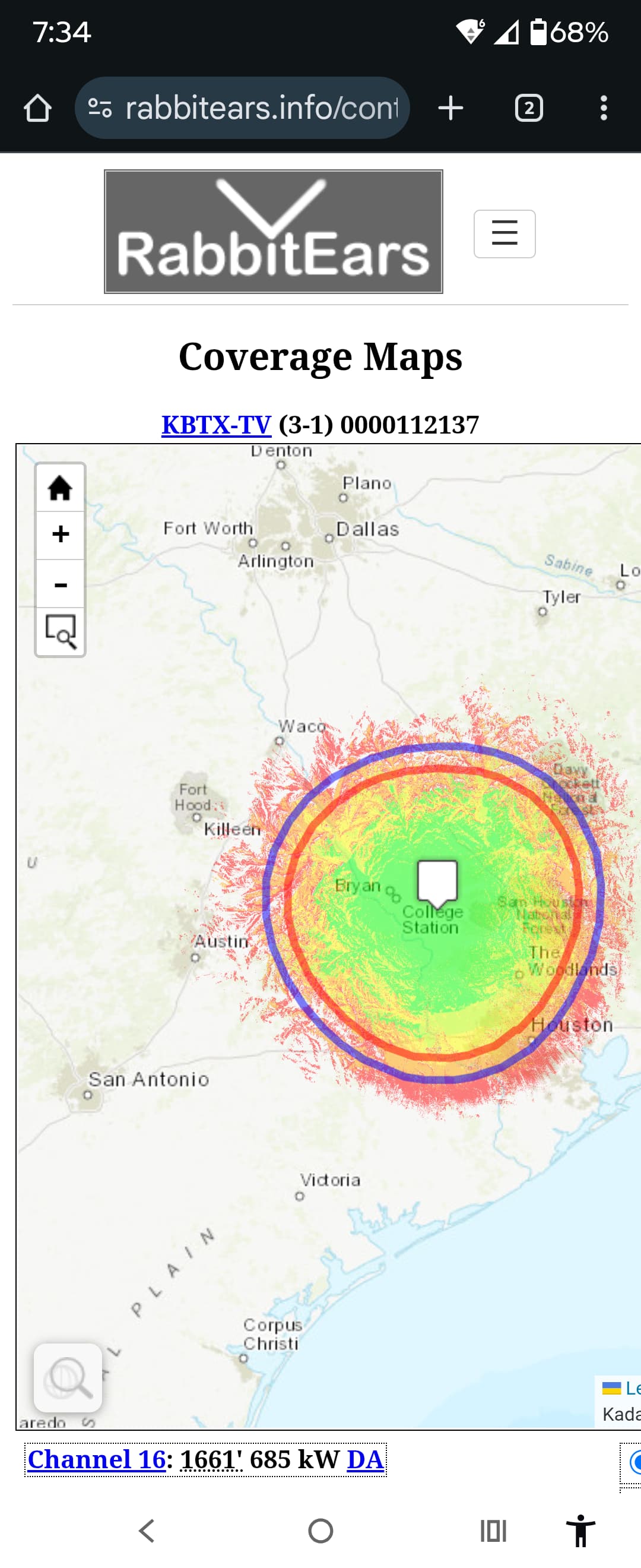

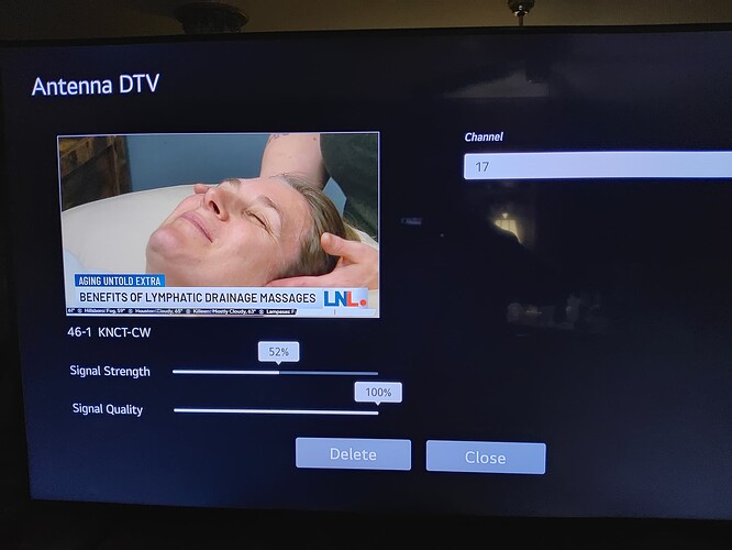

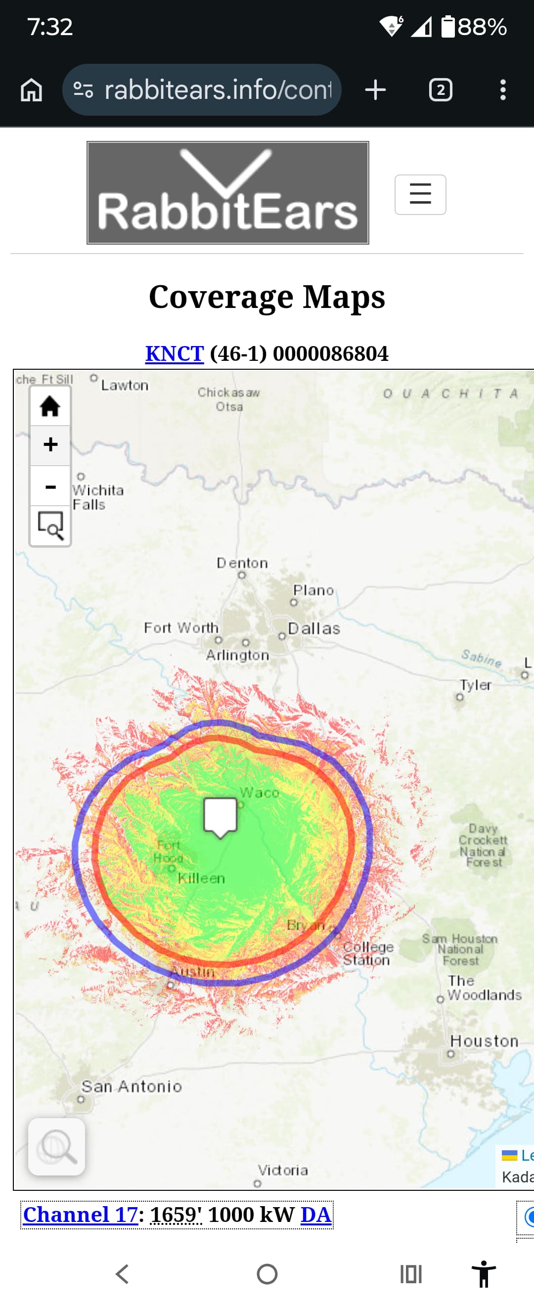

I used to be able to scan and save KXXV 25 Waco in Dallas via Tropo weather events. (Also KBTX 3 RF16 ss32/sq100 in Bryan Texas)
Friday the 6th I’d been watching KXXV for about an hour via antenna to LGTV. Sunday the 8th I was watching KBTX.

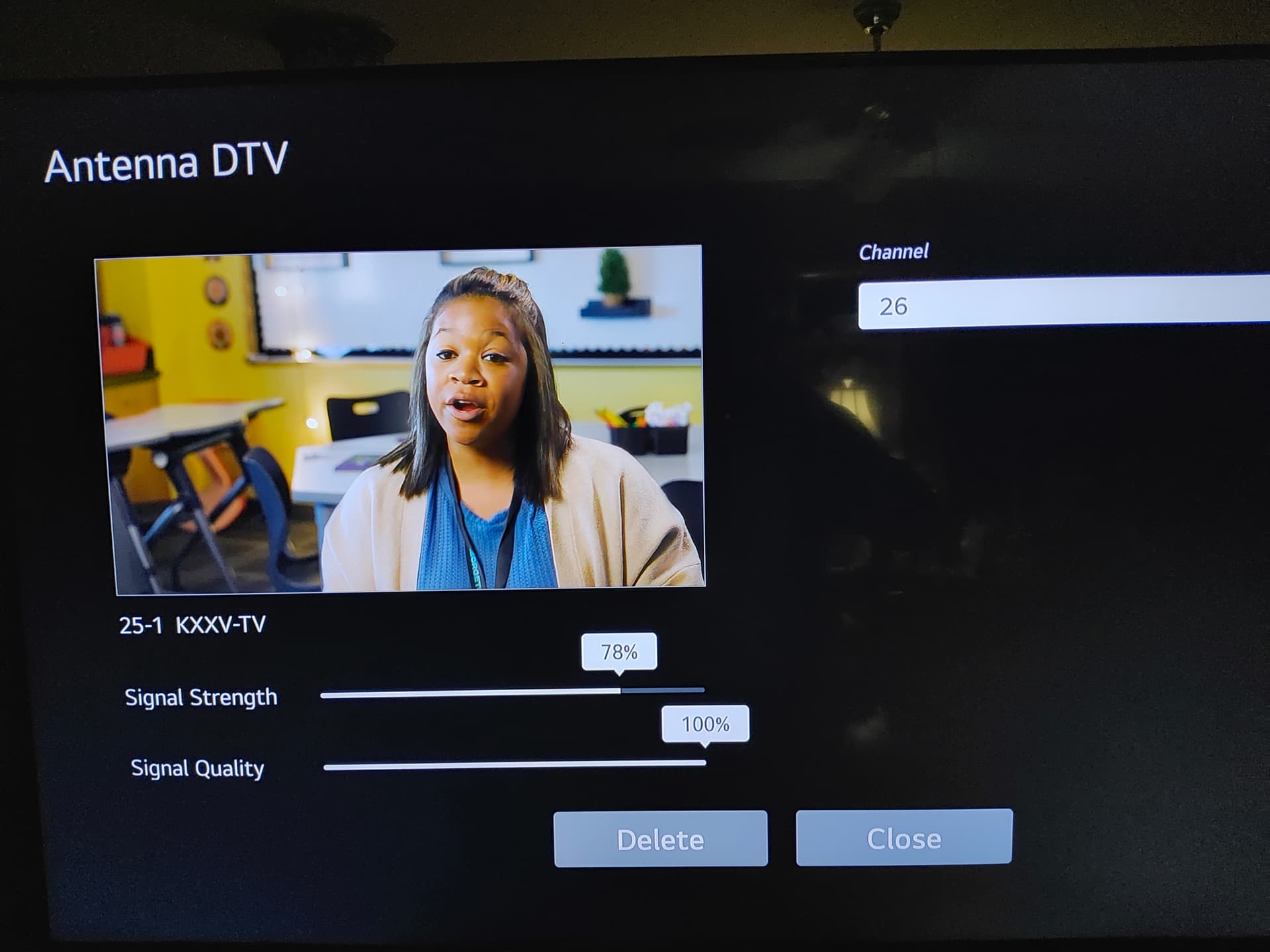

I rescanned and saved using Android mobile, LGTV app and Fire Stick 4k G2 but it doesn’t recognize the RF16 or RF26 signals. It’s not in the Channel Lineup or the Guide and channel count remains the same. I even changed the zip code to rescan. No joy.
So either the signal strength is below Tablo Gen4 threshold (ss31/sq100) or out of market has been “remediated” or deprecated.

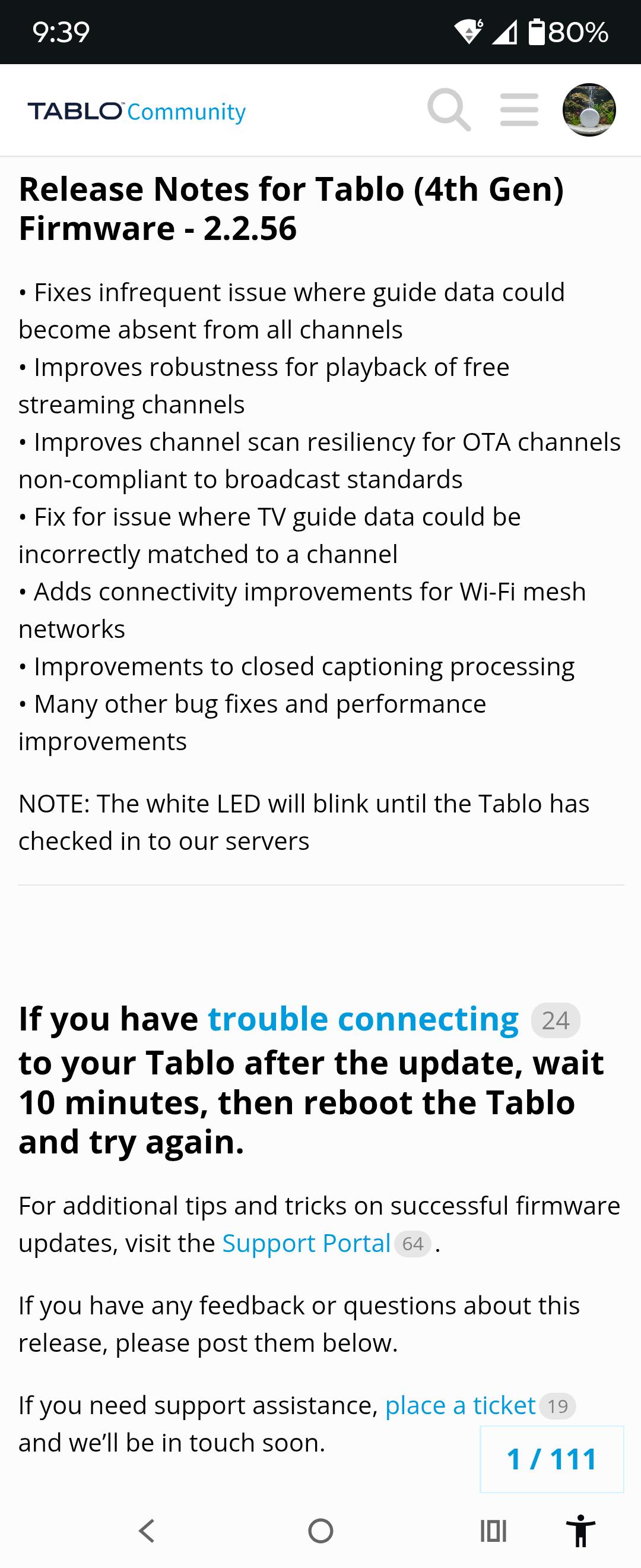

Improves channel scan resiliency for OTA channels non-compliant to broadcast standards

The release note referencing “improves channel scan resiliency for OTA channels non-compliant to broadcast standards” does not prevent out-of-market channels from being scanned. This improvement helps the channel scan process tolerate unusual or irregular broadcast characteristics (for example, non-standard encoding parameters from a broadcaster). It does not restrict which channels can be detected.
If a channel is not being scanned or appears inconsistently, it is most commonly related to reception conditions such as signal strength, interference, antenna placement, or intermittent broadcast quality. There is no firmware limitation that causes this to happen. Even channels that briefly report high signal strength may not be consistently detected if the signal is unstable during the scan.
If you’re continuing to see issues, we recommend running a fresh channel scan and double-checking antenna setup and cabling to ensure the best possible reception.

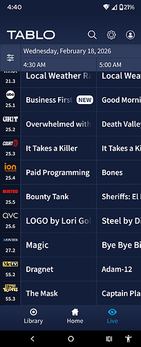

27th email received from Escalations Team February 20 (refer to above post). So if your rescan isn’t working, “keep rescanning until it does work”. Useless.

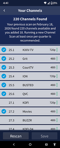

Saturday the Tablo Gen4 was getting fewer and fewer channels with each rescan. The signal :vertical_traffic_light: indicator got worse and worse and flipped from channel to channel. I did all the standard “jiggle the handle” recovery methods to no avail.
Sunday morning I power cycled (unplugged the power) to perform a “cold reboot”. Afterwards it worked “normally”. Meaning a different problem surfaced where there was a station that was in the Channel Lineup but not in the Guide. I opened another support ticket. The channel appeared later that afternoon. Still haven’t heard from support on that ticket.
Wednesday morning I’m able to rescan and save out of market stations again. Watching and recording out of market also.
But only if the signal strength is above midpoint. Although local KHPK 28 (ss30/sq98 - 2 red dots) scanned and saved. So it’s inconsistent.
