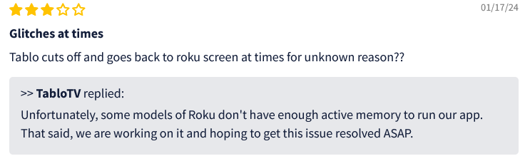

Found this in the reviews of the gen 4.
Seems Nuvyyo’s developers did not read the specs for Rokus.
https://developer.roku.com/docs/specs/hardware.md
