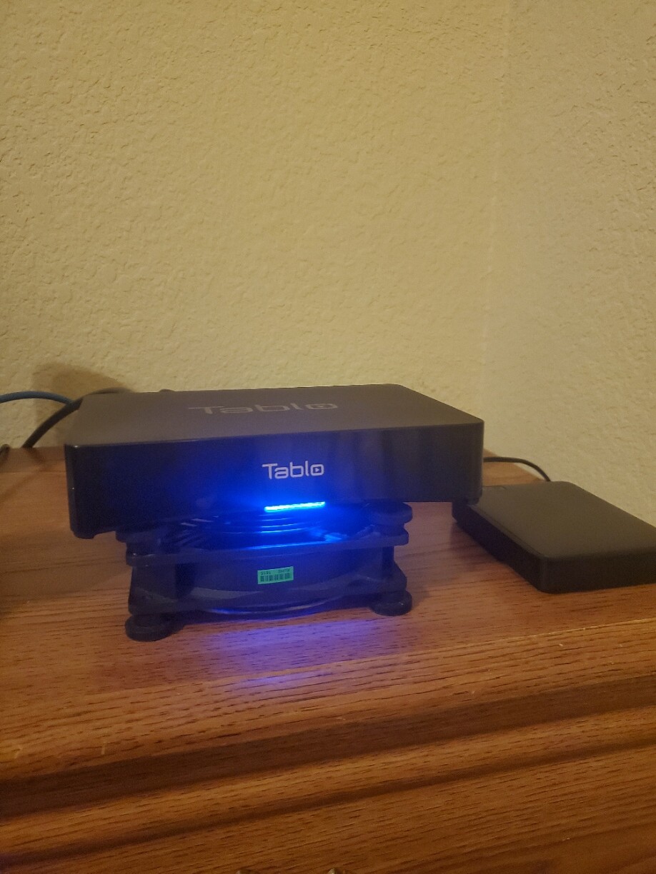

I’ve had my Tablo Quad sitting on a cooling fan for a number of years now due to it getting so hot. Just plug it in to the USB port on the Tablo itself.
Tablo runs hot but there OK, but I still put a cooling fan under it this is the one I use. Amazon.com there use to be just 11bucks that was years ago before tariff and inflation.
Ya, I have the same fan. I have my OG Tablo upside down on bottom, then the fan in the middle, then Gen4 Tablo on top.
