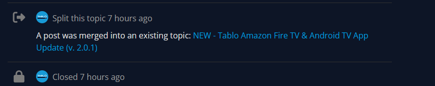

@TabloTV merges different posts into the one update so they can better track the issues. This may be what happened here.
I’m sorry I don’t understand what you mean. I’ve been posting here all afternoon.

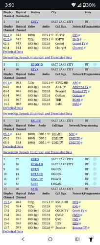

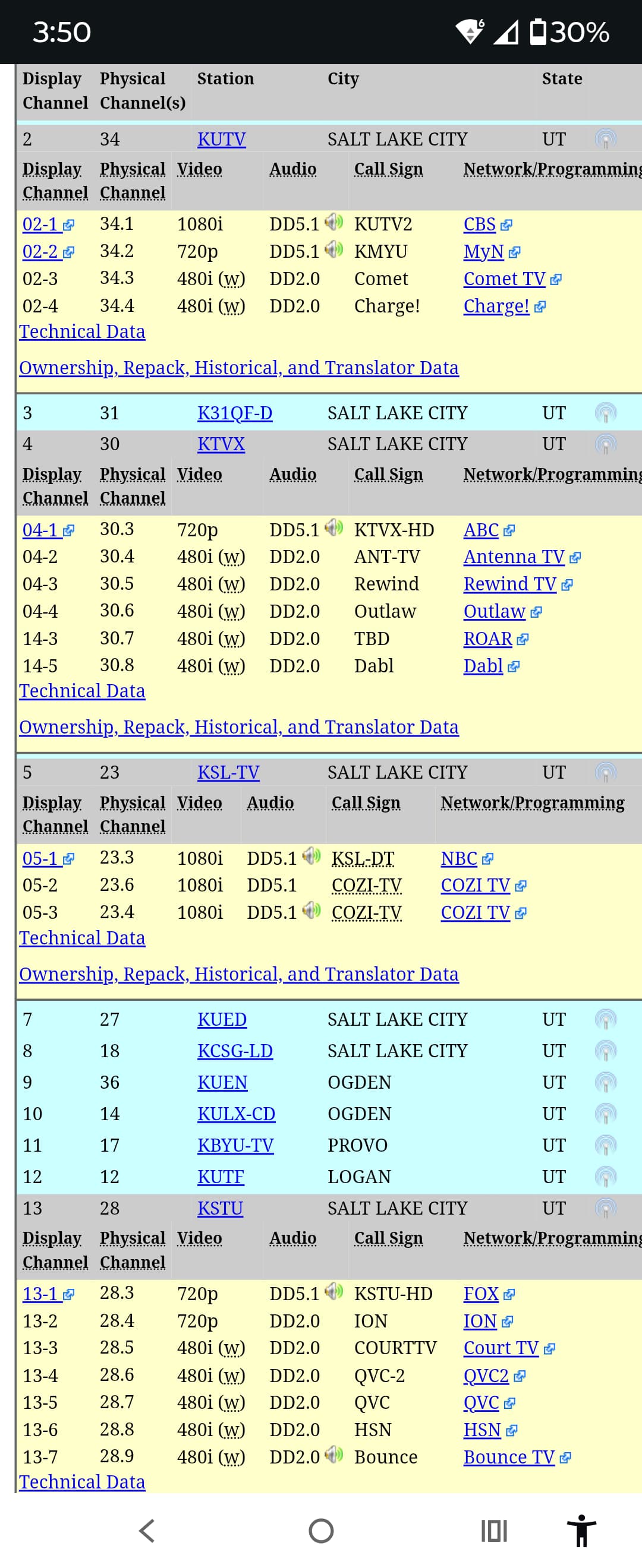

Go into your Tablo Gen4 settings and to the guide and select/unhide 3 subchannels in the range below FOX 13… Or better yet below MeTV 8. Or just add one and see if the description moves down by one.
This will add 3 channels to your guide, even though you may hate them.
In all the examples you showed they are correct for the first three then the program descriptions get honked.
I might play with this later. I already deselected MeTV in my channel scan and the sorting issue still happened, just without MeTV. Maybe a different channel lineup might not cause the issue, but I need my channel lineup (which we have been using fine for the last 1-1/2 years) to work correctly.

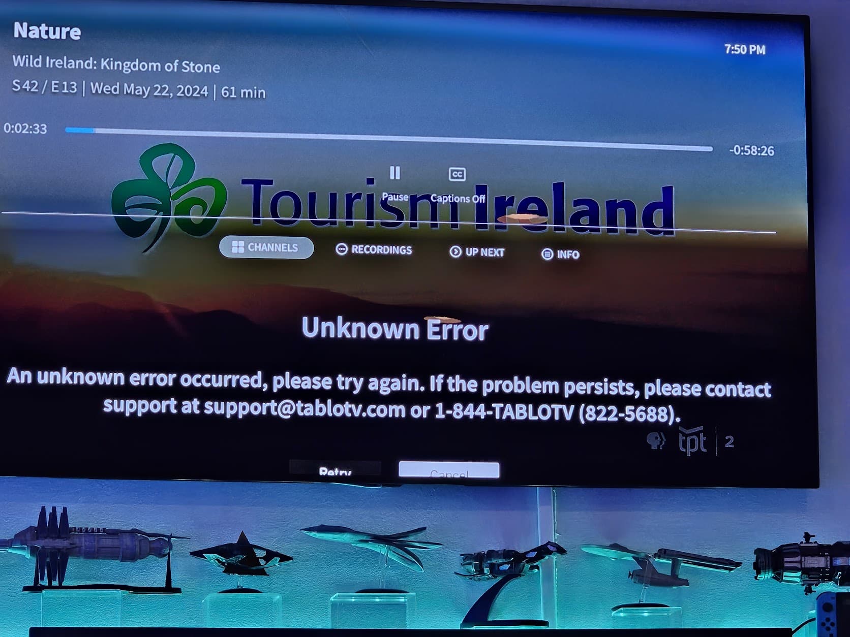

I do still occasionally see an error like this when using the right arrow on the remote to skip forward. ShieldTV Pro. (older screen shot and I think the error wording is different now)
Here’s the current text of the error. The easiest way to reproduce is to try to skip forward while watching a program that is still recording.
