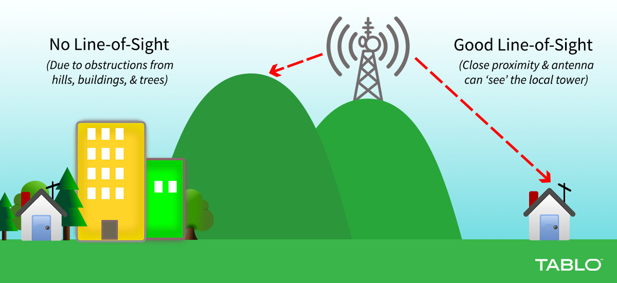

- Television stations broadcast programming from towers in your area. Under normal atmospheric conditions and with clear line-of-sight, those TV signals travel via radio waves up to 70 miles away. Beyond that range, signals are blocked by the curvature of the earth and cannot reach your TV antenna. https://support.tablotv.com/hc/en-us/articles/52378409413780-How-Location-Affects-Over-the-Air-TV
Even within range of local broadcast towers, obstructions like hills, buildings, trees, and your home’s construction materials can make it more difficult for over-the-air signals to reach your TV antenna. https://support.tablotv.com/hc/en-us/articles/13986352427028-Sources-of-Obstructions-and-Interference-for-Antenna-TV

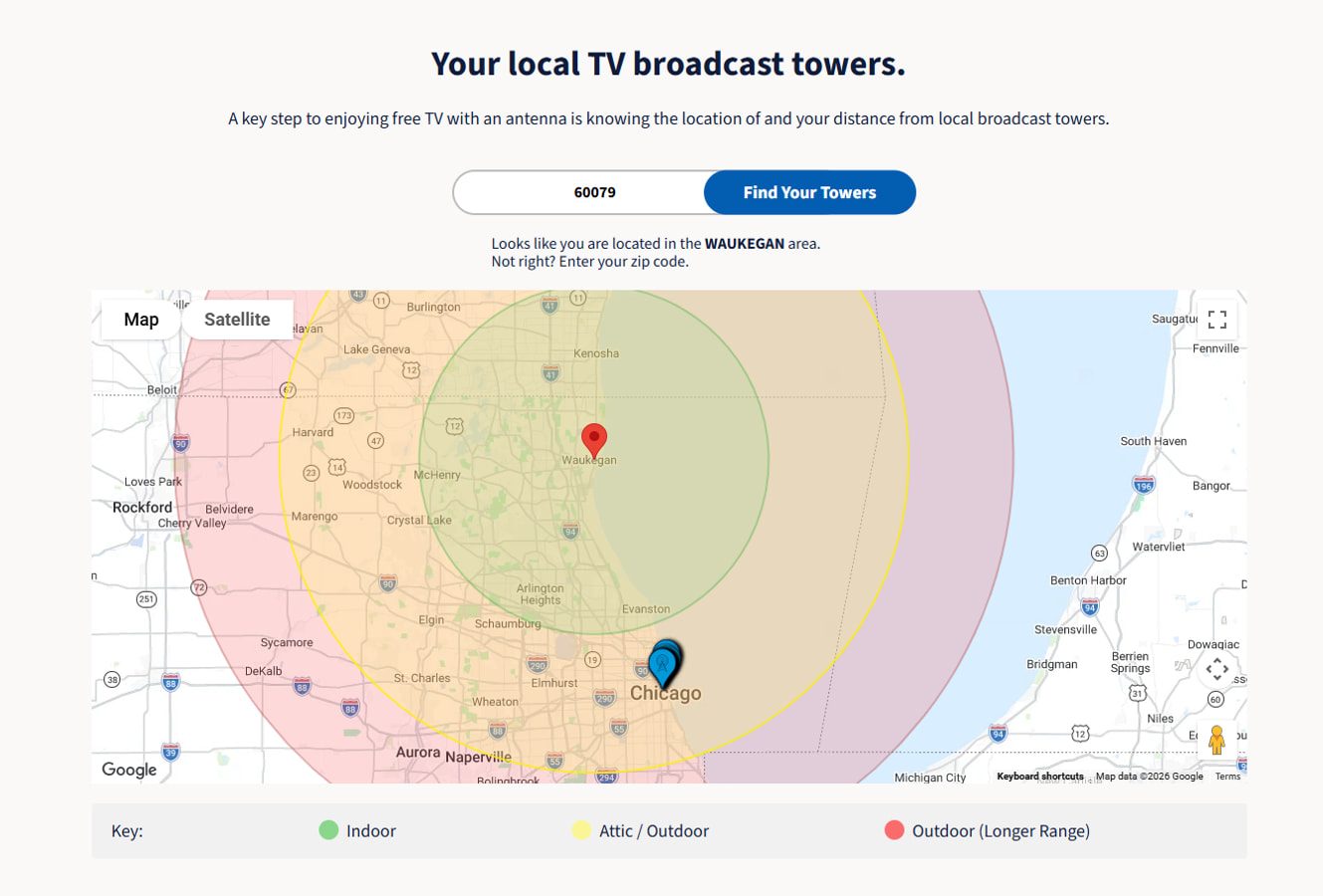

The type of TV antenna you need depends on your distance from local broadcast towers. You can use this tool on the Tablo website to find out where the broadcast towers are in relation to your home: TV Antennas & Over-the-Air Reception - Tablo TV
Indoor TV antennas work best for those living in urban areas, 35 miles or less from local broadcast towers. Those living in the suburbs and beyond will likely need a larger, more powerful outdoor TV antenna to pick up signals reliably. https://support.tablotv.com/hc/en-us/articles/14867208312340-What-Kind-of-TV-Antenna-Do-I-Need

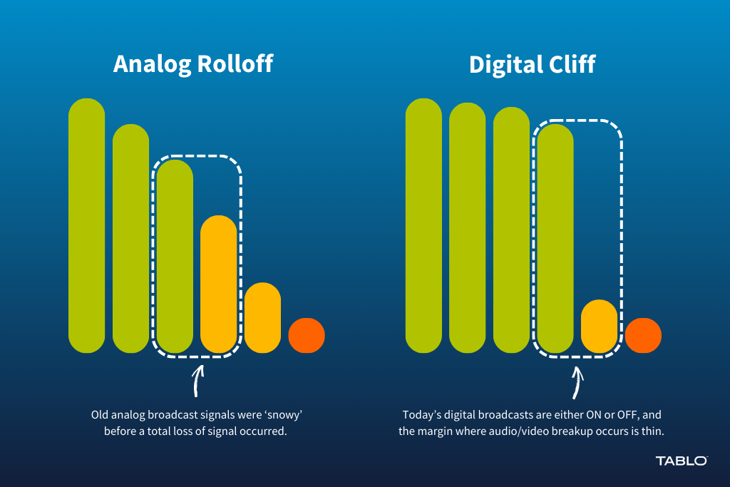

If reception is fine for a handful of channels on your TV but not your Tablo, the digital cliff could be at play. Unlike your single-tuner television, your Tablo splits your TV antenna’s signal across multiple tuners (either two or four). The small drop in signal strength this causes could make the channel too weak to receive. https://support.tablotv.com/hc/en-us/articles/210429406-Troubleshooting-TV-Antenna-Reception-Issues#h_01JPX55RW3GNK2DWXYN5M15J9Y
