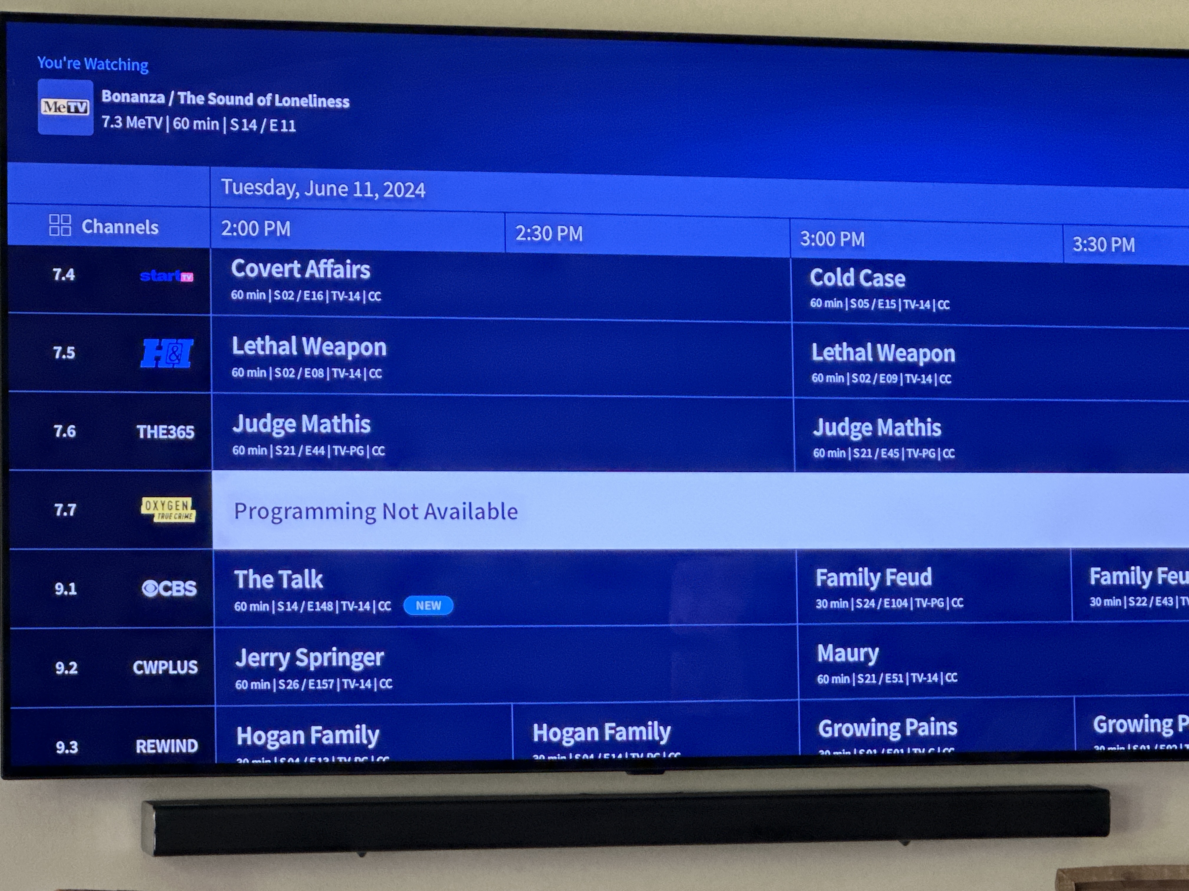

I’ve had Tablo 4 for over 6 months. One of my ota channels WITN 7.7 is Oxygen has never had guide data. Tablo tapped in to my Tablo to check data. They come back and said it’s the local tv stations fault. All the other providers show channel data for this channel. Just not Tablo. Also several channels still have no logo.
We did see that there was data on our end when we checked this morning, but we can’t see if the data was missing on previous days. It’s unclear if perhaps the station was negligent in sending data to our provider for a few days or if something else happened.
Thanks for checking. Still not understanding though why the channel would not show up at least with guide data missing?
