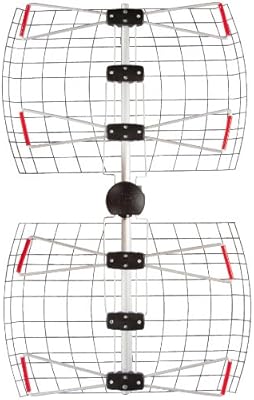

I just recently made the switch… I used a 4 Element Bowtie antenna from amazon:
I have it connected to about 100ft run of coax with no problems. Farthest station for me is about 55 miles. Works great and have it mounted inside my attic out of the elements.
