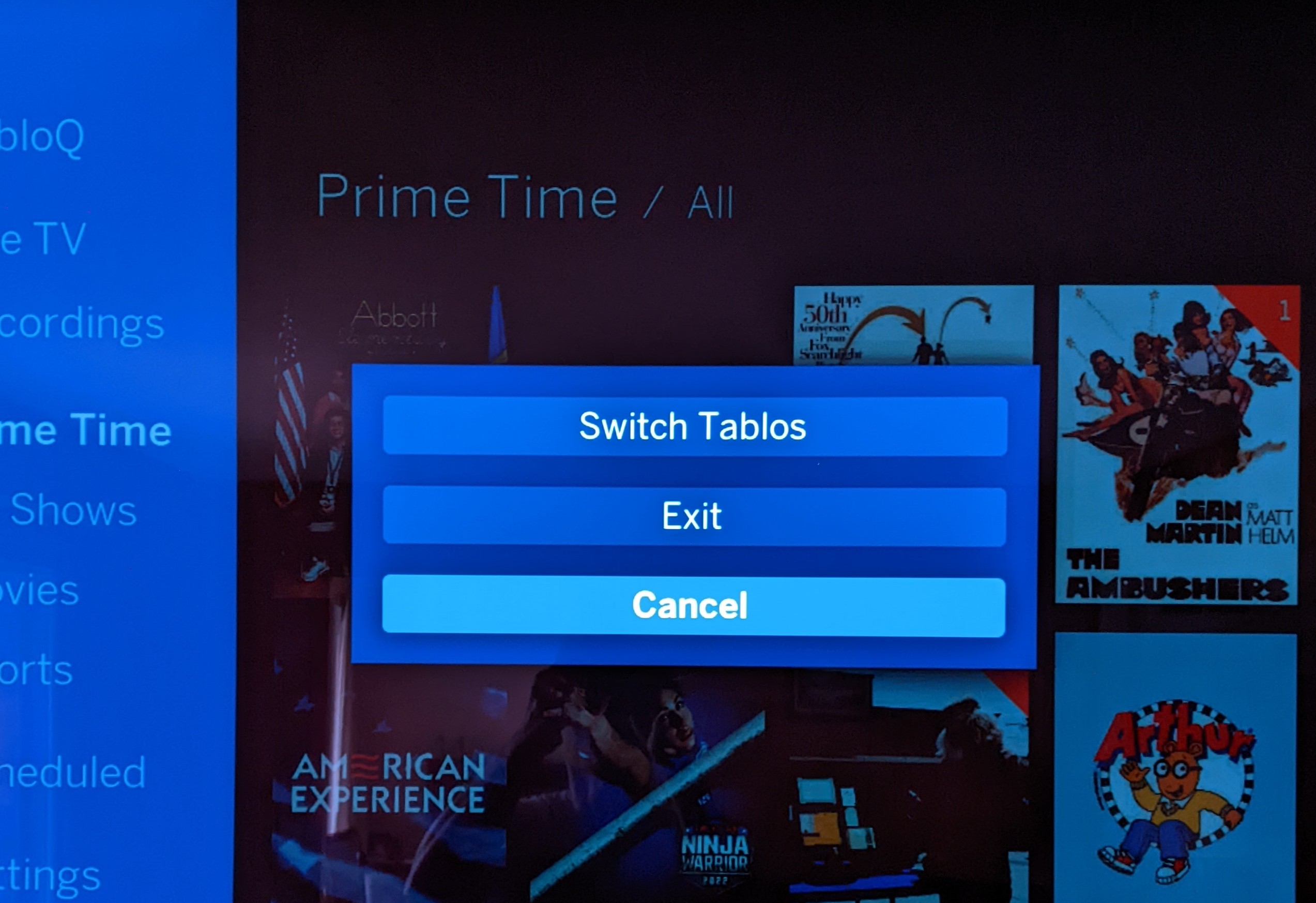

In the Roku app when I hit the back button (rather than the home button) I get this screen. Is this what you’re seeing? And your Quad is not displayed?
Yes, I saw that menu. Using Switch Tablos does nothing.
