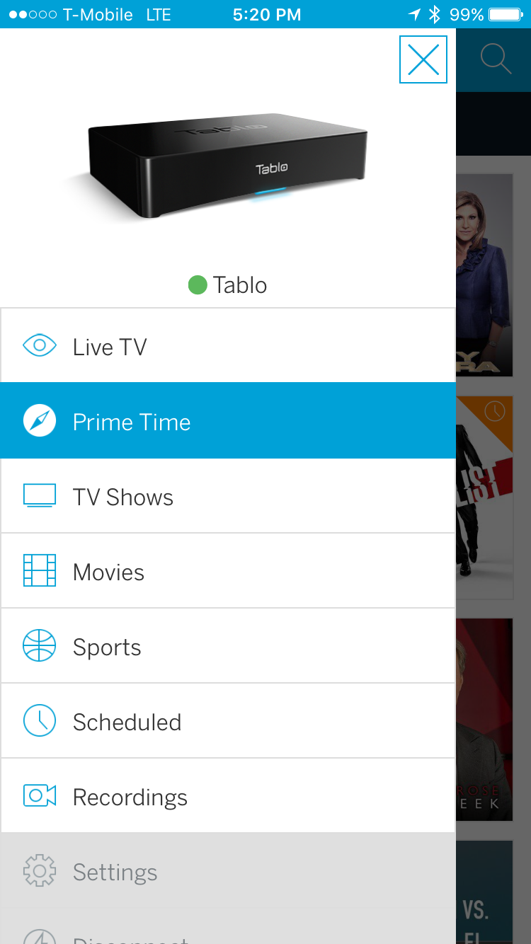

on home local area network, it plays the live streams right away. Connecting to the remove tablo on LTE shows “green” traffic light status so I believe it has done all the syncing at that point?

I see the OP is on TMobile LTE too which is when I usually have this same problem:
I’m on iPhone 6plus.
