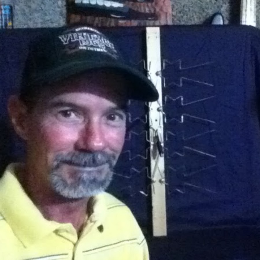

Thanks for mentioning that … about the far away stations … that is kinda where we are now with the Tablo … some stations come in on the TV tuner, but not on the Tablo. That is why I was wondering if i needed a better antenna and/or a pre-amp of sorts. Looks like I may want to try this antenna first? (see pic) - is that the one?

Yes, that’s the Tuxedo that I built. However I added two more of those 6-1-3" bays at the bottom to have it a 4 bay (I also scrunched them in more). Notice though that he likes his newest build\model better than the Tuxedo.
