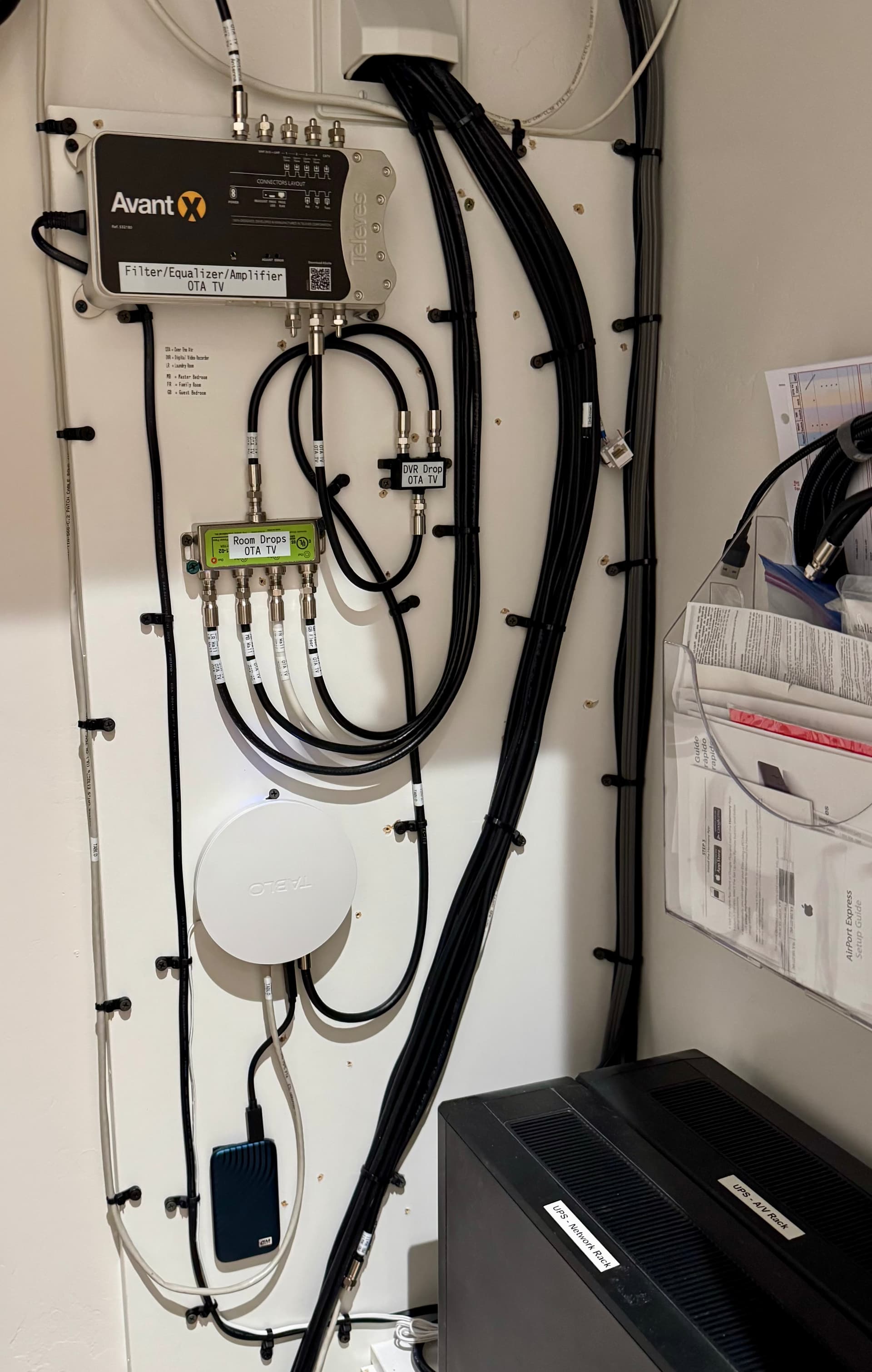

I totally get that both the RF side and the network side of this equation are critical to getting good results with the Tablo. I’ve been way off in the deep end on this OTA stuff for several years. First with the FireTV Recast, and then Tablo Gen 4 for the past couple of years. I have high end Televes antenna and signal processing equipment. I have my own RF signal meter. Point is, while I do have occasional signal quality issues (solar crap, other interference, crappy days), I know exactly where my signals stand (strength and s/n) and can compare between Tablo and TV tuners any time.

CRG, I can’t help you with your problem, but I do have to say I’m quite impressed with your wiring set-up… That is quite well done, Sir..
