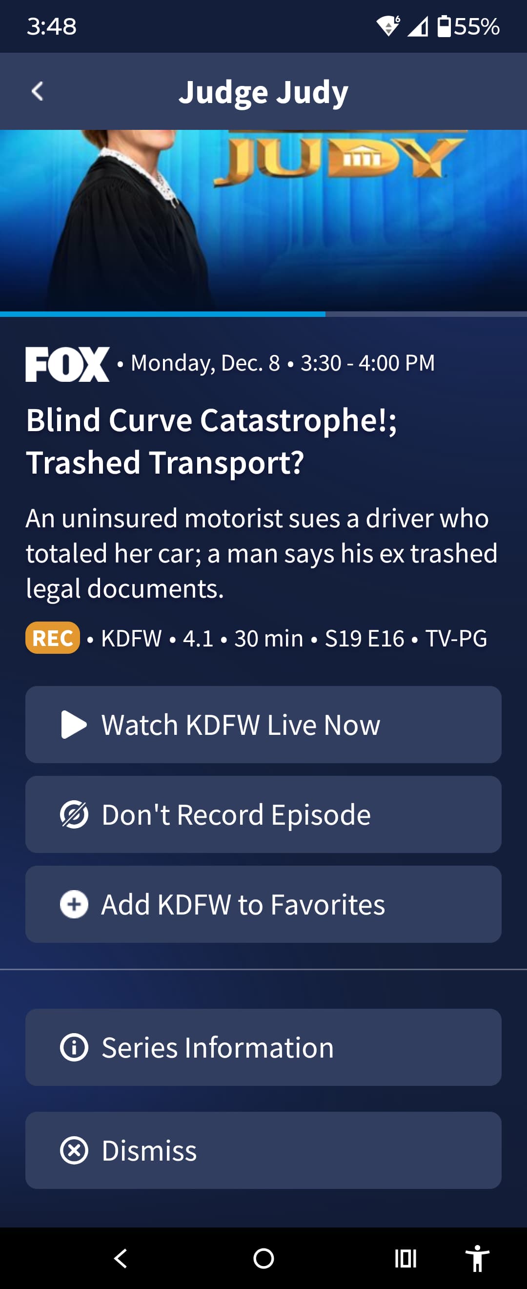

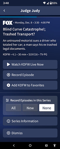

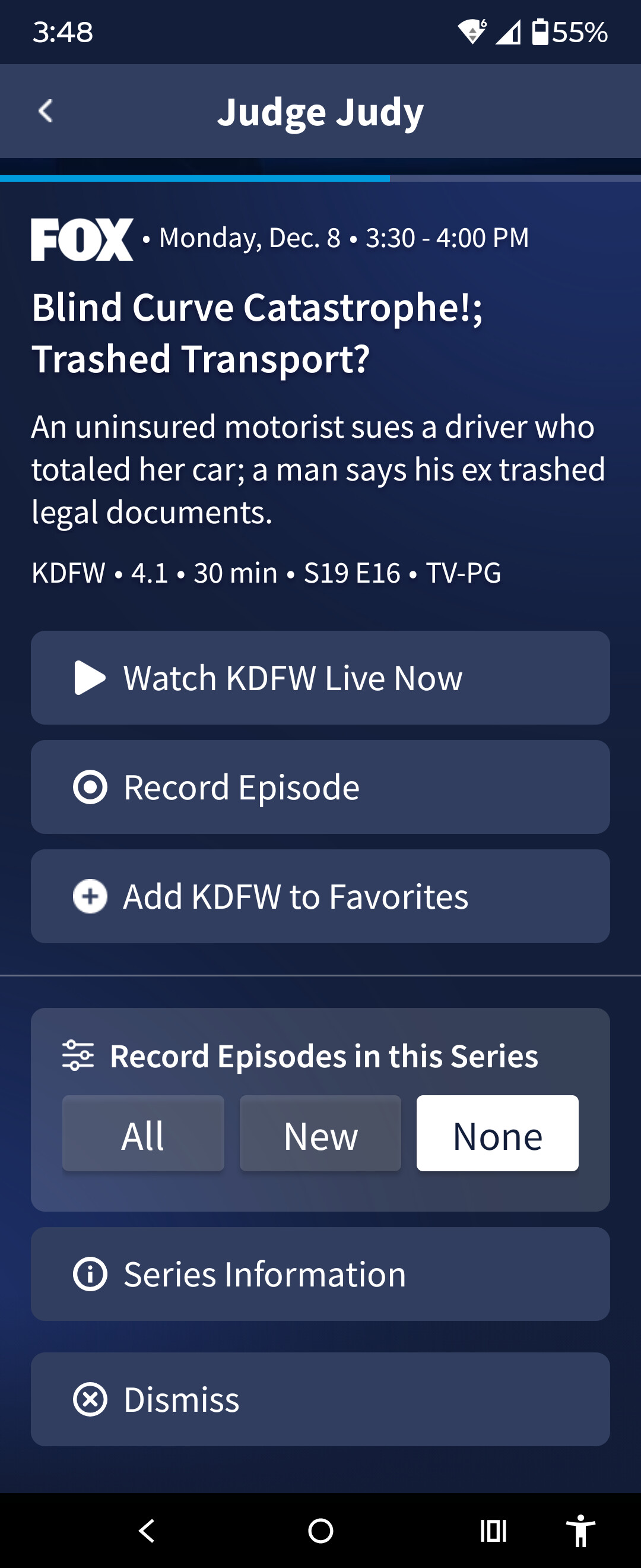

“I would like a new user setting established that allows the user to disable the “real time” recording”
To OP can’t you use the pop-up screen to cancel? I do.

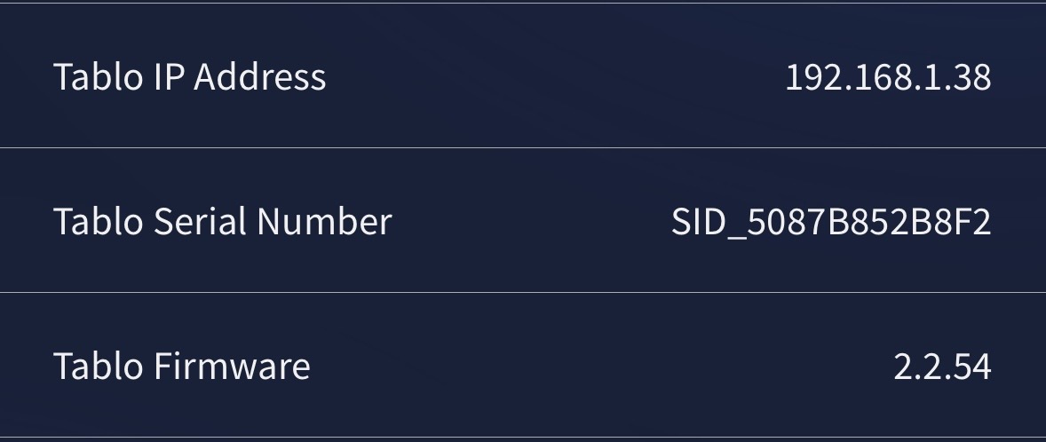

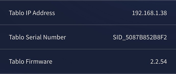

Hi Classic Rocker, (great handle!)
Can you please tell me
  • the SID of your Tablo ?
  • what is the version of the Tablo firmware?
  • does this happen only on some channels or on all channels?
  • what client device (and app version) are you using when you see this?
Thank you.

I have app version 2.0.4 on both Google TV and FireTV stick. Everything is up to date. I have a robust OTA TV setup, as well as a robust wired network for all-things Tablo. Internet is 500mbps fiber. There are no bottlenecks in that regard. I firmly believe this is a Tablo client software “feature”.
