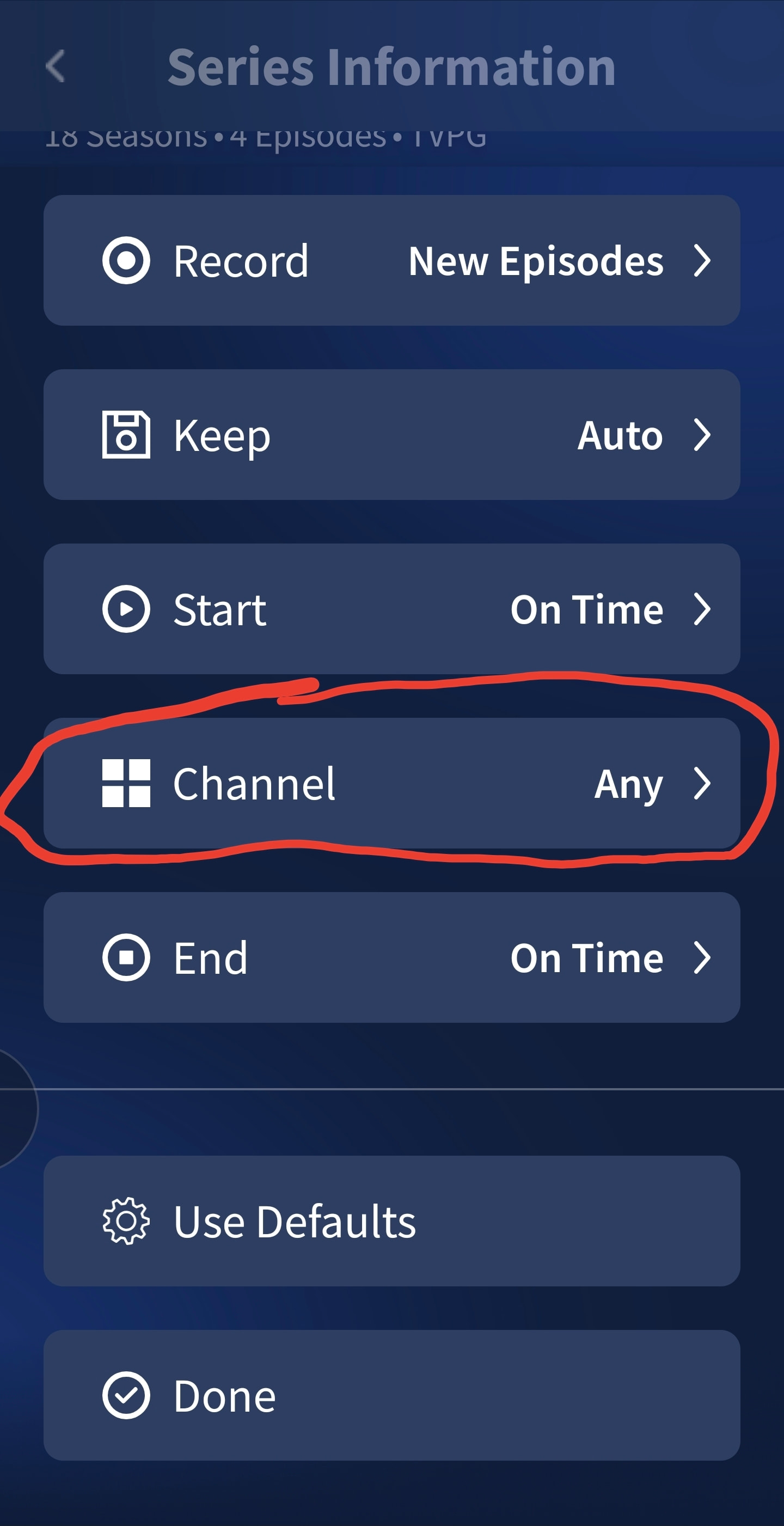

Make sure you have Channel set to “Any” in the Series Information recording settings, and not a specific channel.
