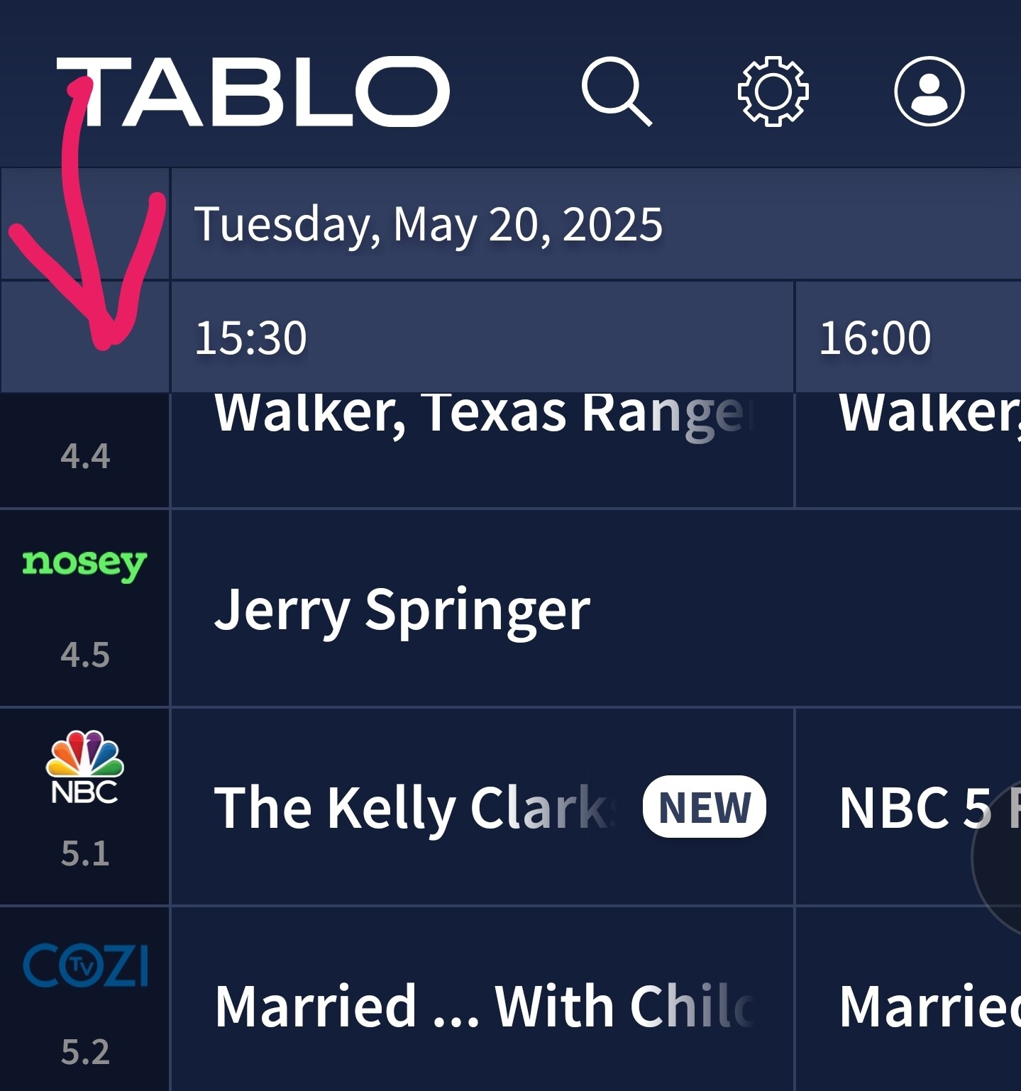

When I select a channel on the Tablo and choose to “Play Channel”, it only shows the current show and the stops. I have to manually select the next show on the channel. This is not the behaviour I have on other services.
Thanks for support helping me on this.
If you click on an entry in the first column, say, NBC 5.1, it will continue playing past the end of shows. However, selecting and playing The Kelly Clarkson Show will stop at the end of that show.
Thanks! That’s what I’ve been doing: going to the far left and selecting “Play Channel”. Still stops showing after the current episode.

Hey @jlknight56 - Live playback should continue UNLESS you are also recording what you’re watching OR you’re out of available tuners.
If you’re also recording what you’re watching live, the tuner will be released as the recording wraps up. This will end playback.
If you’re not recording what you’re watching, but a tuner is needed for scheduled recordings on another channel, playback will end so that can occur.
If neither of those things are occurring, it would be good to get a video of what you’re seeing.
