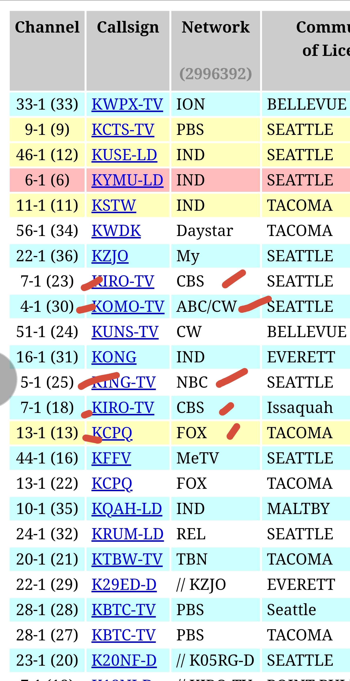

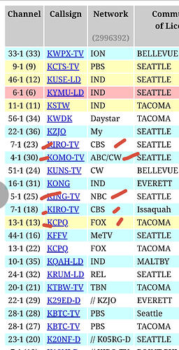

After checking RabbitEars.info, it appears that only FOX is HI-VHF. The number in parens() is the physical channel number.
My antenna is a ClearStream Max-XR - 60 mile range VHF/UHF Model C2MVXR
Based on the RE.info, this antenna should be able to receive the channels in your area. What is your distance from the tower(s)? ZIP Code? Recheck your cables, connections, and balun.

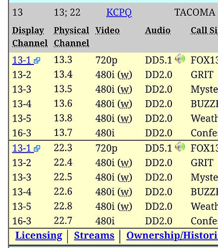

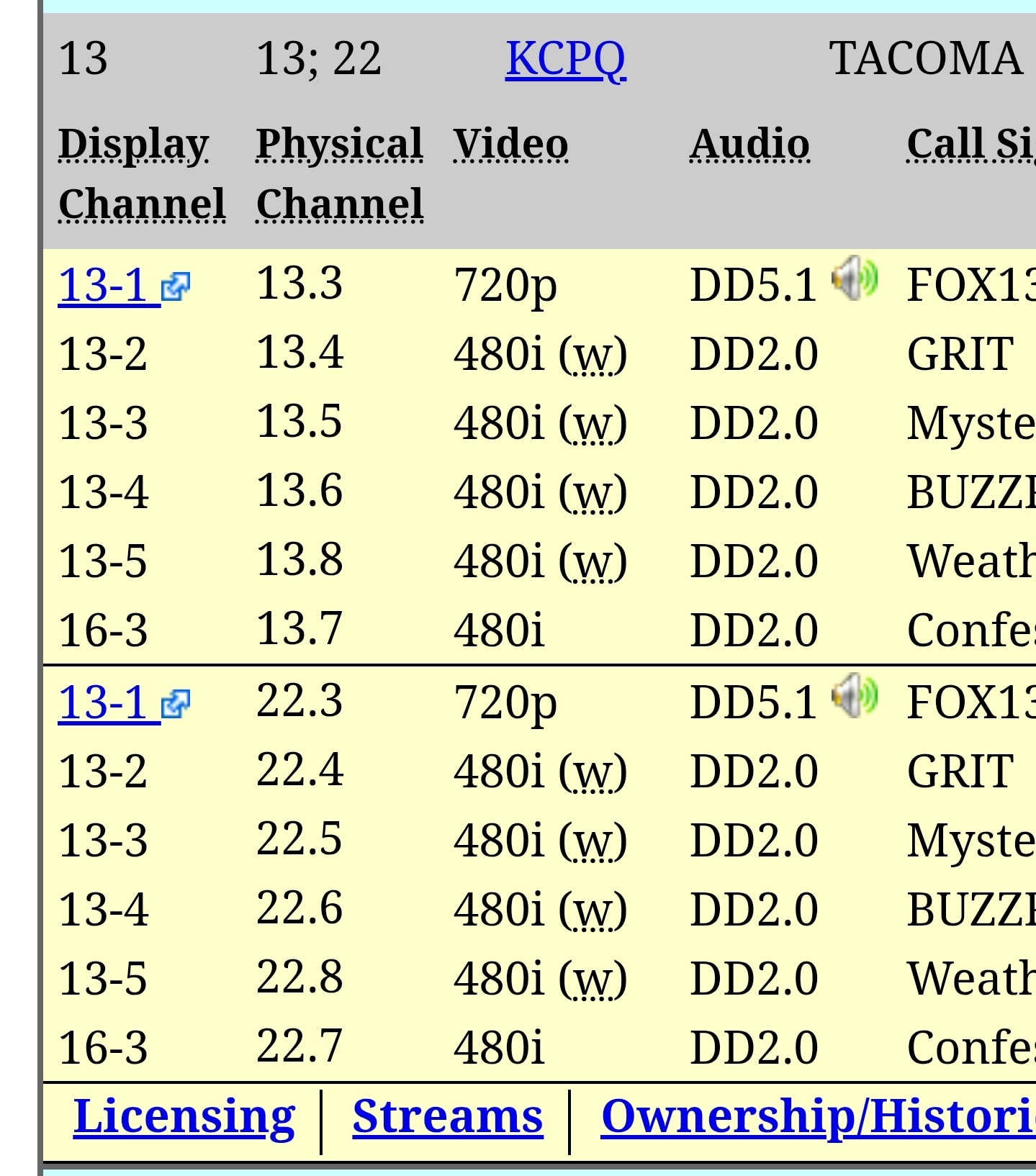

It appears that KCPQ is broadcast on 2 physical channels…13 and 22, so you might investigate how this could affect your signal.
The FOX tower is 30 miles away. I was able to pick FOX up on channel 22 on a rescan with the antenna amplifier on. Channel 22 has never shown up before while I used to be able to connect to 13. I’m not sure what happened but I will take it as a win.
