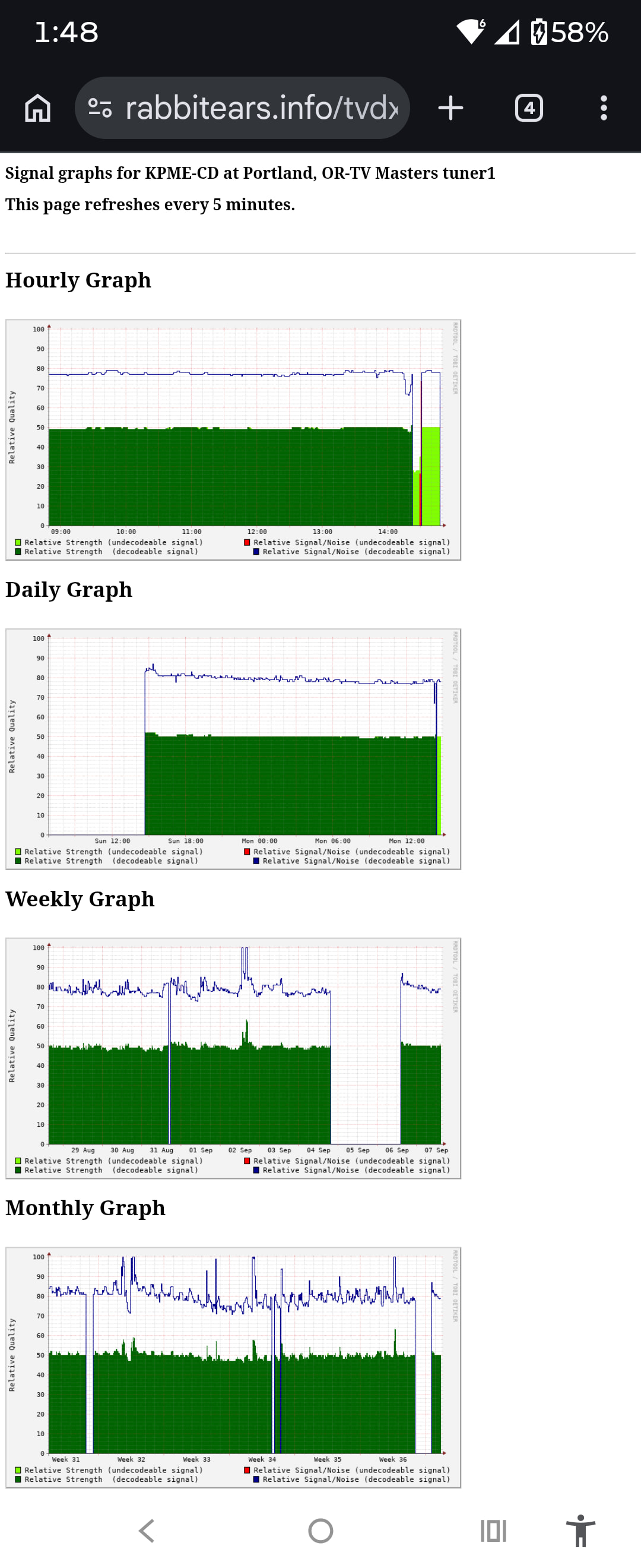

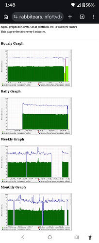

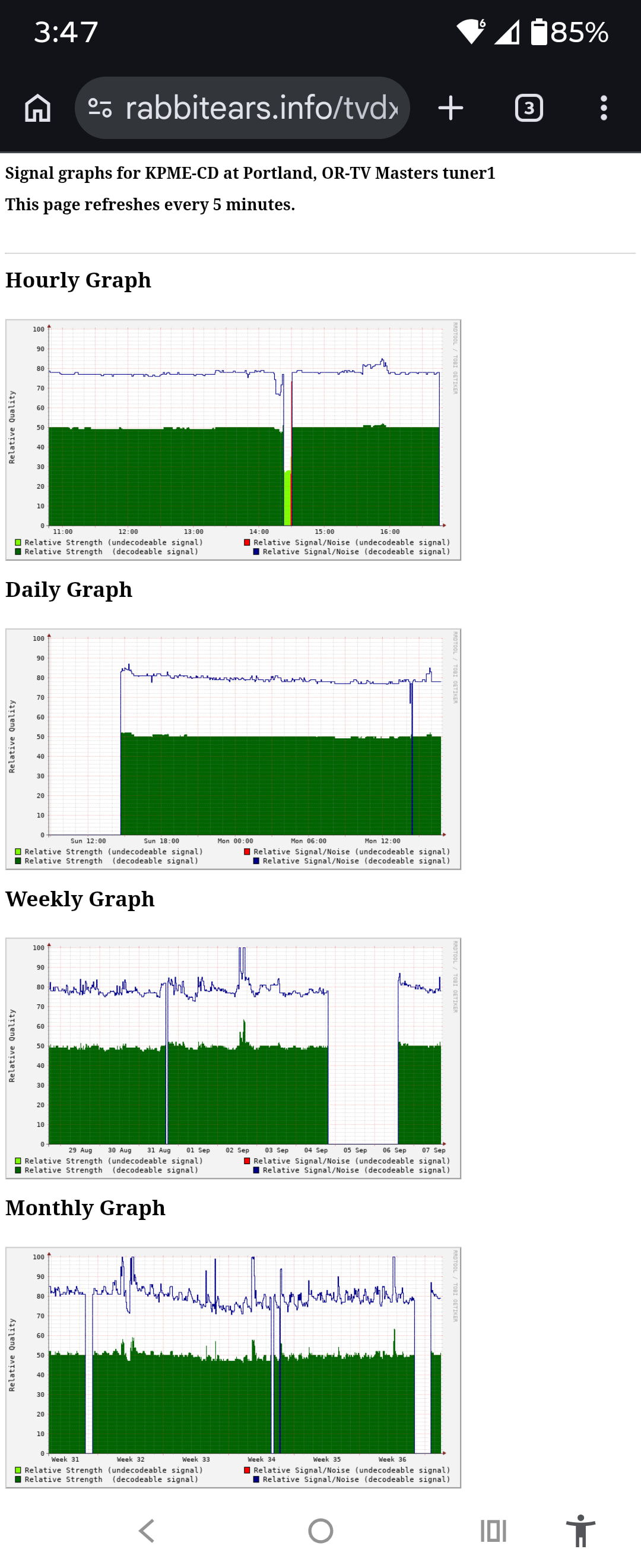

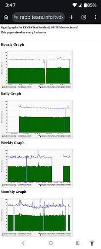

The bright green is noise. Static.
The blank space is nothingness. No signal at all.
Huh. According to the graph, yellow is relative strength undecodable signal, green is relative strength decodable signal.
They have a different meaning for decodable?

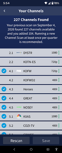

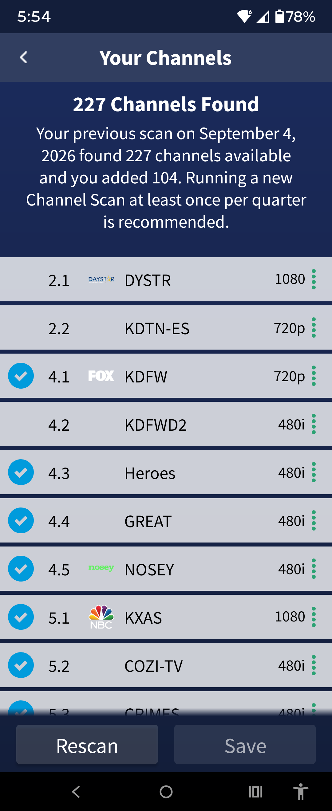

No, there is no indication of a channel on either of my two Tablos or my TV.

On the Hourly Graph for KPME, the green relative strength reaches ~50 and purple? relative signal/noise is ~80

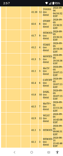

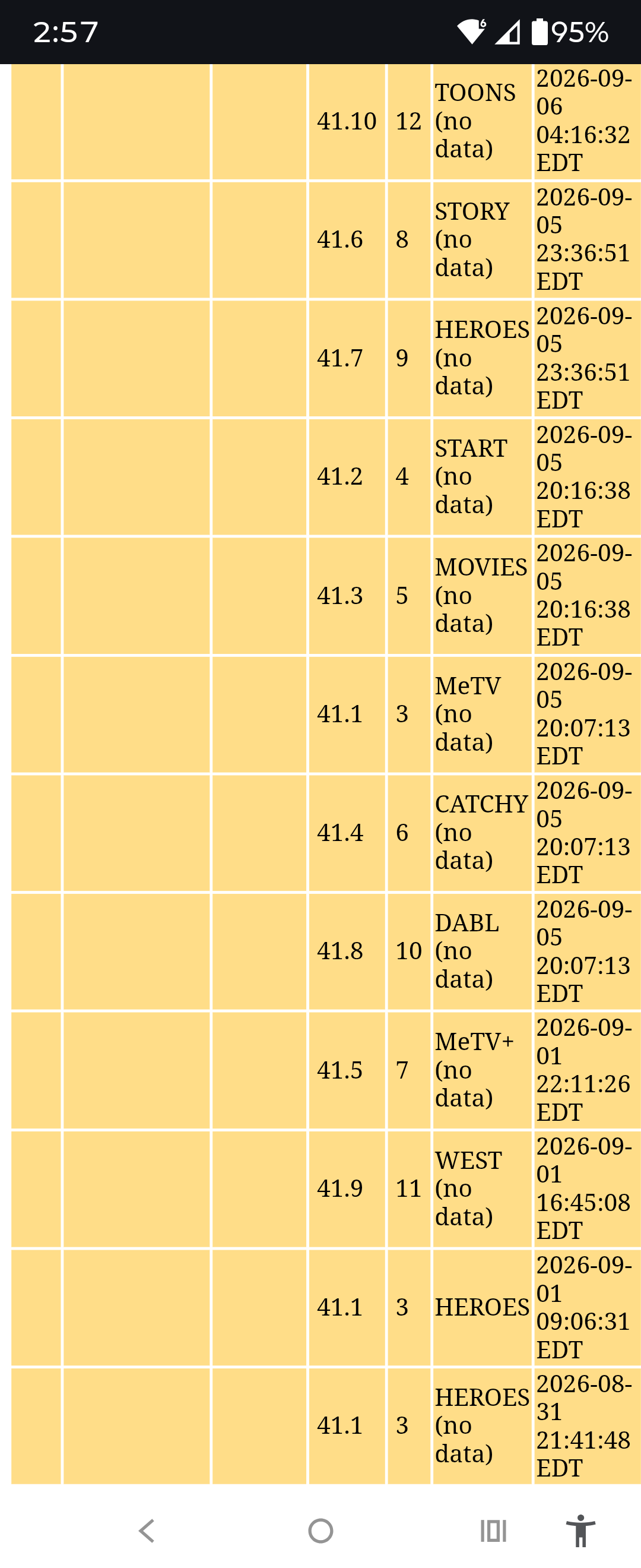

At times there can be a perfectly good carrier signal.
But no data on the signal. It’s unstable due to technical problems which I presume are being worked through.
They could need to replace some equipment which may or may not be on hand.
I know for a fact that Tablo ignores signal without data.

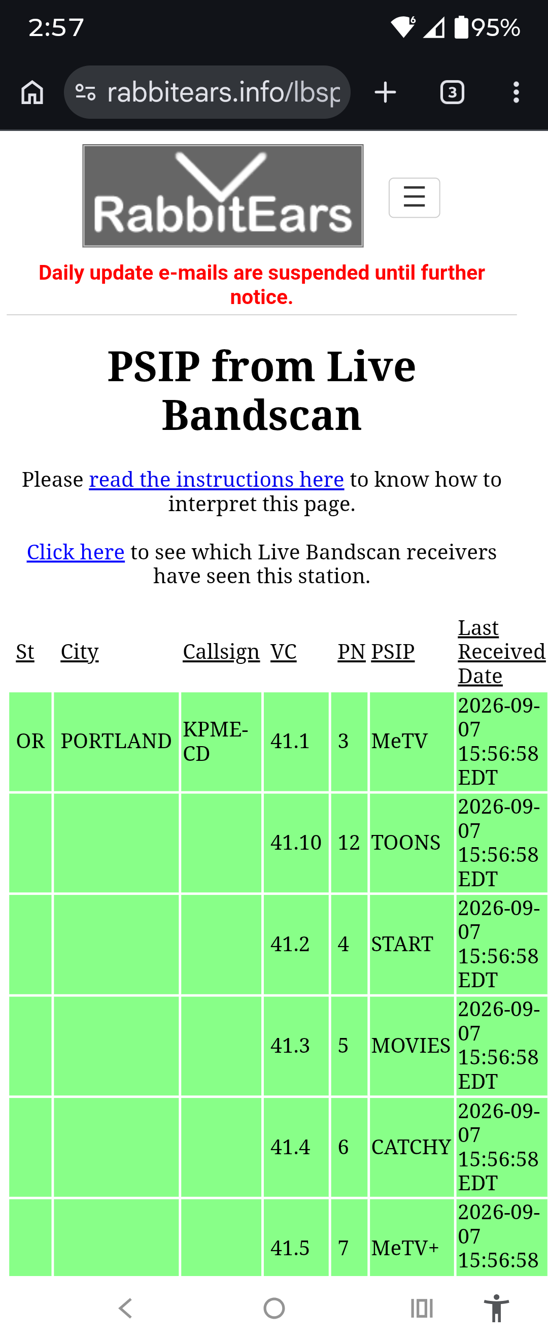

I just got confirmation on AVS Forum that folks are currently watching KPME-CD 41.
You may want to try a rescan now.

I just tried again on both Tablos and the TV itself and still no signal.
