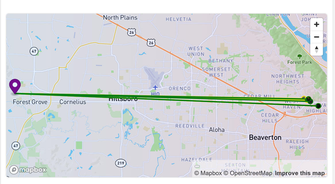

18.6m. From Antennaweb.org
Are you getting all the other channels marked “good” on this list?
My suggestion is to exchange that non-directional antenna for a directional one pointed east.
I get all except 16, 35, and 38 of the “good” channels. I also get 31 and 17 of the “fair”.
I replaced a directional antenna with the Omni, which gets the 31-1,2,3,4 and 17-1that I wasn’t getting before.
Rabbitears says 16 (rf 16) and 38 (rf 36) are off the air.
Don’t know if Rabbitears info for KORK-CD rf 35 is up to date. They show 41.1, Heroes & Icons, as one of its subchannels. That would conflict with 41.1 on KPME-CD rf 15.
Does your TV let you manually add stations? What happens if you try to manually add rf channel 15?

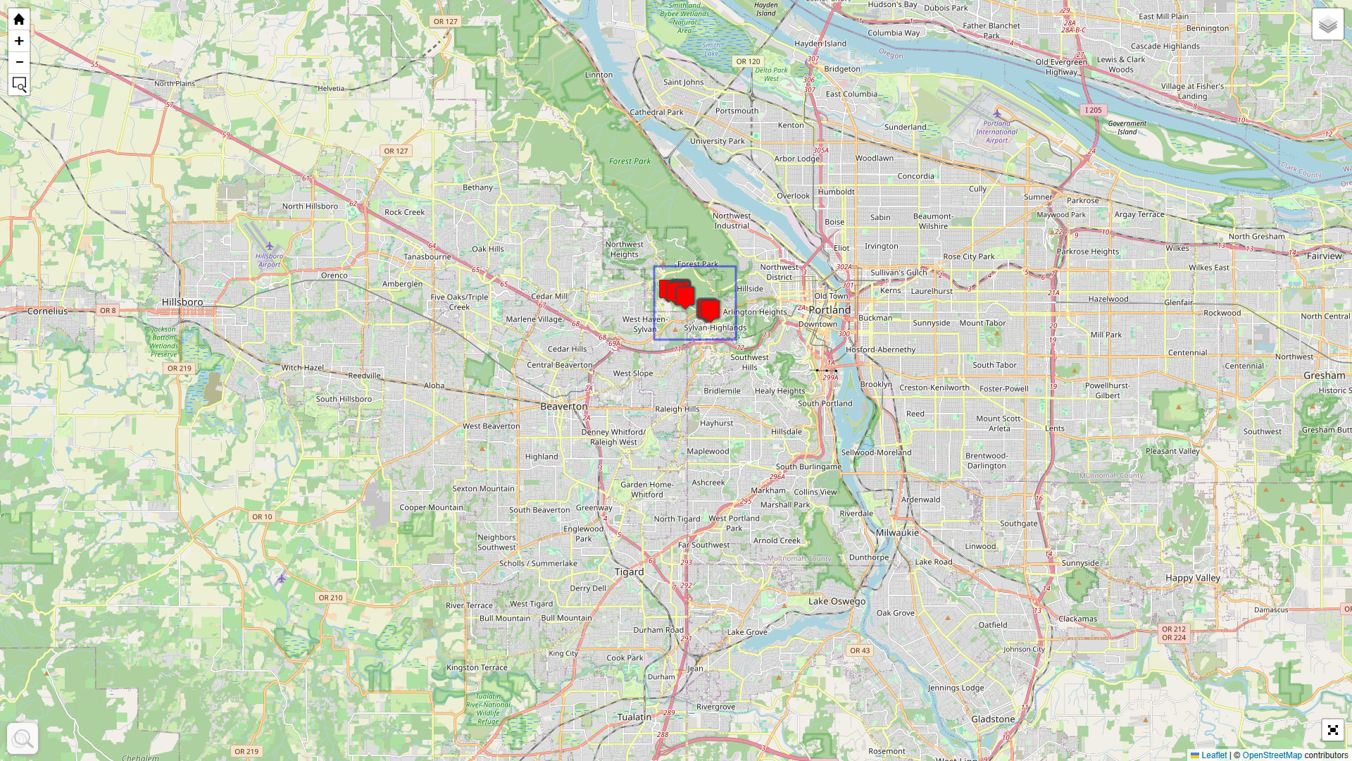

I am observing exactly what papagnome is experiencing.
I think we are in some type of “directional deadzone” for ch41.
I live in almost the exact same direction as papagnome from the tower
and only 5.2 miles away from the tower.
otadtv predicts I should have a -36dbM signal.
Also I get ch20 fine which is only 30ft higher on the same tower
and the same 15KW broadcast power.
Neither Tablo or my TV show any signs for receiving ch41.
I get all the other channels fine from the main towers on Skyline.
