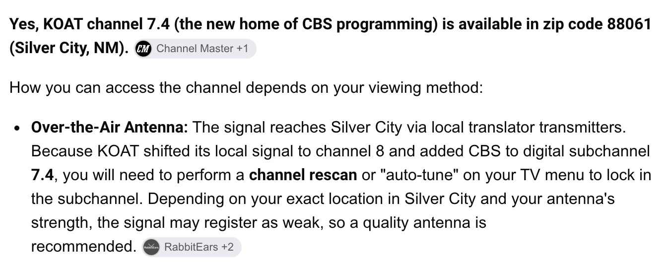

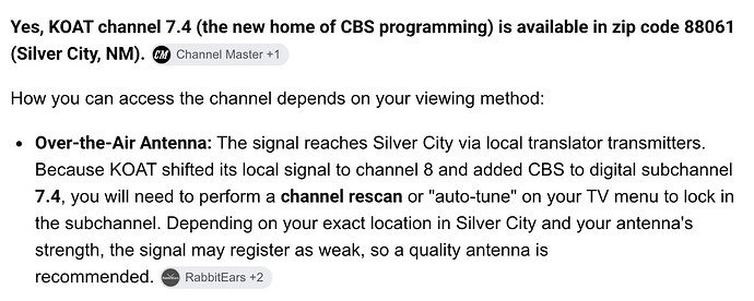

I asked AI and here’s what it said…

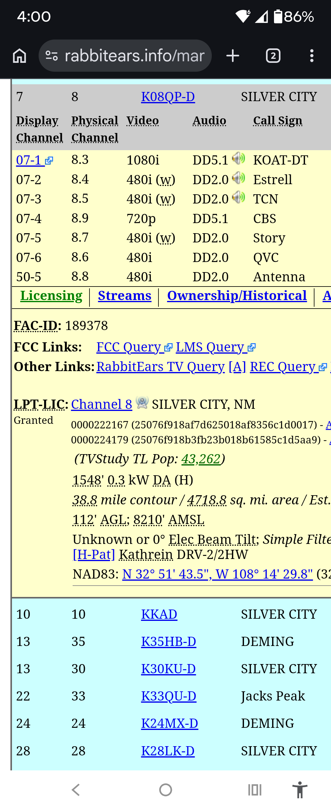

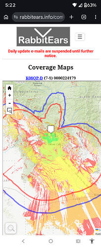

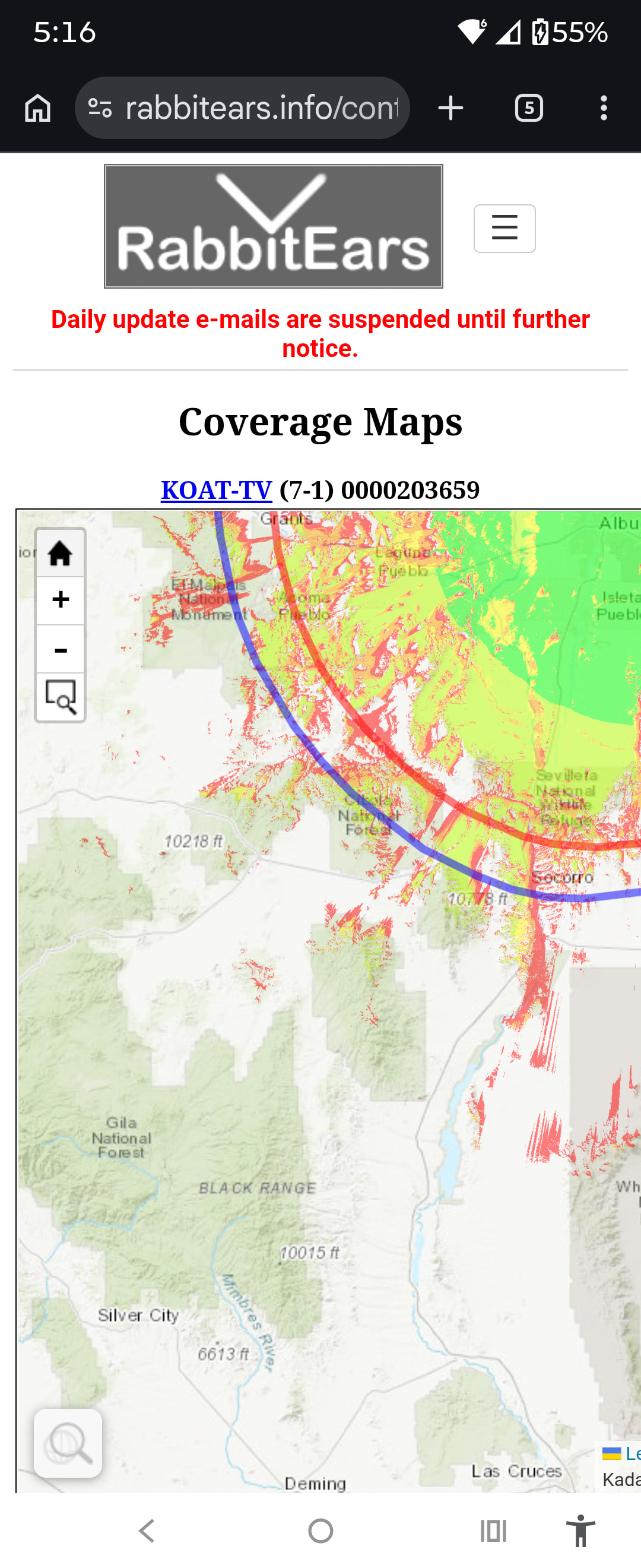

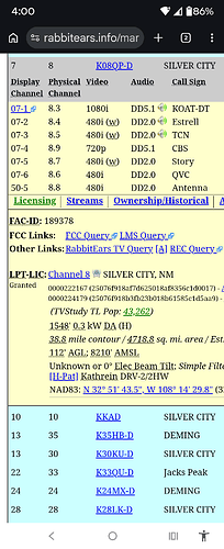

Rabbitears shows a ton of translators for KOAT. Is it possible Tablo is picking up more than one and using one for 7.1 and a different one for 7.4?
Another possibility is that most DVRs like tablo require that the PSIP data is all there and correct. TV’s don’t care very much. But I don’t if a gen 4 detects a channel under that situation but later can’t process the channel for play back. But tablo support could easily connect in to your device and tell what is happening.
And most TVs can tell you what audio format is in the stream plus SAP information.
KOAT 7.4 from Albuquerque wouldn’t be visible to your antenna. It’s northeast of your location.
K08QP is the translator used just north of Silver City.
Tablo Gen4 has poor tuner sensitivity and it also does some realtime decoding which I don’t understand but told it’s special. It also splits the signal by the number of tuners.
If you’re using the mudflap antenna it needs to be in line-of-site to the translator.

  1. The transmitter is 1548’ AGL
  2. Power is only .3kW
  3. Signal is VHF-HI RF8
Those mudflap antennae aren’t VHF friendly. If you get a signal it’s from the wires not the antenna.
VHF signals penetrate but ATSC 1 is prone to multipath interference. Reflected signal in mountainous region.
Depending upon your distance from the transmitter you may want to increase the antenna elevation to focus more on the signal rather than ground clutter.
Your precise location will determine if you are in a green zone or yellow or blind spot.

You are correct, my local transmitter is KO8QP-D, although in all guides and menus Tablo refers to that channel as 7.4 KOATCBS. My primary antenna for the last 2 years has been a multi-directional outdoor antenna mounted 12’ AGL with a direct line of sight to the transmitter which is less than 6 miles away. All channels come in at full strength and all sub-channels except 7.4 work without issue.
