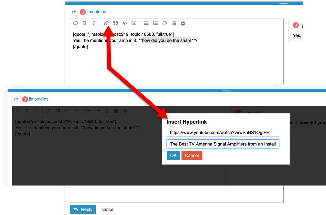

This is how:
  1. Click the LINK button when making a reply to open the Insert Hyperlink window.
  2. Copy and paste the link into the top field
  3. Optionally, add the link title to the bottom field.
  4. Click OK
I did it simply by right-mouse-button click and paste into text area of my reply.
Thank you, good to know. Jim

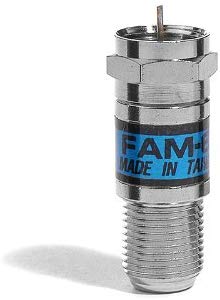

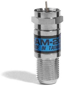

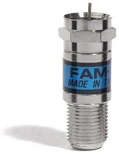

Today I received the 10db attenuator and installed it. I noticed a marked improvement. Didn’t see much of any stuttering or pixelation until Wheel of Fortune, and then only a couple very minor ones. I went ahead and added the 3db attenuator as well and now haven’t noticed any.
It appears that was my problem, that the pre-amp was just too strong and was overtuning the channels. I will keep watch for the next several days, but the difference between today and days prior is just amazing!
happy that worked. did you get thru amazon? what brand are they. Did you notice that when there are storms there are pixelation till they pass?
We only had some rain showers go through today, and I wasn’t able to check it out as I had to work. I’m not sure how my reception will be with a full blown thunderstorm.
They are both FAM brand, and I think the one missing in the mail somewhere is also a FAM.
At Amazon…
10db:
3db:
6db:
So I am currently reducing the signal by 13db from the 30db boost the ChannelMaster CM-7777 is feeding from my antenna; means I am ultimately boosting the signal 30db - 13db = 17db
