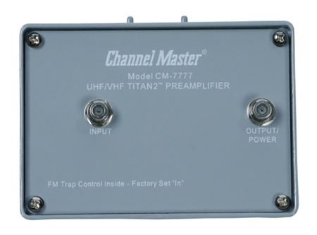

When they installed my antenna they also installed on the antenna pole a ChannelMaster CM-7777. Too high up for me to reach even with my 6-foot step ladder. I don’t think I can just unplug the power supply as I’ve heard many (most?) pre-amplifiers will end up blocking the signal if power is cut to them.
I can see the use of a pre-amplifier if the signal is weak, but perhaps the approximate 30db this unit is supposed to boost the signal is sending me over the edge? That is why I ordered the 3db, 6db, and 10db attenuators. I figure if I am overtuning I can maybe drop them slightly and still get the benefits of amplification that I wouldn’t get if no amplifier. And then there is that issue with can I just cut power. I did try just unplugging the CM-7777 power supply but then I lost all channels; due to CM-7777 not passing through un-amplified signal, or too weak a signal?

I guess this pre-amp is pretty hefty, boosting the signal some 30db. The boost can also include cell LTE, but not sure that is my problem. I do have an LTE filter though so I can try it.
It says, “…is ideal for installations in which all broadcast towers are located at a distance of more than 80 miles.”
So being within 60 miles just might make it too strong for the better received channels, and like I said Tablo Engineering checked my Tablo channels and said they were mostly all at 100 which means they could be higher and resulting in overtuning.

Maybe that is the difference. If your amp is not as strong as the one they installed on my antenna, then perhaps I could be overtuning?
Looking at WInegard’s web page I see two amps on their main home page; the LNA-100 boosts 20db and the LNA-200 boosts 18db. My ChannelMaster is boosting 30db.
