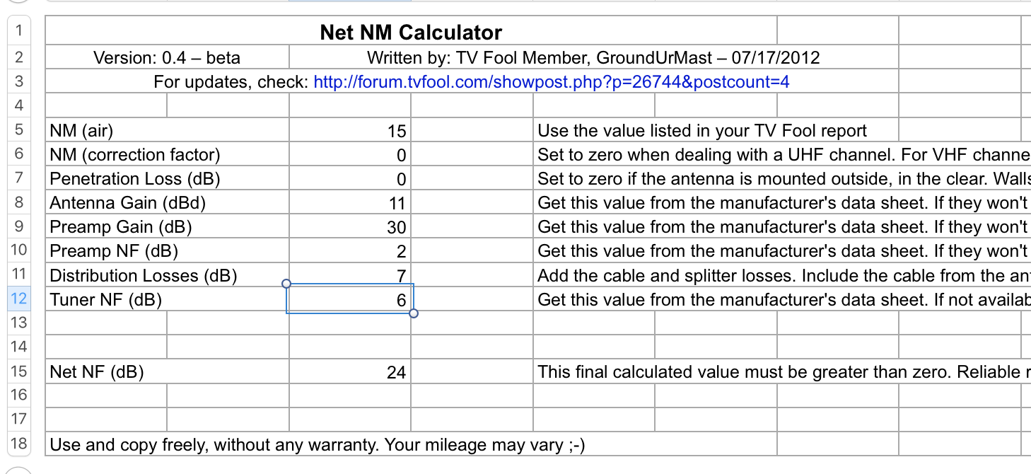

  1. After running a TVFool reception report, pay attention to the NM (noise margin) number reported for the channels that you’re interested in receiving. That value MUST be over “zero” for reception, and for reliable reception, should be above +15.
  2. Build an insertion loss budget worksheet. Essentially, calculate the amount of signal loss (in dB) along the path from your antenna to the tuner. This should include:
    a.)the loss at the balun (matching transformer)
    b.)the loss from the coax cables (there are tables on-line that will show you the dB loss per 100 ft of RG-6) which include the down-lead from the antenna to the pre-amp, the drops from the pre-amp to the tuner
    c.)the insertion loss at each splitter port in the path of the signal (that is, the loss through one port of the splitter- although a three way splitter will have a higher loss at each port than a two way splitter
    d.) the insertion loss from any barrel connectors, cable joiners, or wall plugs (typically -0.5 dB each)
    e.) the insertion loss from any attenuators installed
    f.) insertion losses from lightning arrestors installed
    g.)Noise factor created by the pre-amp and/or distribution amplifier
You should also have at hand
h.) the gain, at frequency, from the antenna
i.) gains from pre-amplifier and/or distribution amplifier
3.) With those figures at hand, plug them into the spreadsheet posted on this link:
net noise margin calculator
Once you have the Net Margin, evaluate the result, and play some what-if scenarios, removing the preamp from the model, adding attenuators, etc. A noise margin number over 70dB is significantly overloaded, and 60-70dB are possible overload candidates. Net Noise margins from 40-60 dB will typically not need amplification.
It’s just my perspective, but a +30 dB preamp invites significant signal overload.
Finally, take a look at your coax plant. Terminate all open ports. Torque down coax connectors on non-electronic devices to 20 inch-pounds (10 inch-pounds for connections to set top boxes, Tablo DVR’s, televisions, etc). Replace any coax where the shielding is split or exposed. Waterproof outdoor connections to the best of your ability. All of that is just best practice for creating reliable reception.
As a very rough, but still close estimate, I come up with a Net NF of 24db w=for WESH, which is the weaker of the major channels at 15.1 NM per tvfool.
It’s just as important, if not more so, to check the strongest station in the antenna beam direction, as that’s where an overload condition is more likely to occur. Spurious secondary signals from an overload can cause problems not just with the desired channel, but peripheral station reception problems as well, dependent upon the selectivity/sensitivity of the tuner.
Removing the preamp gain and associated NF leaves a Net Noise Margin of 13 dB (NM(air) + Antenna Gain - Distribution Losses - Tuner NF). That’s on the borderline of reliable, but also shows that a 30 dB gain preamp is overkill for even the weakest station. A smaller distribution amp (carefully selected to overcome downstream loss) would be more suitable in this environment.

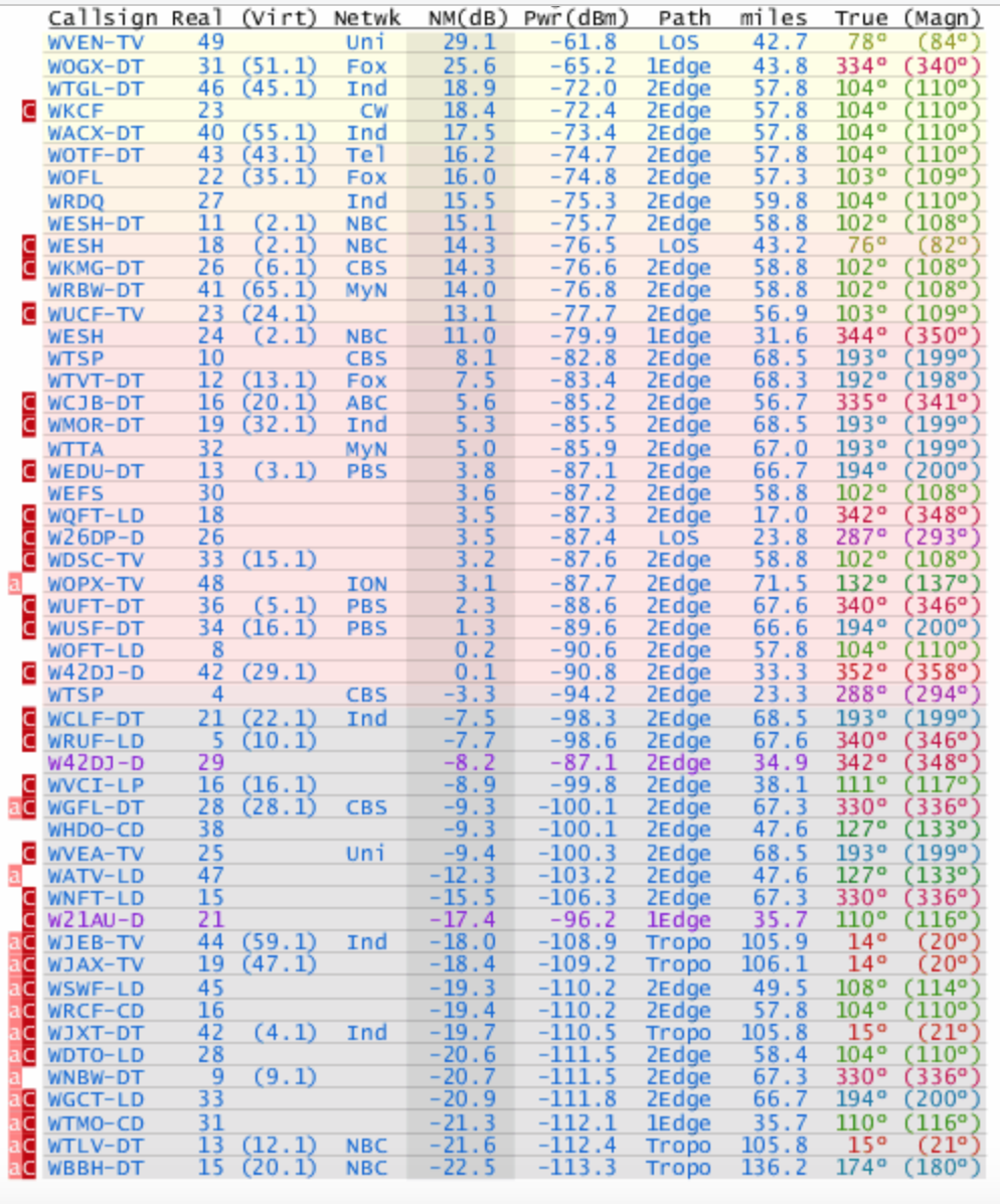

I guess it depends on what we consider is the weakest signal. The strongest signal coming from the direction my antenna is pointing is NM=18.9, which I do not include in my desired channels; I’m sure that doesn’t matter though that I do not include it.
The highest NM for a channel I include is FOX, Channel 35.1, at NM=16. Here are the results from tvfool:

My confidence in the results from tvfool are not very high right now. I am not even seeing ABC, channel 9.1 WFTV, in the results for my address. I live in a very new area, my house was only completed last September, so I wonder if it is even using the correct location?
I don’t think tv fool is correct. They have me mostly in gray area, but I am not tech enough to figure it out. also want to let you know WESH is saying there doing ota antenna changes on June 10th. We will need to rescan, there site says.I hope its for the better, don’t know.

Not to be vague or misleading, but the answer to using attenuators and the preamp is “yes and no.” The amplifier is making up for the downstream loss- in other words, the distribution losses and insertion (splitter) losses are cancelled out by the amplifier. If you add the attenuation loss into the distribution loss figure in your worksheet (from 7 to 20) you’ll note that the Net NM doesn’t change.
Given the TVfool report, I don’t think overload is necessarily the issue, assuming your loss budget is correct. The improvement you observed after installing the attenuators may be coincidental.
