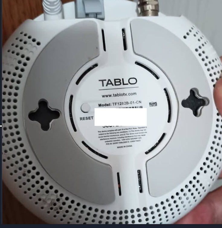

Since all the air holes are on the bottom of the device, has anyone run with the Tablo upside down so all the air holes are facing up?
Does anyone know which holes are the intake and which are the exhaust? Thinking of getting fan. No point in blowing fresh air into the output. I’m guessing the large slits are the exhaust and the small holes intake?

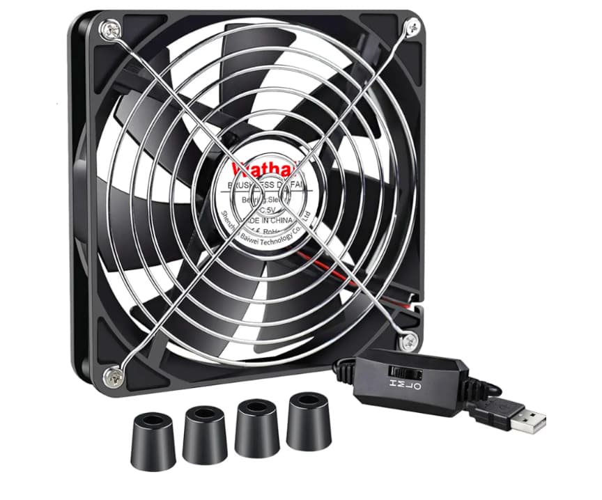

My Tablo sits on top of this fan, running at slow speed, with airflow directed towards the bottom vents/intakes. I have not seen any issues with heat since doing this, but I would also be interested to know more about air flow within the system.
Amazon.com
