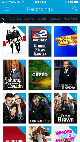

The new release today (1/19/17) no longer sorts all recordings correctly. it also freezes.
Rather than present the shows in alphabetical order, the sort now presents some mixed up combination of recent recordings and partially alphabetized recordings.

Same recordings as in screen shot above but now properly sorted:

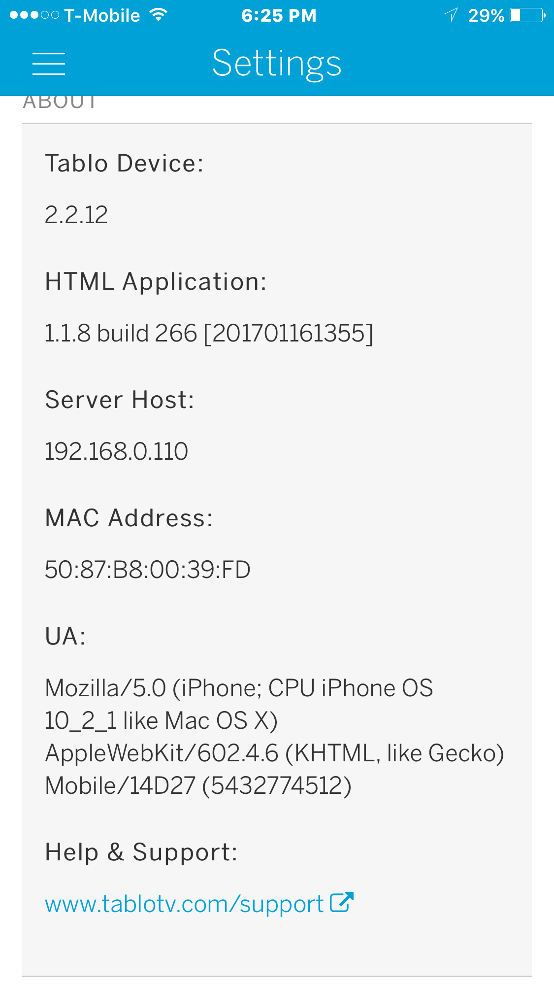

@RetiredEngineer Your Tablo’s on 2.2.12 - correct? Any chance you can post a screenshot of the Settings screen from the iPhone app? Just wanna take a look at the version and build number posted at the bottom. We’ve tested this here with the same published apps but have been unable to reproduce thus far.
Edit: Just saw your post above. Keep us posted!
emphasized text[quote=“TabloSupport, post:8, topic:10596, full:true”]
[/quote]

You probably do not need this now, but I am including the information you previously requested. Please see below.
