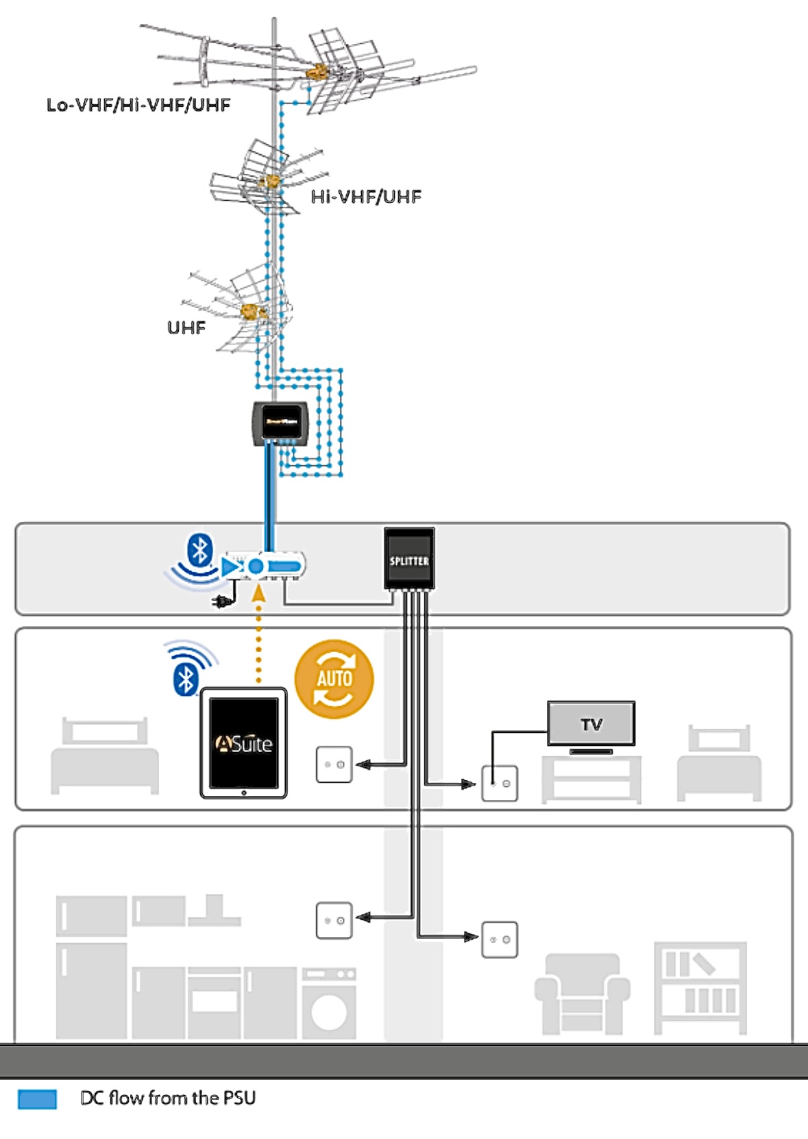

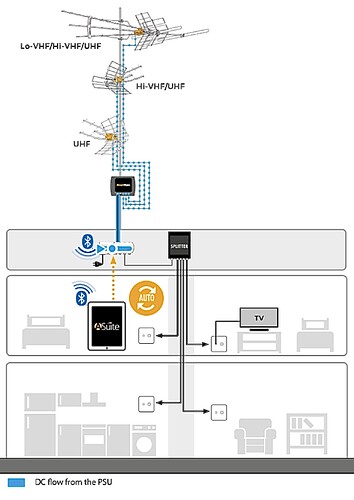

Just to be clear, the advantages of this would be that I could feed up to four tuners (two on a Tablo and two television sets, for instance) each picking up a channel from one of 3 antennas. I could get stations from 3 separate directions without using a rotor.
The setup would have me buy two additional antennas, the SmartKom, mount a mast without my rotor, but sufficient to hold the three antennas? (My memory from reading long ago is that the antennas should be separated by some distance to prevent interference. Is that right?) Based on the picture, on the mast, I’d run coax from each antenna to a mast mounted SmartKom 531981, and then coax into the house to another unit which interacts using Bluetooth, and that to a splitter to the 4 tuners?
Is this actually three boxes, the combiner preamp, a controller, and a splitter?
There are five coax connectors on the antenna combiner. Three antennas, RF out to the house, and a separate power?
If I remember, my amplifier is two parts. There’s a unit above the ceiling in the basement, plugged into the AC which sends power to the unit on the roof and gets back the RF from the roof. Does “remove the last amplifier” mean I should pull both of those units out of the connection, I go directly from the antenna to the first splitter as just coax?
