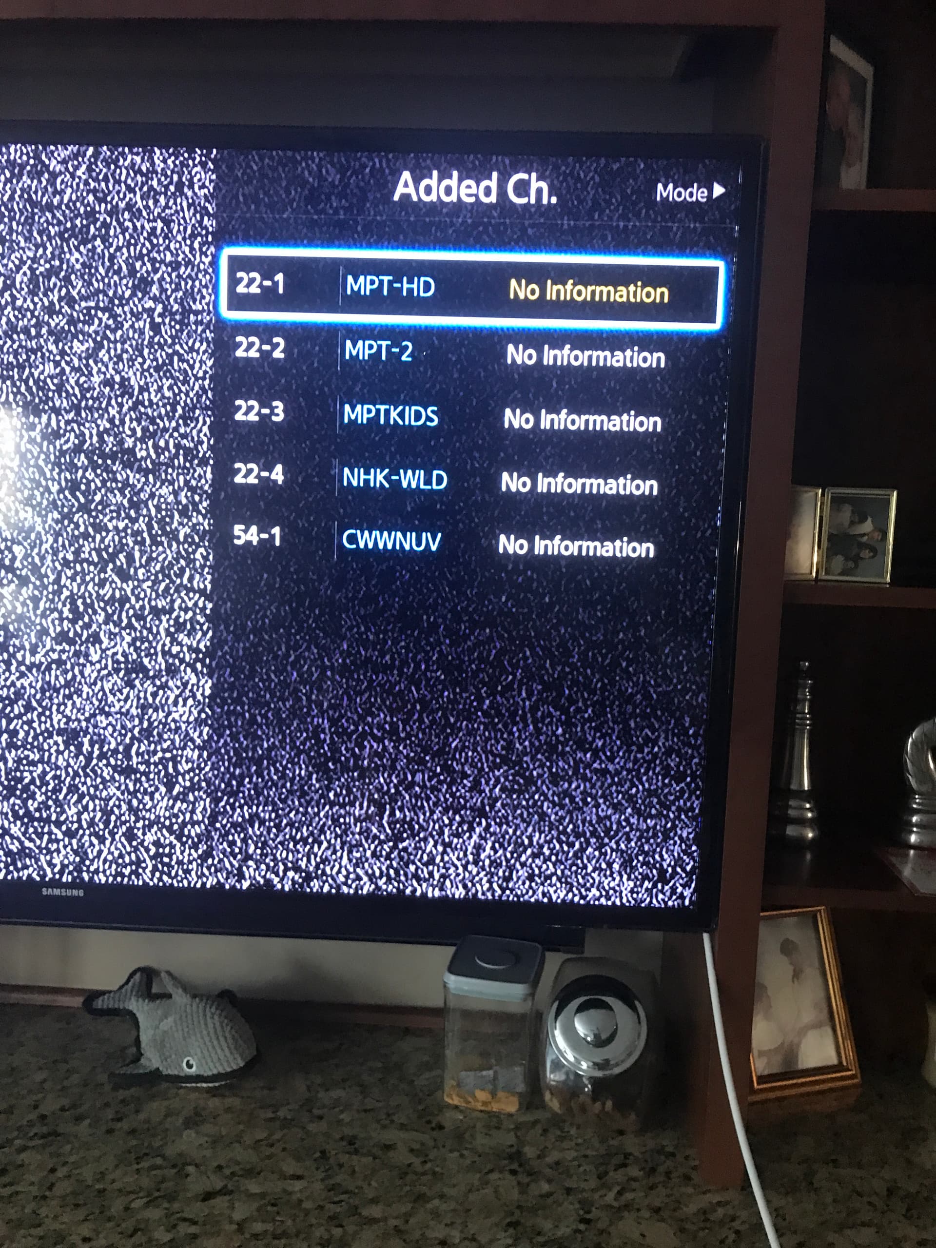

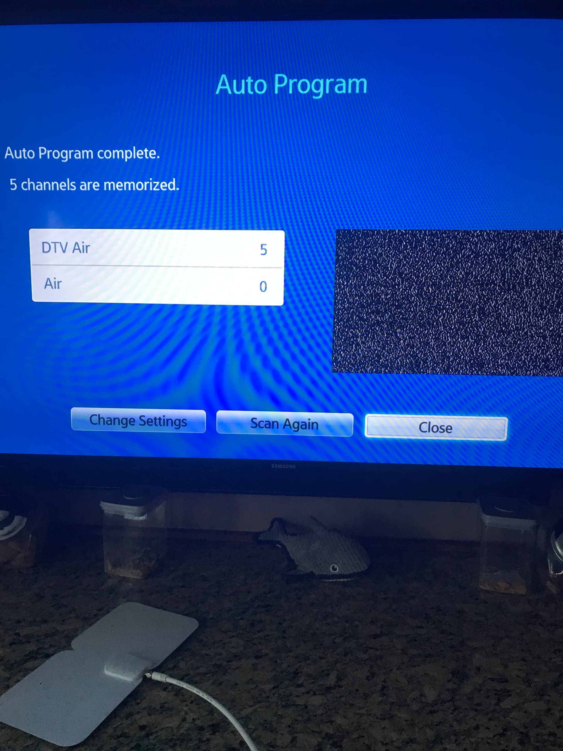

I went to the cw channel and it is very choppy.
When I go to any of the 5 channels they are very choppy and end up freezing.
You are going to need “bigger boat”. (Jaws ref). Seriously, the choppiness you see is an indication you don’t have enough antenna for the tv signal levels available at your location.
The good news is, there are tv signals where you are. It’s just going to take a bit more effort to take advantage of them.

I don’t think you are understanding the “free local channels” tech involved. It has nothing to do with the internet or modern streaming. The Tablo has internal tuners that decode “free” local tv channels that are being broadcast over-the-air in your area from local transmitters on towers. The first step in taking advantage of this is to capture these signals with an appropriate antenna so the Tablo internal tuners can decode them. Only after this happens successfully can the Tablo then “stream” the content over your network to your TV (FireTV stick) streaming device.
How far are you from your local TV station towers?
As @ClassicRockGuy said, you probably need a bigger antenna.
On the roof would be best, but maybe no feasible in you situation.
