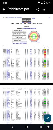

There is a website called Rabbitears.info that is very helpful to determine what transmitters and channels are available in your area. It also helps determine where they are located, and what signal levels you can expect at your specific location

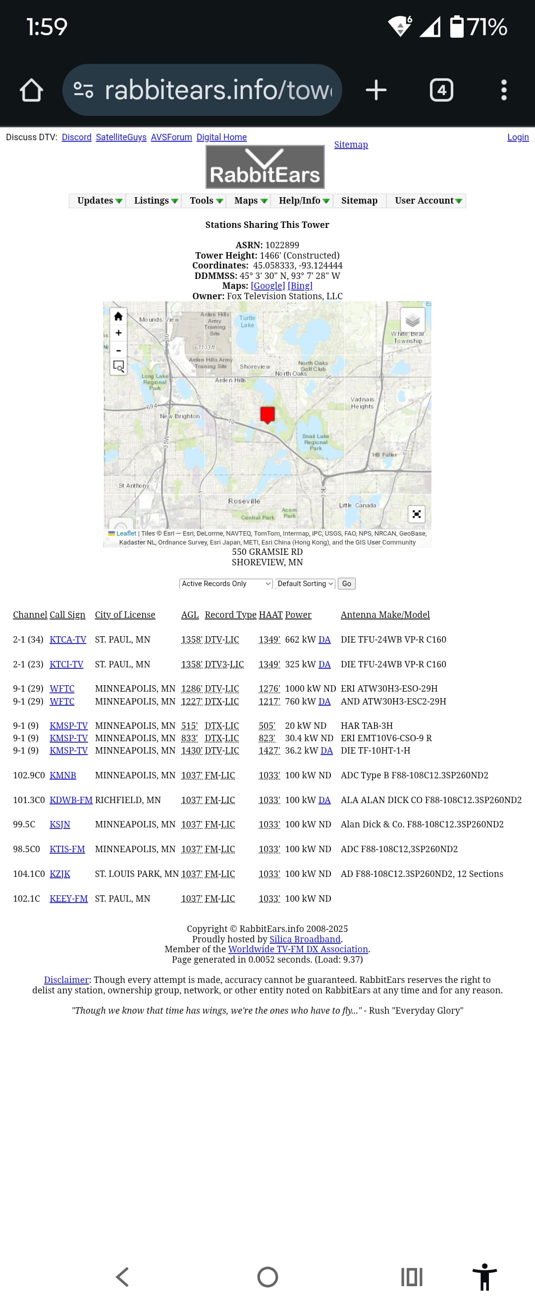

Try getting the antenna in the direction of the Mounds View area. That TV tower has several OTA stations.

Maybe this helps …

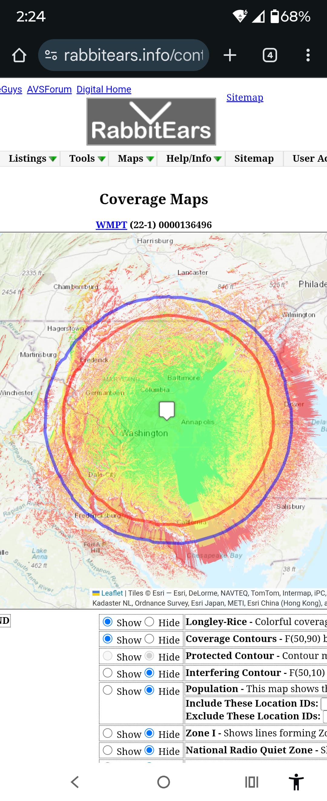

Here is a map from downtown Baltimore with the different directions some stations transmit from.

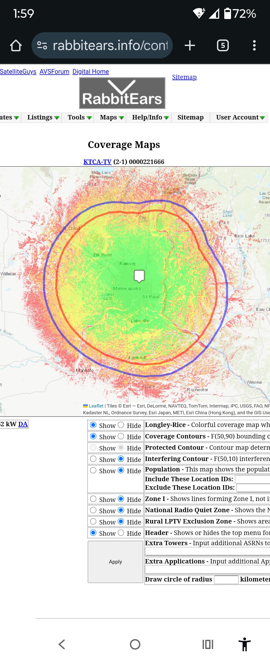

Run the rabbitears.info scan at YOUR precise location and post the map and channels here. You may just be in a lousy reception area. I’m in one also and have had to go to 8-bay bowtie/reflector and real smart (Televes) antennas to get the local channels. The little flat antenna that comes with the Tablo is pretty worthless unless you live under a tower.

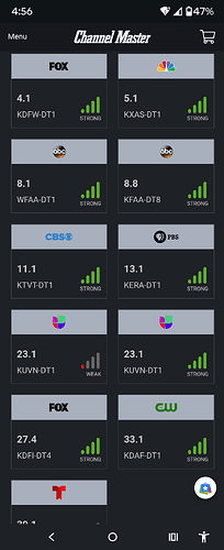

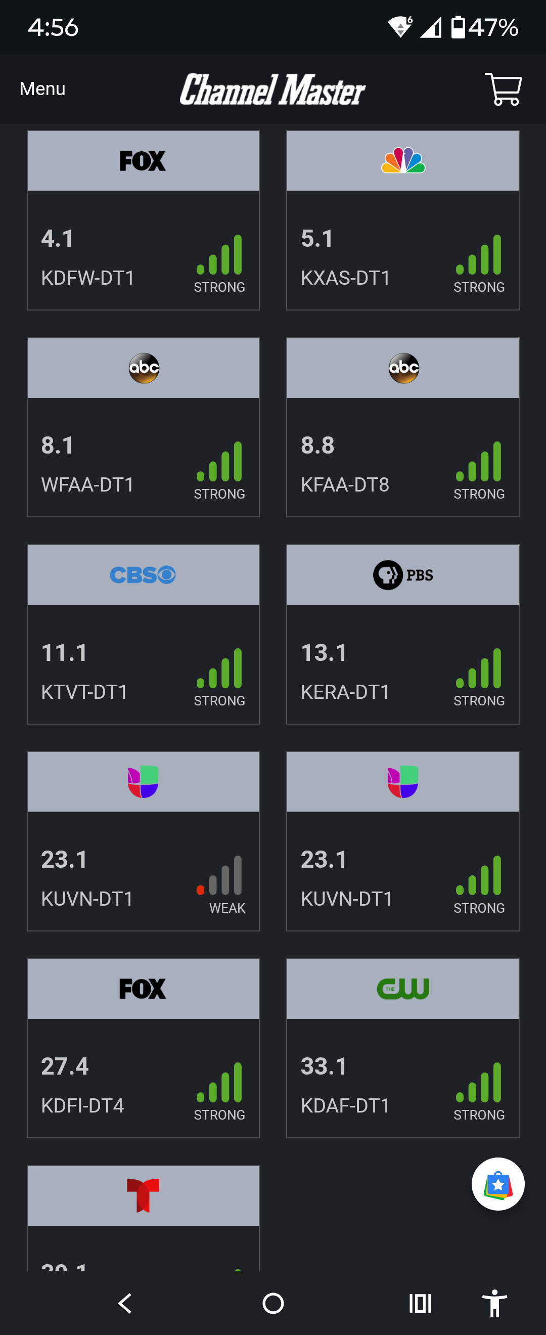

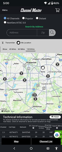

To me it seems the channelmaster channel search under discover menu yields more understandable results. It gives virtual and physical channel, direction, distance, and signal strength
My goodness you’re correct about it being readable.

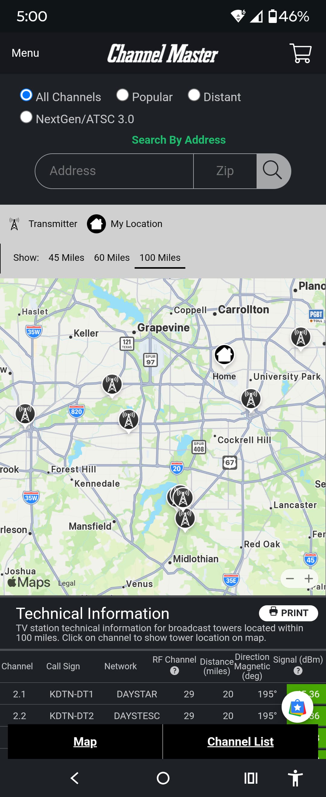

Map is cool.

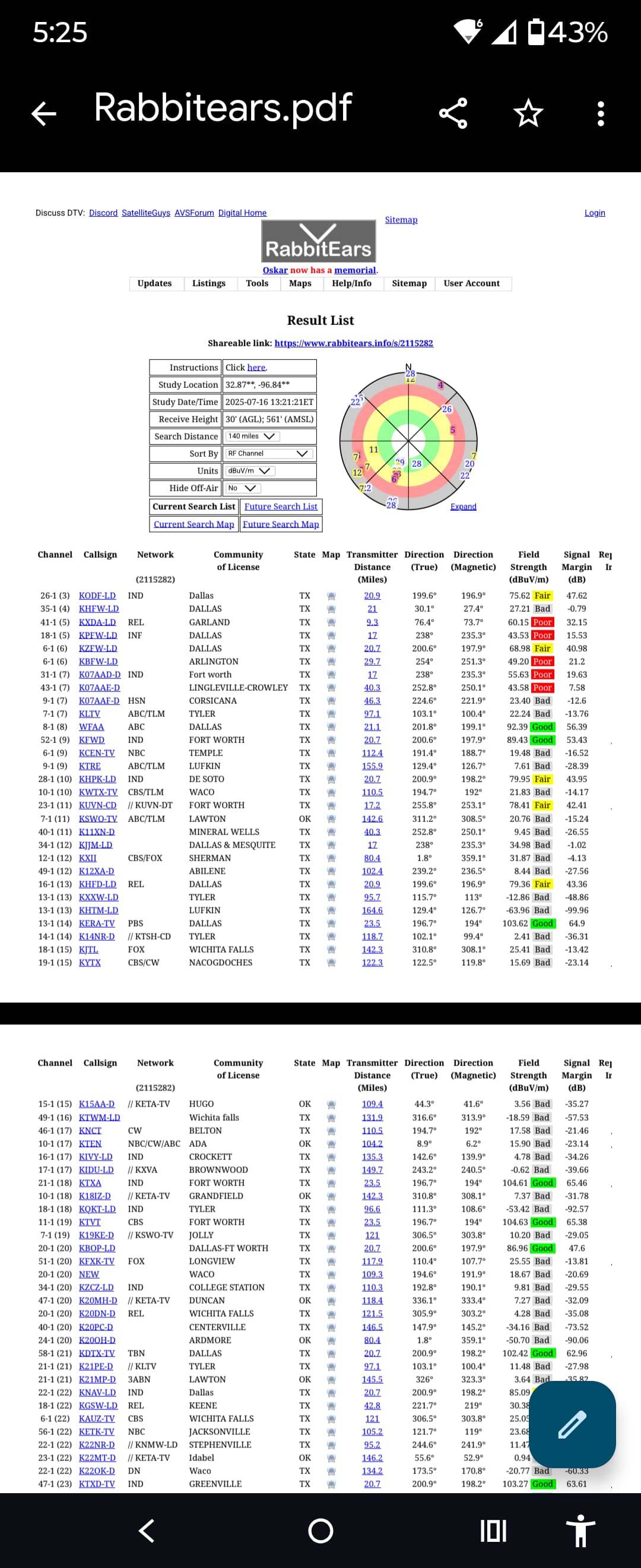

Of 149 channels available for my zip code it displays eleven. I found the button to display them all.
Hmmm… My iphone ChannelMaster app looks nothing like that (?)

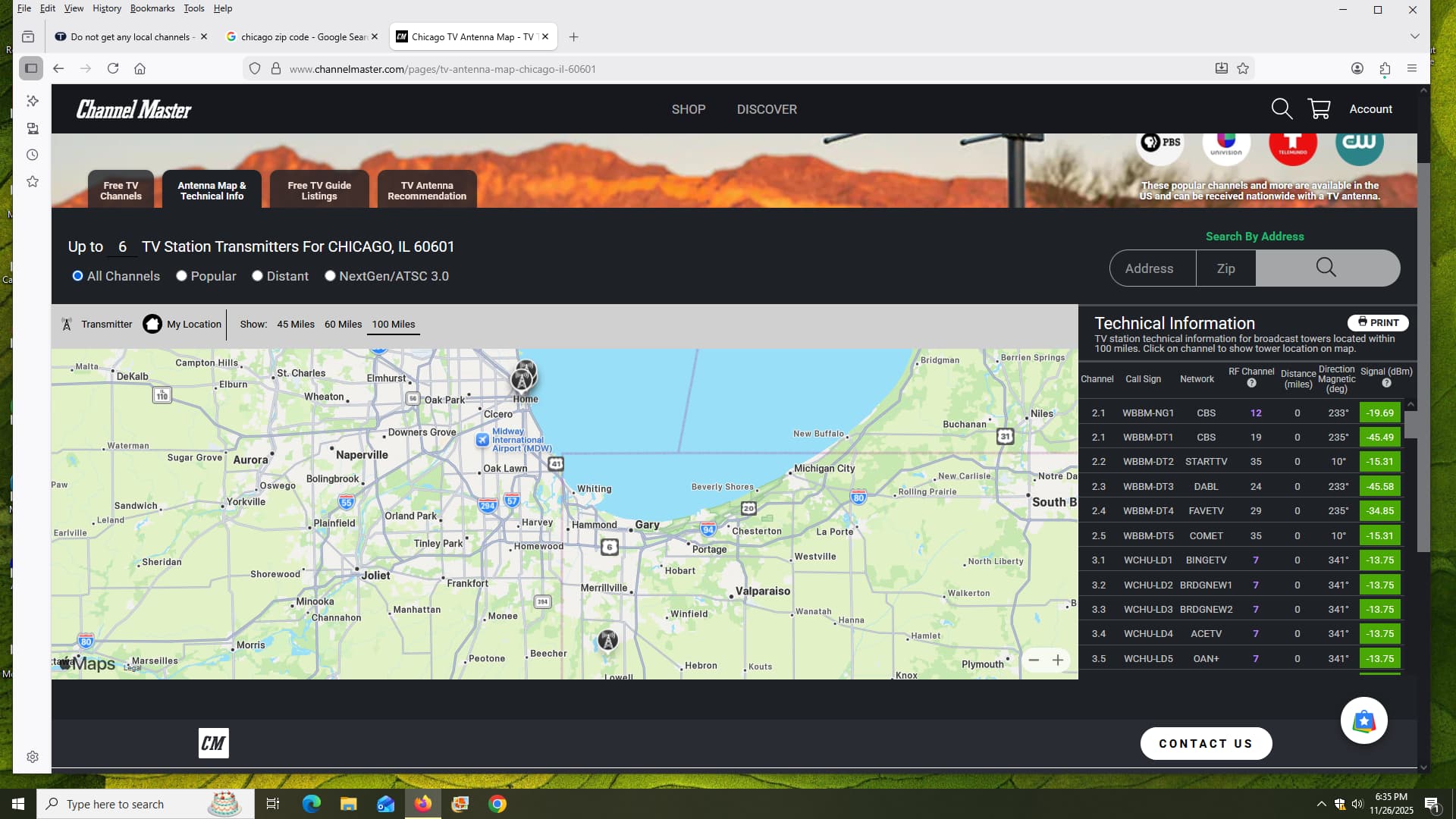

Chicago
Just for grins, both Rabbitears.info and the ChannelMaster website tool show virtually nothing available in my specific area. Both show transmitter locations etc, but report signal levels so low (red or whatever) so as to not be useable.
My “real” experience with a good quality antenna (Televes Ellipse Mix) located within the HOA 6’ height limitation above my one-story roof is I can get good quality signals from both local antenna farms. Further, the transmitter database details on Rabbitears.info are incorrect for at least 2 transmitters as there have been changes in the last 2-3 years that are not reflected even today.
I still think these are useful tools to get started with a new OTA installation. Just providing a heads up that they are not always 100% accurate.

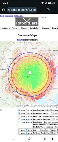

Do you think the signal strength provided is based on the very specific equipment you have installed.
TV reception signal strength numbers on maps are derived from computer models that combine transmission data from broadcast towers with terrain information, typically using a standard propagation model that assumes a specific antenna height. These models calculate the predicted signal strength, often measured in decibels (dBuV), and then represent this data visually on a map, though actual signal strength can vary due to local obstructions like buildings, trees, and weather
Of course not. This just makes my point that what is presented in these tools does not necessarily represent real world experience. If I had relied solely on what they say for my area, I would have never even tried going after OTA TV.
I do think they can provide a useful starting point. But, you need to start locating/pointing antennas and doing channel scans with your own gear to know what you can really get in your specific situation. Further, it is often a “moving target” as signal strength/quality can vary significantly with so many factors involved. “It was fine this morning.”
