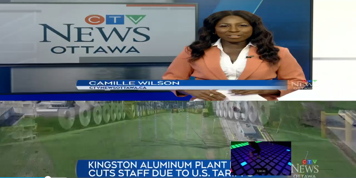

It does indeed seem to be a problem with the 2-bit “picture structure” field. Here is a frame grab from OTA Channel 13.1 (CJOH-DT) in 1080i, where the top and bottom of the interlaced frames are not matched.

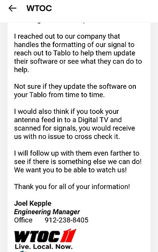

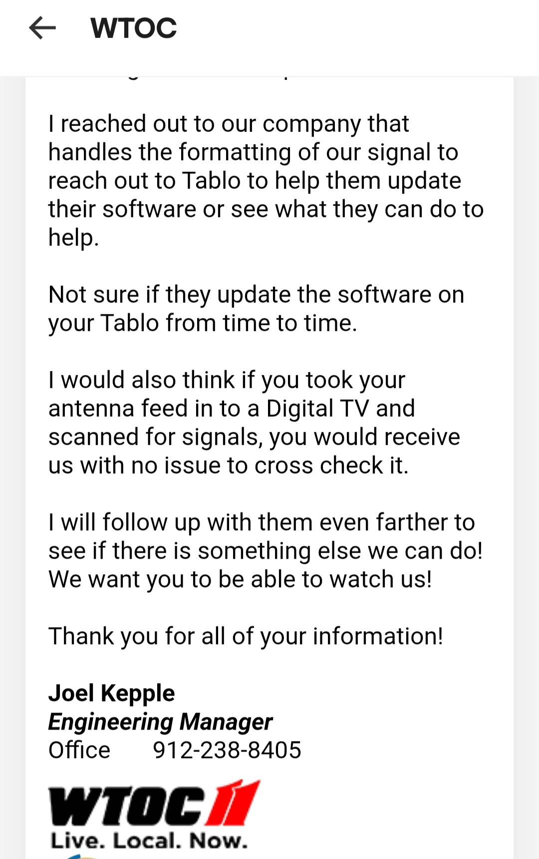

You’re welcome Chuck. Tablo sent me a message detailng the parameter the station engineer needed to change on their end and I passed it along. Tablo never offered to fix it on their end, possibly because it would entail a hardware modification.
The engineer commented that it was an outdated setting that didn’t automatically populate on their end and had to be entered manually. He took care of it, but didn’t have to, which I appreciated.

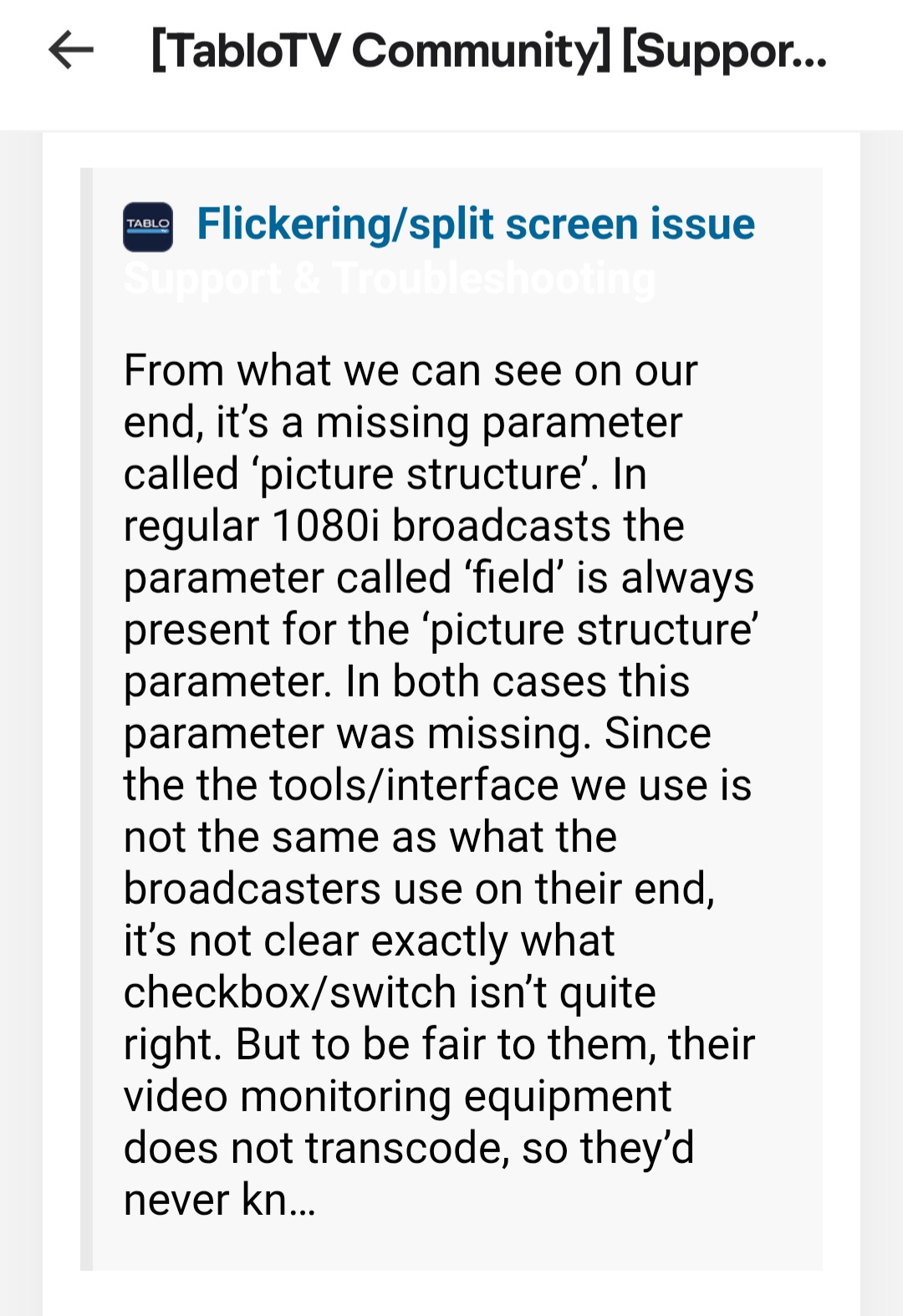

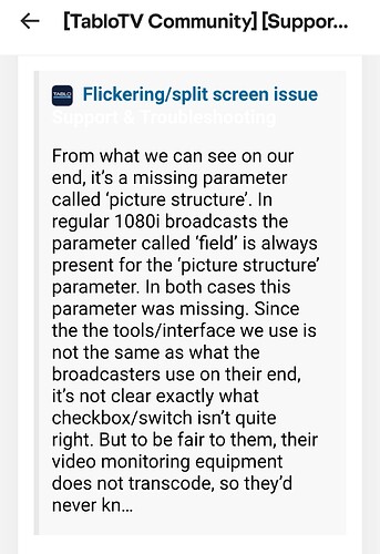

Chuck here (with Tablo in Ottawa), with the issue. Tablo had identified this issue with another broadcaster as follows (courtesy of Kirk): Tablo said…
From my understanding, setting picture_structure to “field”, will transmit an alternating 2-bit pattern in the MPEG-2 picture header for 1080i (interlaced) picture: so it will paint each frame using 01 → 10 → 01 → 10 to identify top/bottom. Tablo seems to be sensitive if this parameter is missing.

For ATSC 1.0 1080i the picture structure field is not optional. It can also have multiple valid setting. I’m not sure I read what the station encoder was setting the field to and whether tablo handles the multiple settings.
