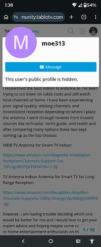

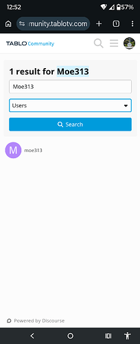

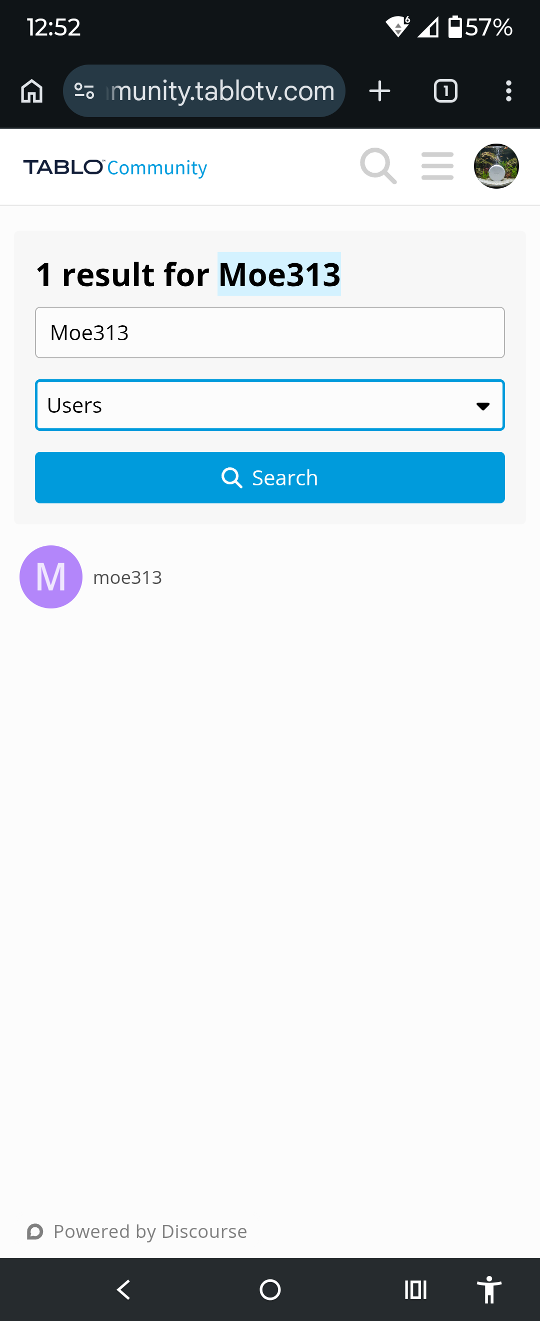

Does anyone else think this is just a way to get free advertisement?
More spam anyone?
please explain, who us trying to get free advertisement?
I don’t understand, where is the spam?
The past several days there have been “generic” posts by new IDs that are hidden.
Tablo moderators have been deleting the threads.
The OP suspiciously looks like click bait. I can’t make up my mind “red” or “blue”.
I’ve been wrong before but… I can always apologize. Only after the OP’s second post.
