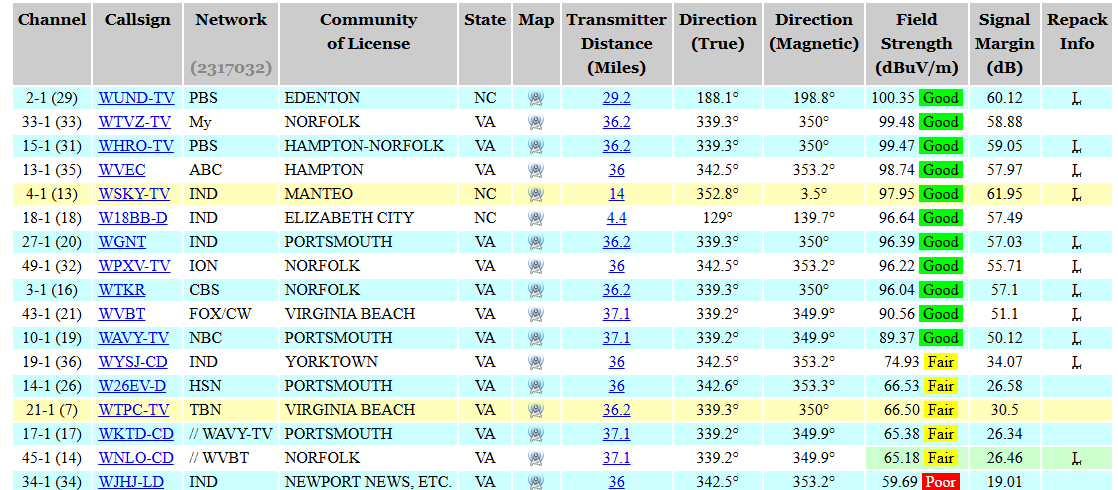

Based on the images you provided, unfortunately, some of the channels with “Good” Field Strength are in different directions so this will cause some issues.

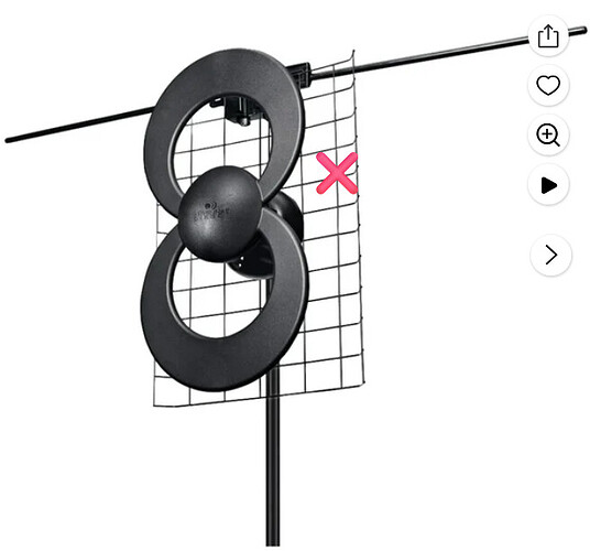

My only suggestion would be to see if you can remove the mesh reflector. This would allow the antenna to receive signals from both sides, but they might not be as strong, either, on the primary side after the mesh is removed. But the signal should be stronger than it would be on the mesh side once the mesh is removed.
If you do this, my recommendation would be to orient the antenna either N to NNW or S to SSE, so that the front and back of the antenna element point toward the two main tower directions.
Of course, this should be based on what channel(s) you want to receive.

I agree with you, @cjcox. I think the easiest and cheapest way forward is to remove the reflector and test it out. He’d then know if a larger antenna or multi-antenna setup would be needed.

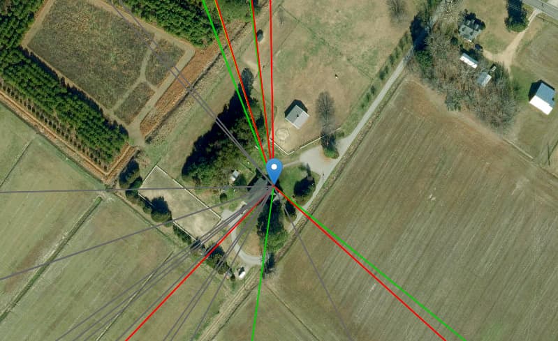

Ya, if the OP only wants the channels that are True ~339º, they’re 36-37 miles away and a stronger antenna would probably work best for them. If they could put it on the out building to the NNE, that’d be ideal to get out from behind those trees. Their existing antenna might work better for them at that location, too.

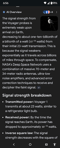

Voyager signals travel billions of miles with less strength than used by TV broadcasters.

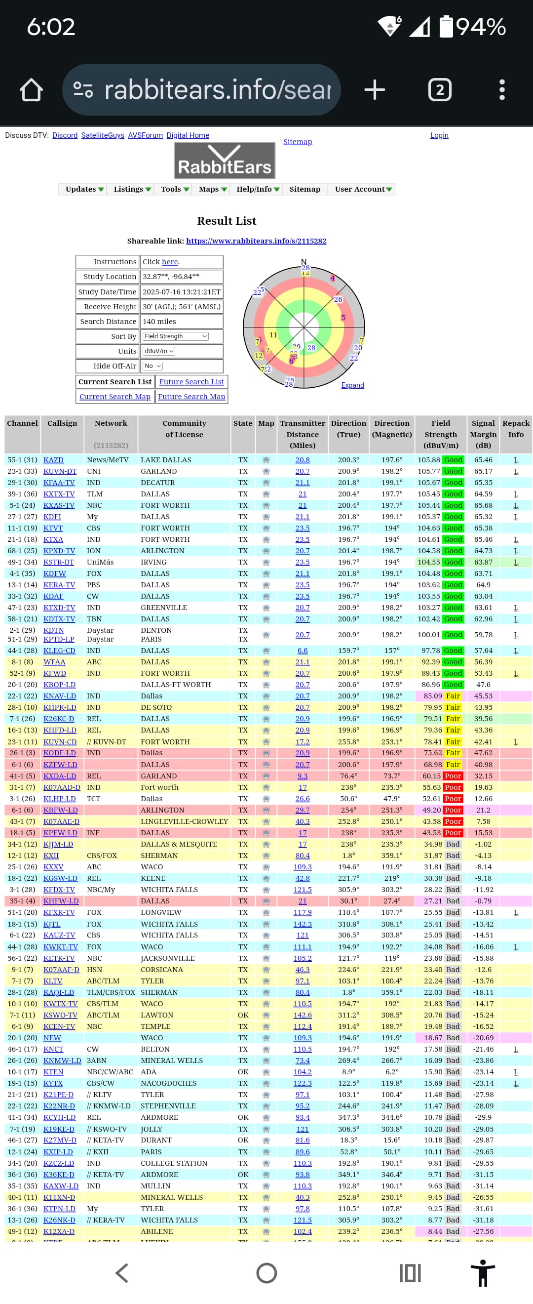

I purposely installed an omnidirectional antenna from Channel Master (cheap no VHF-LO you don’t have any) 30’ AGL. In Dallas we have an antenna farm for most stations transmitters but there are several LPTV stations distributed around.

Also bag the idea of removing the reflector. It will do more harm than good!
