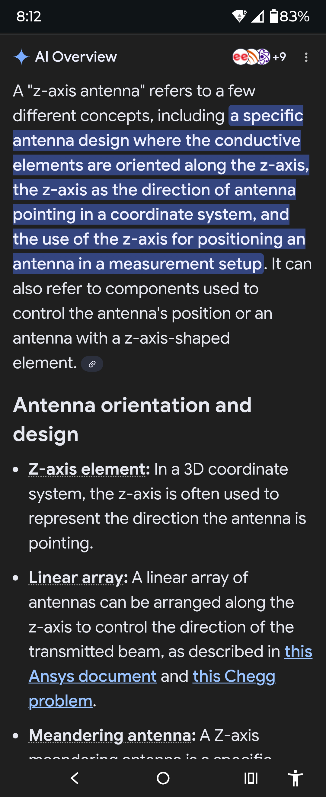

Check your ‘Z Axis’. People adjust ‘up and down x / left and right y’. Joking but not joking :smiley:.

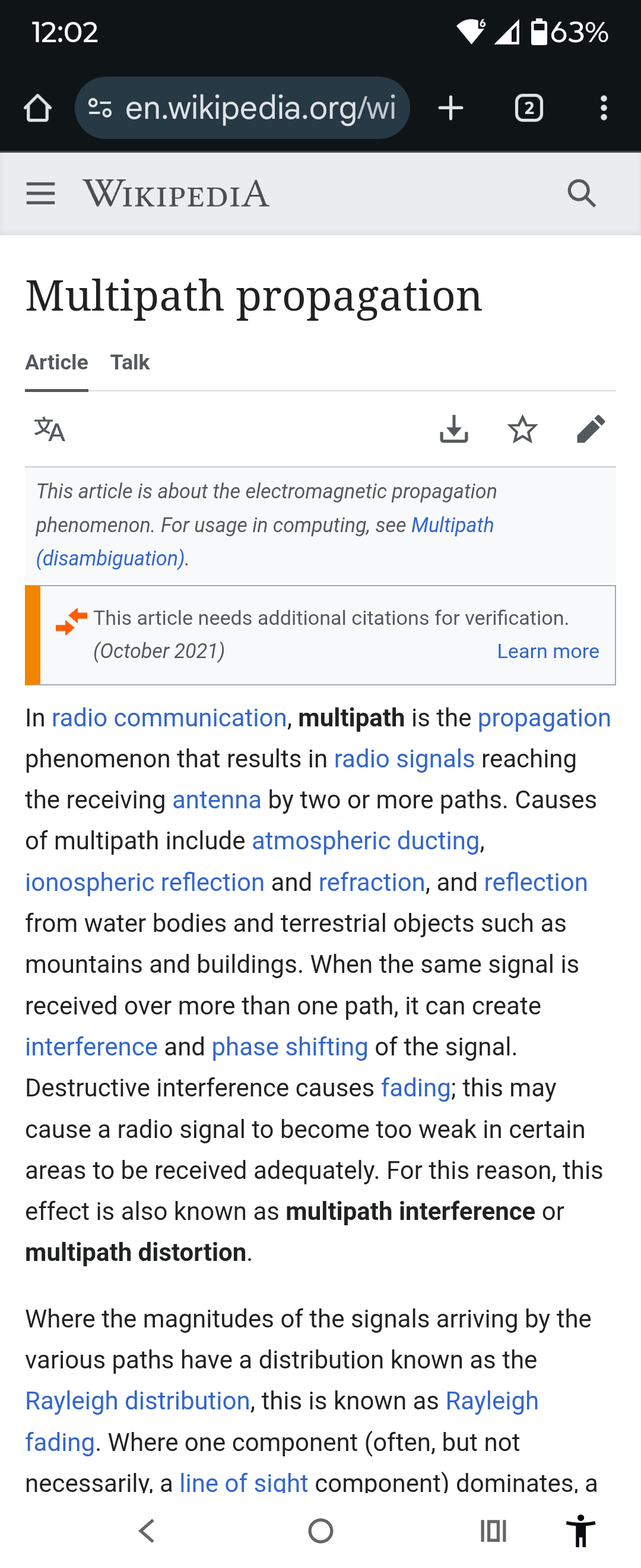

Then Multi-Path it is… Not as exciting as the collapse of the Van Allen Belt, however.

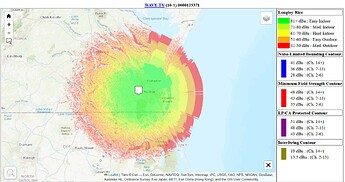

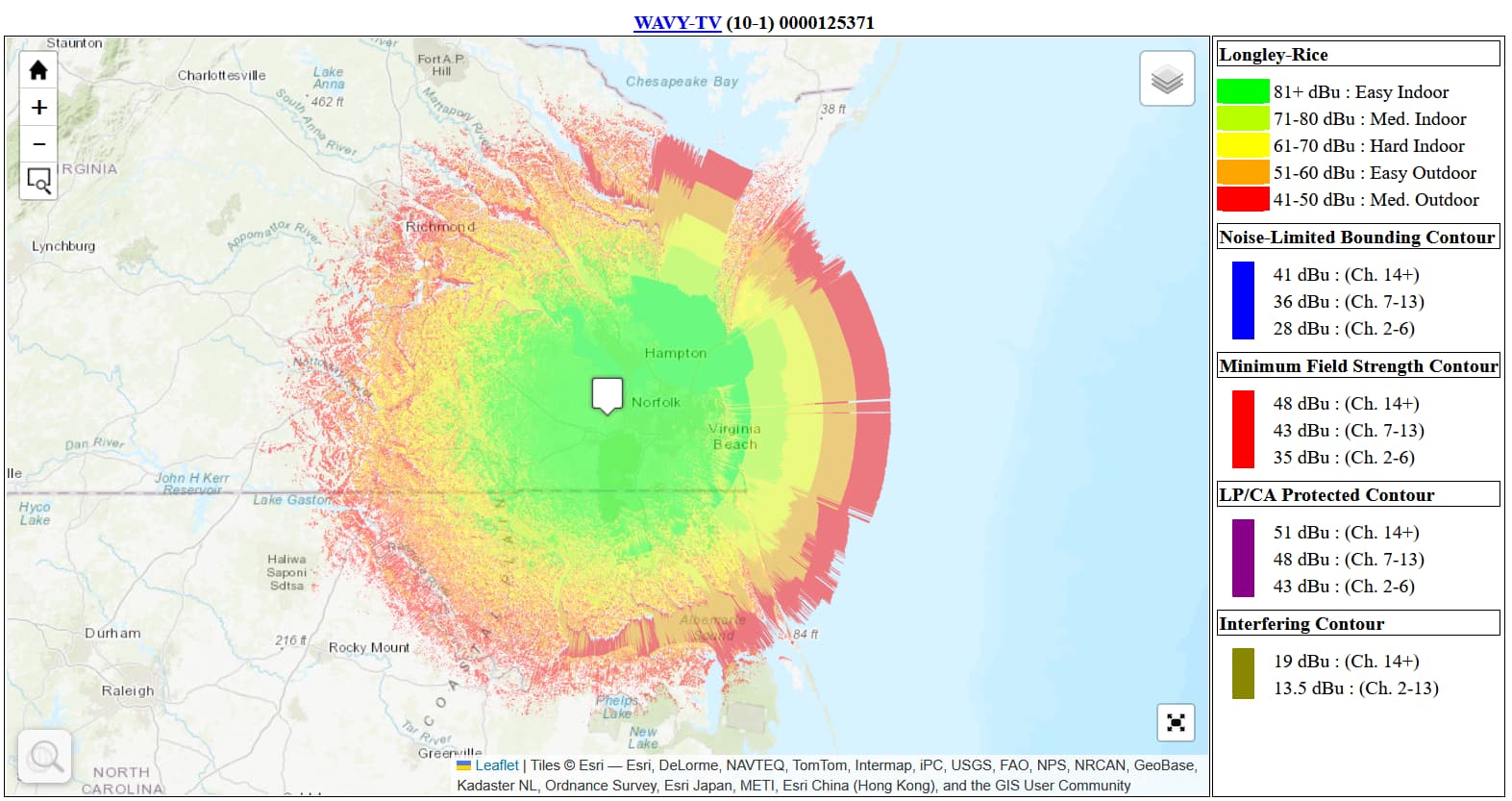

I’ve been looking at the ABC and NBC channels for this area on RabbitEars.info and I notice that these antennae aren’t quite as tall (920’ to 1,194’) as those around my area (+1,600’). This probably has a negative impact on the distance that their reception contour reaches.
This is the NBC affiliate antenna at 920’ AGL.
At 1 megawatt and 37 miles from the transmitter?
That’s a 60 mile contour.
He would have to be in a valley.

This is a Rabbitears.info screenshot that he posted.
Okay thanks my mistake. That being said I can say with utmost confidence that while a decent report Rabbit Ears is also fraught with issues and should not be taken as the perfect guide to your particular reception location. For me it is also not accurate! I would say more like 80% . Useful as a guide.

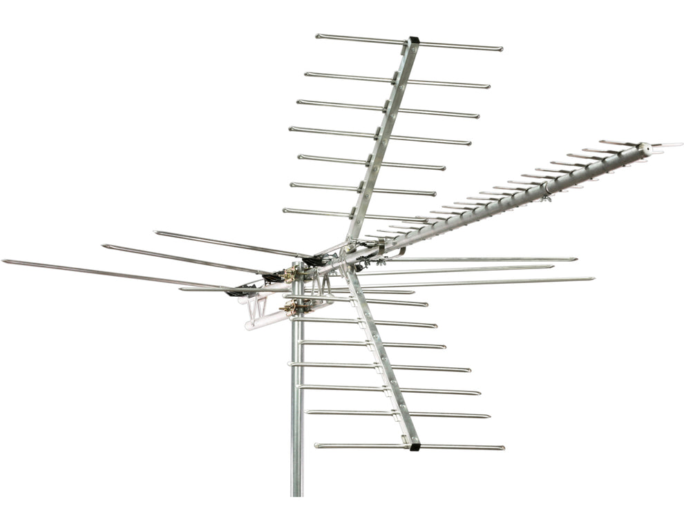

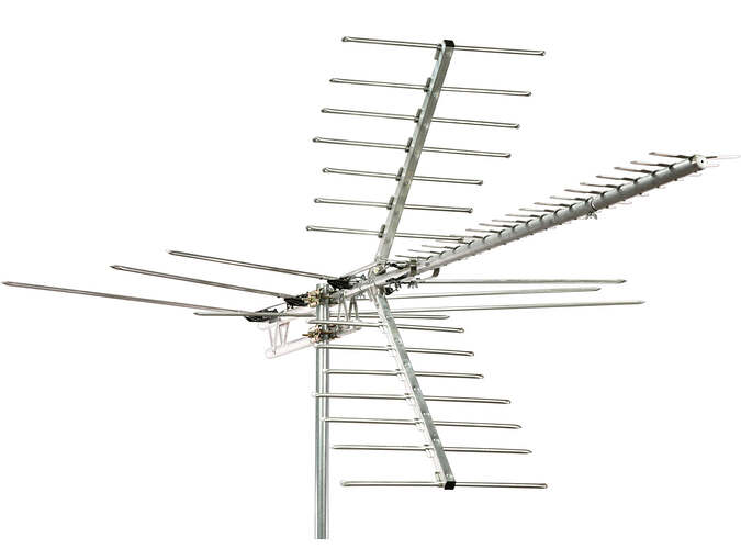

But your antenna is really too small for your needs.
I’m old fashioned and like the stupid ugly antennas that works forward and can pick up signals on the back side also.
Shop wherever you like but longer elements on the antenna perform better. Almost none support VHF-LO (RF2-RF6) but nearly all will pickup VHF-HI (RF7-RF13)… The rest is UHF.
